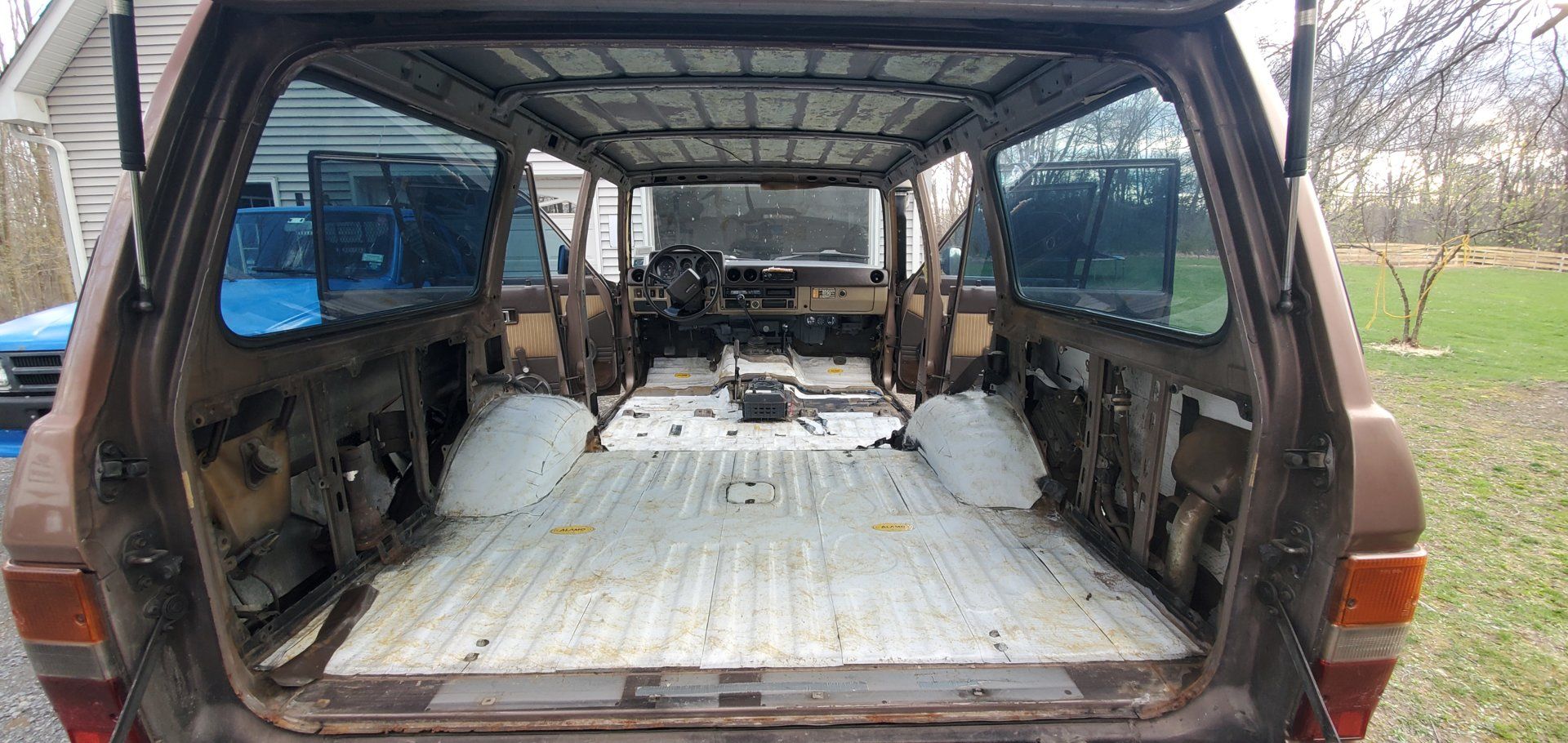

Quick update, since mice had nested above the headliner and made the passenger rear corner their latrine during the last year and a half while the truck sat, I decided to tear the interior and to remove the headliner, and then while at it, perhaps fix rhe rust holes I will be encountering. Made a bit of progress.
What you see on the floor is what I found. It is some sort of sound deadener. Of course, the infamous hole in the wheel well on the left will need fixing. I have my spare truck for that, hopefully I can use the seat back hinges together with the sheet metal from that.
I am not going to replace the headliner but rather apply dynmat or quiet crap, and leave it at that. I may take a different approach ala the fj40's, where I may apply some sort of vinyl or leather directly over the sound deadener. Will see what I decide later on.
I will also strip the gutters and repair, reseal and repaint them.
I am also not sure if I should remobe the existing sound deadening to look for rust, or leave it in place. It is very difficult to remove.
I know I am thinking to remove it and just to lay down the foamy stuff.

And continuing the saga...
The mouse piss was so nasty in the corner, that I almost barfed!
The headliner was in horrid shape! I have employed the use of a grinder with a wire brush which did a good job of cleaning up the remaining jute still stuck to the roof.
