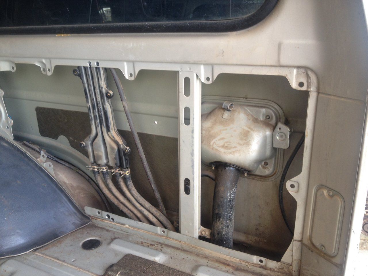

Of course there is some surface rust on the top side which I will address as I make progress. I do wonder, and I have asked the question before, do I really need the breather octupus that is attached in th passenger quarter panel? I have a broken pipe and the bracket is pretty mangled. Also, the low hanging tube outside of the lower quarter seems to go all the way to the driver’s side and loop back and then the end is simply inserted in the body crossmember, just like that.

And here is the mangled octupus.
I do have a spare but not sure of its condition untill I take it out of here.
Looks like my answer is here...

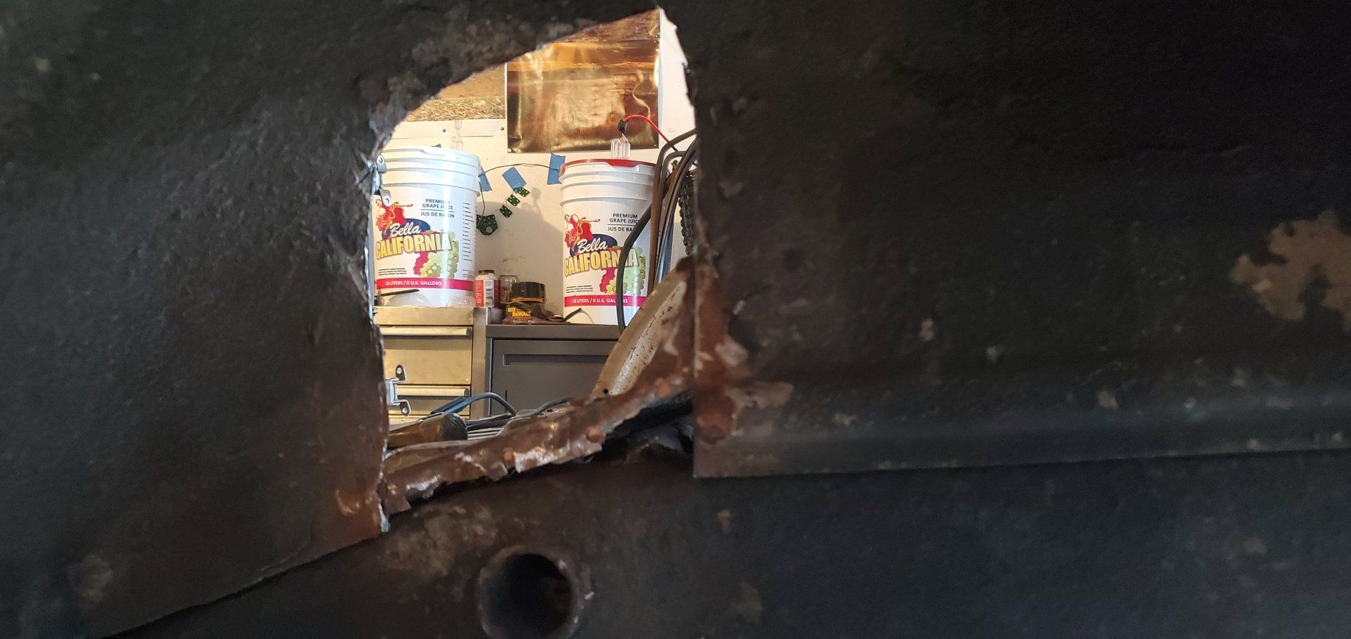

And then delved into some of the body surgery. I cut up the driver's side quarter. Wanted to get an idea of what is under there.
It's messy, is what it is! But like a budy of mine says: "It's just metal, it can be fixed"...so I am going in head high.
