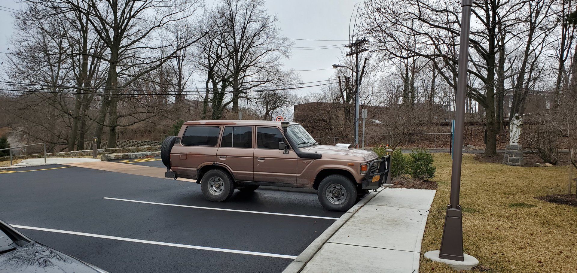

Here is a pic from today!

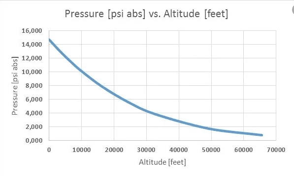

There are two ways to look at turbocharging. In the lets make gobs of power view its all about max boost without blowing up or melting things. But in a more practical/industrial sense its about maintaining sea level performance regardless of your altitude. So at sea level the air pressure is about 14.7 lbs/in^2 and it drops as you gain altitude.
(commas on y axis like USA decimal point)
So we can see that at 10,000 feet air pressure has dropped to near 10 psi. So with only 7 psi you should still be making sea level +2 psi at 10,000 feet.
View attachment 2203136 (commas on y axis like USA decimal point)
