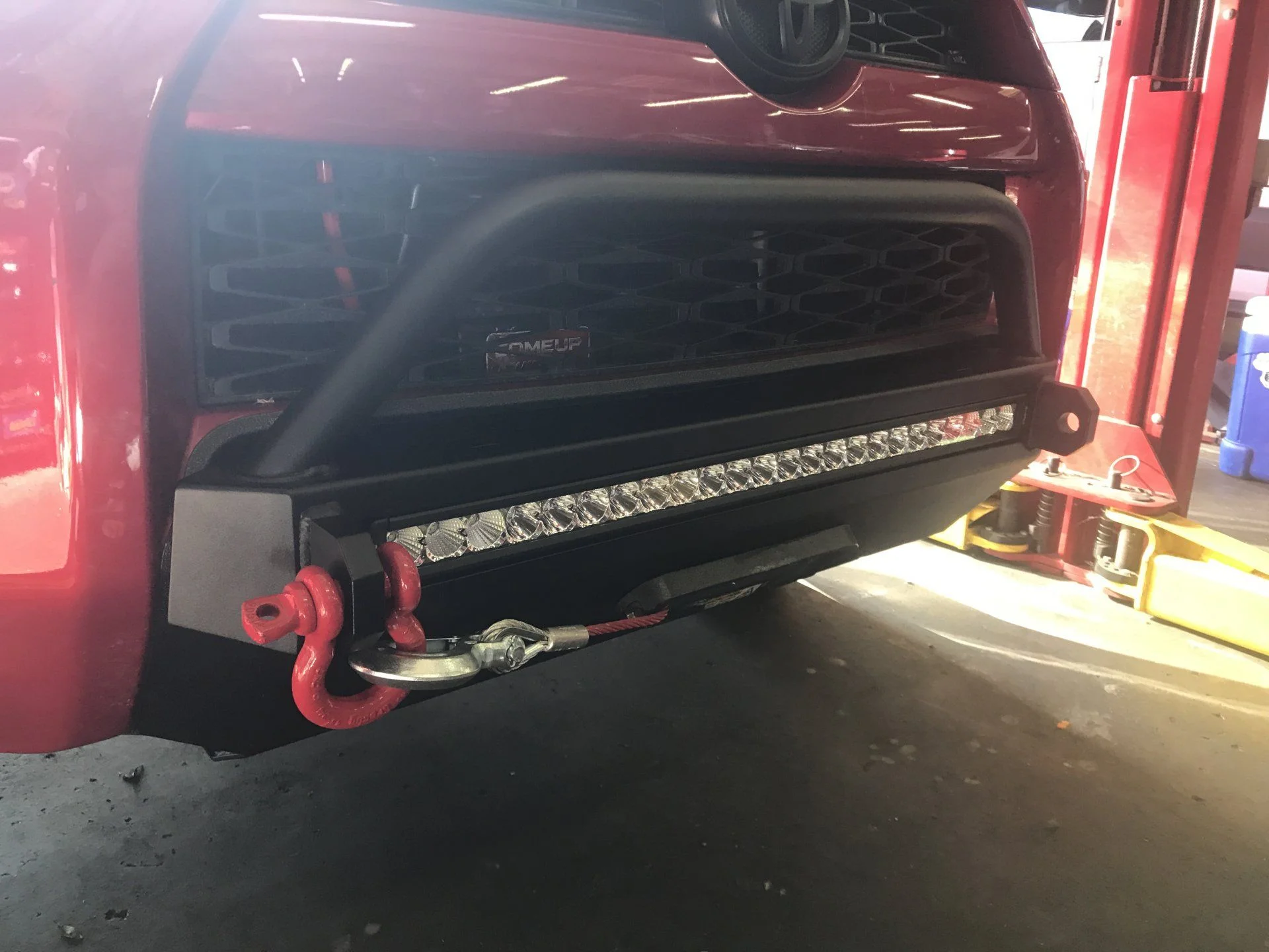

This looks like the best place for this. 49 Tire (I'd say @wct49 , but we know it was really @offr0adlim0 ) installed the SSO bumper yesterday for me. Got a Come UP DV-9 winch from @wct49 as well. Looks clean installed, they did a great job.

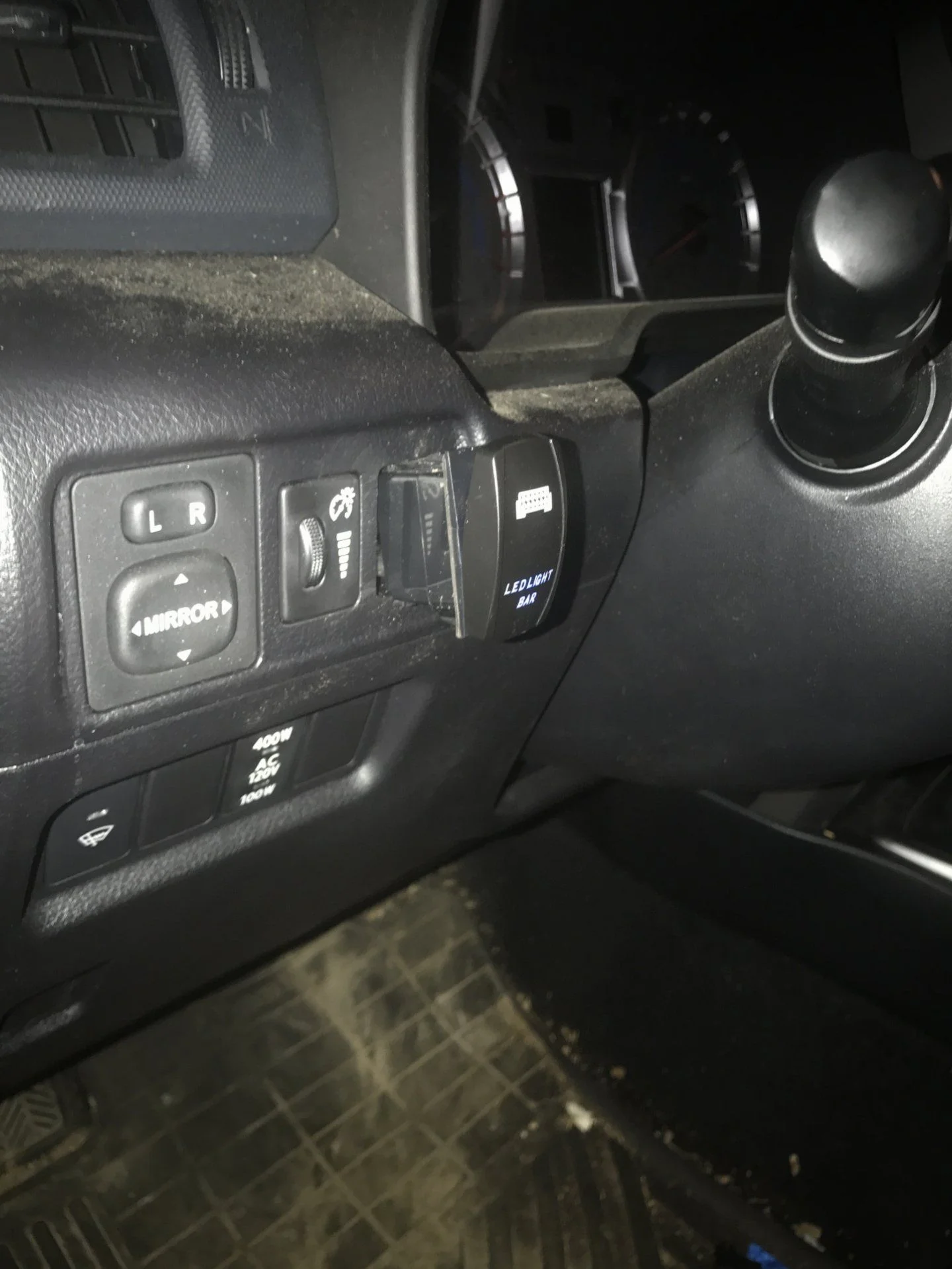

Light bar is the 30" Heiss, I got that from SSO with the bumper. No where did it say that some trimming would be required for the "premium" rocker switch. Debating whether to find one that will fit (the ones i can find are only 3 amp switches and that Rocker is a 20 amp) or getting @offr0adlim0 drunk at the next meeting and letting him cut up my dash. Or maybe getting drunk myself and doing it....

@chimay you using a relay in the light bar circuit? If so the 3A switch will be fine, if not, might check it out. Seem to be better for high amp draw components. Is that switch blank smaller than the older Toyota ones? I thought those rocker switches were direct fit in Toyota blanks.
Regardless, bumper looks great.
