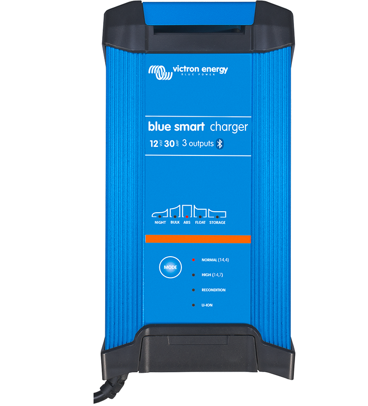

Powered with a Victron 30amp charger connected to the inverter socket. This charges the Renogy 100ah battery in the back with a Victron Smart Shunt to monitor power.

What Victron 30 amp charger unit are you using exactly? Is it the Blue Smart IP22 ?
