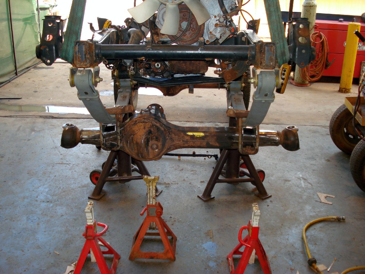

Then after all that and working with a perfect 45deg shackle angle i decided to flex the springs up a bit to see what id get.
Instantly the front and rear shackles rolled back and hit the chassis and got stuck there....
Whats the deal? are my shackle angles all wrong or are standard shackles no good working at 45deg?

here are the pix i promised...
Those top ubolt plates are crapola old ones ill change them later...
i hate that shackle angle LOL!
Yeah those springs are too long I guess, you can correct that with longer shackles though. Had those issues with my truck after a year of hard wheeling, and would stick the odd time while driving, had to jack it up and go. Yours looks a lot worse, since the body isn't even on. I added an extra leaf to mine to fix it, but you could add longer shackles, or reweld the frame shackle mount further back.

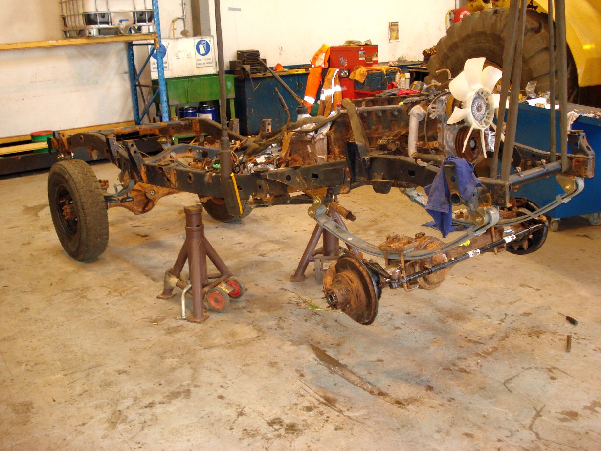

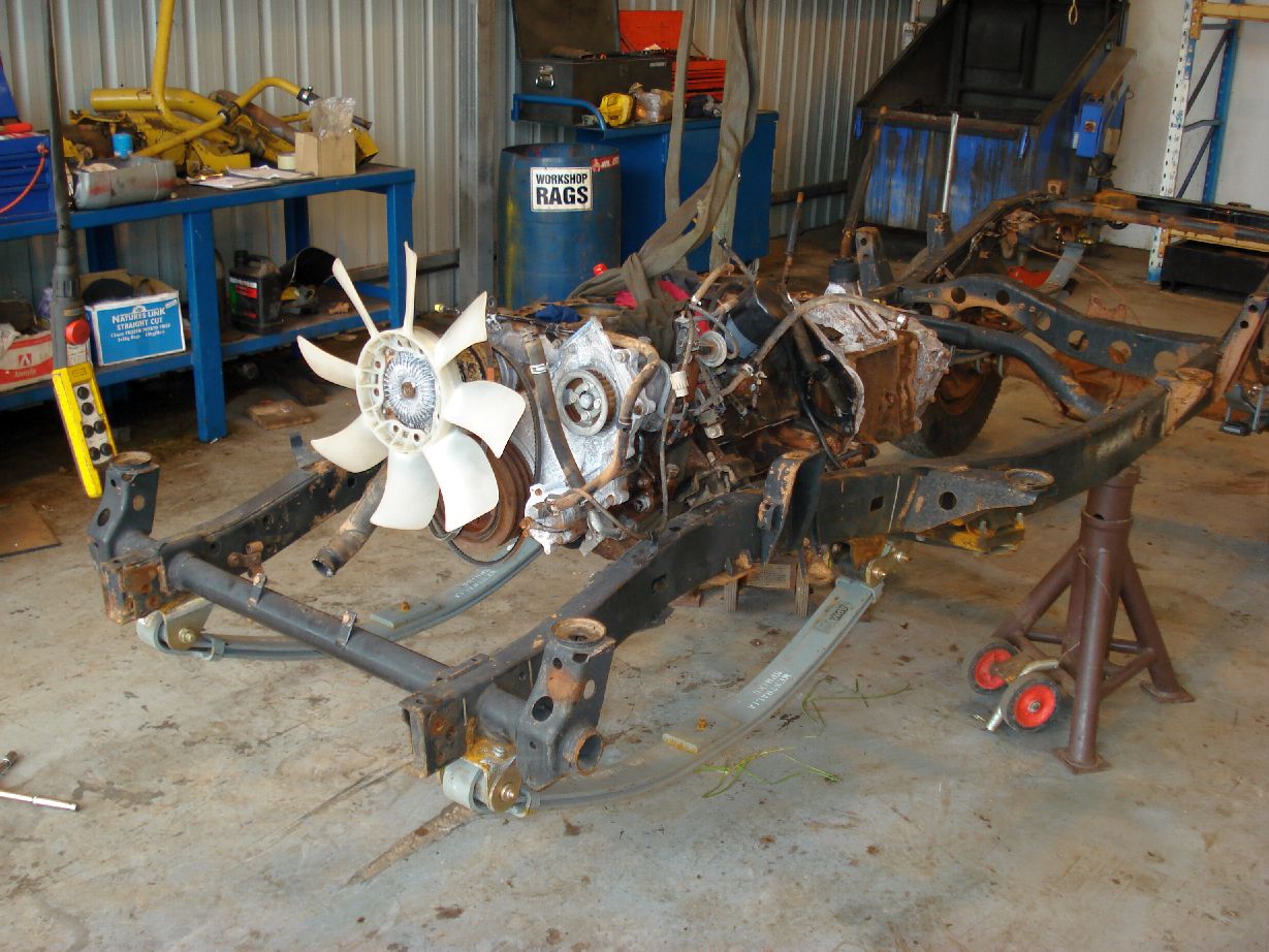

Hi guys heres a little update, i didnt get much done as i was helping a mate sort his car out (he bent his front diff).
Anyway i managed to get the old block and gearbox/transfer siting in for the output flange angles.
I was running out of time so i did a quick bodjy job and put the front diff in SOA just so it can be wheeled around easier now that the engine is in.
Hehe a super quick 10 min front SOA comprising of only 2 holes hahaaha (remember its super temporary!)

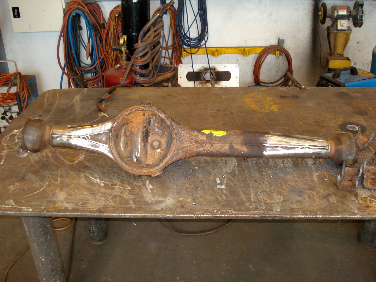

Ive just completed the hardest part of a spring over for a 75 series.
That bloody square banjo housing... it almost broke me, but i won in the end
Getting everything absolutely perfect to the mm and deg so i dont crab down the road.
not easy...
Are you happy with that shackle angle? Looks like it should be more vertical to me and when you load some weight on it ,it will be worse.
