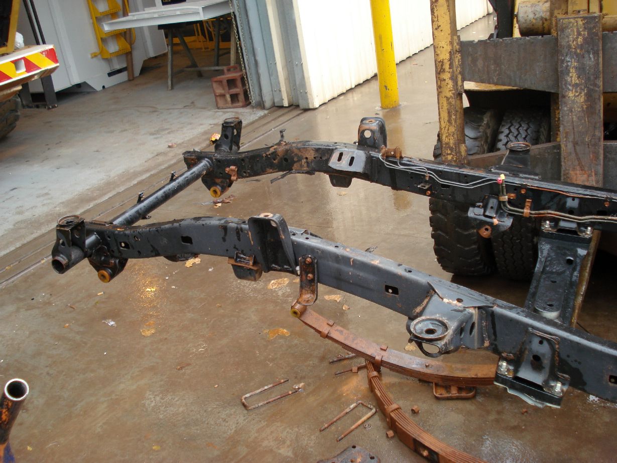

Finally i start constructing, instead of deconstructing!
There are a few ways of getting around the front drive shaft hitting cross member problem on a 75 series, all of which i think are dodgy, as cutting out the interfering part of the cross member takes all the strength out of the cold rolled 2 layer cross members...
So i think, how to fix this?
I come up with an idea that will work for me in a few ways,
  • Clearing the drive shaft
  • anchor point for bash plate below transfer case
  • strong
  • no way it can catch and rip the cross member off like other designs
By meens of 2x Custom 1" spacers and a modified transmission mounting point this is what i have
Fully welded with 3 run fillets and final HOT run over the top, inside and out.

The fitting of the modified cross member, spacers and the upgrading of the bolts.
Removing old 8mm metric nuts with a cold chisel and a gimpy
New for old
The end product
Stay tuned

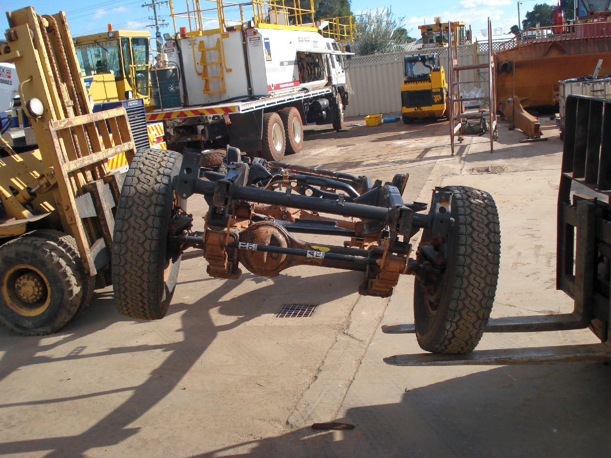

i played around a bit this morning, testing the static flex on a SUA no load...
its laughable!
Come'on Zoltan this is 75 series cruisers we are talking here. Don't think Mr Toyota has the word"flex" in his dictionary.
Ive been in one for few years, I have never seen one flex. I guess they might if overloaded but in normal operating conditions they are just fine. I guess you had to test your new brace, but looks every bit as good as the original to me.

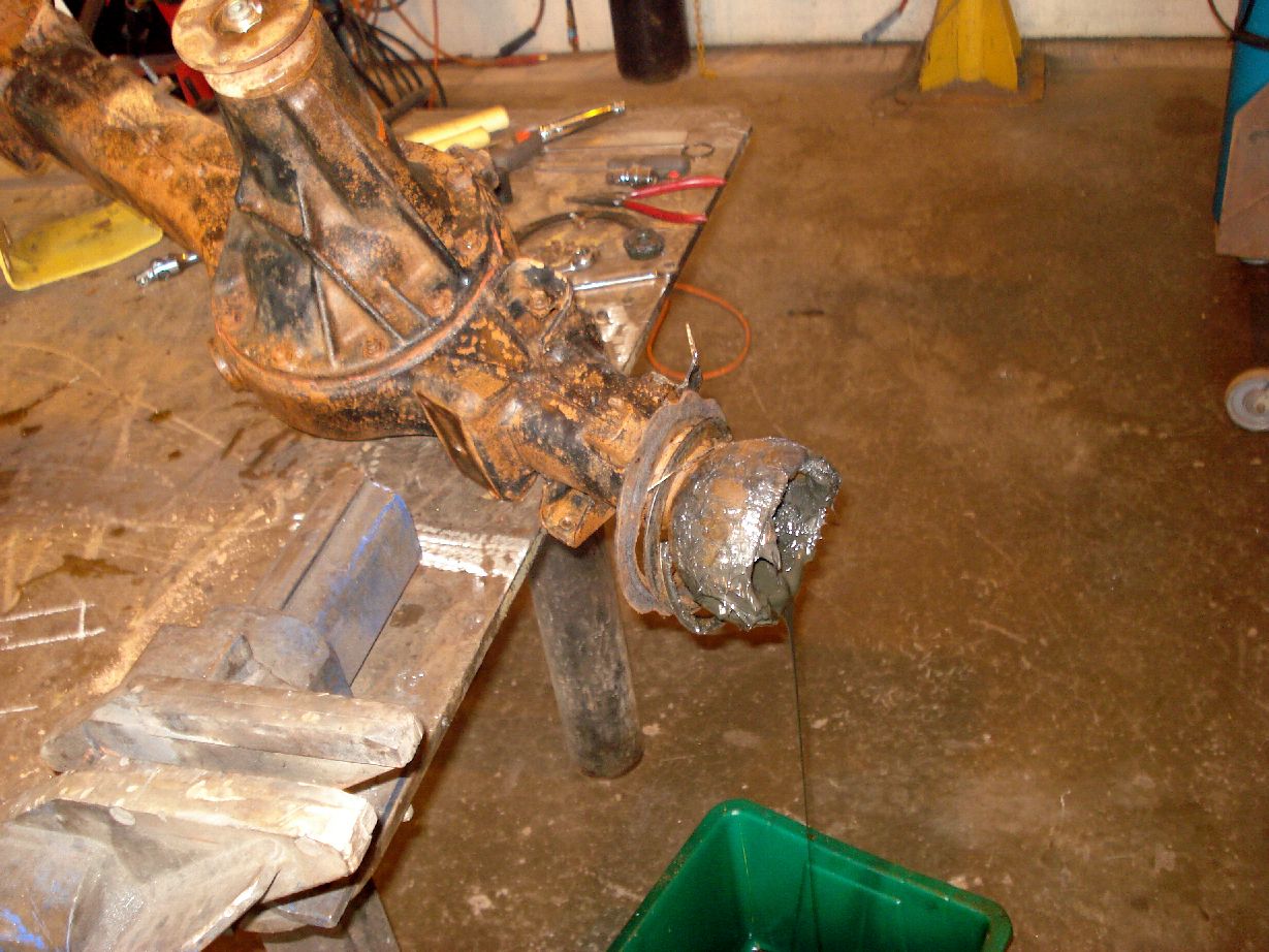

  • Took front diff off
  • Stripped and made ready for cut and rotate, new perches
  • Cleaned and inspected CVs to find them fairly rooted
  • Center is near new
  • Ready for full rebuild and swivel upgrades
