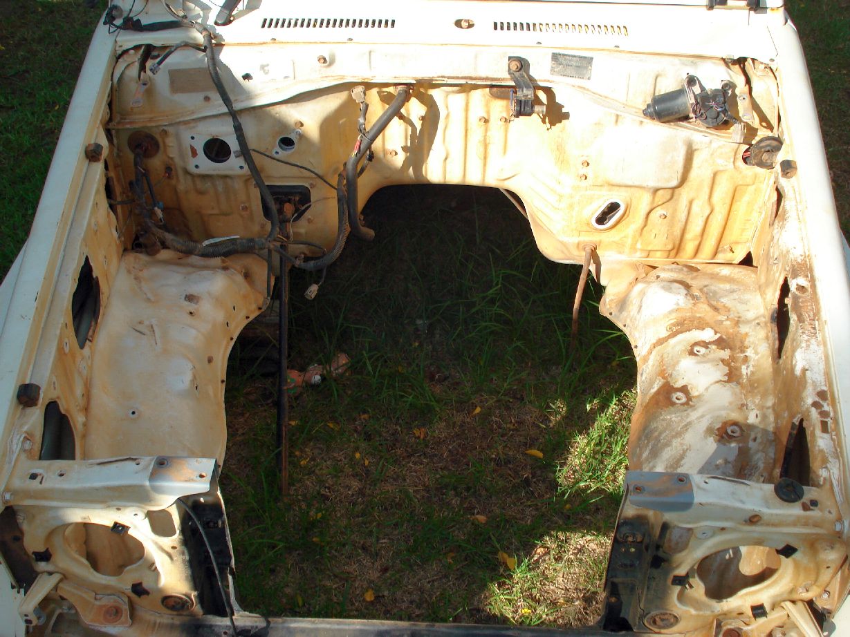

Hello all, its been a while and ive achieved very little but this is what ive done...
Stripped engine bay ready for paint

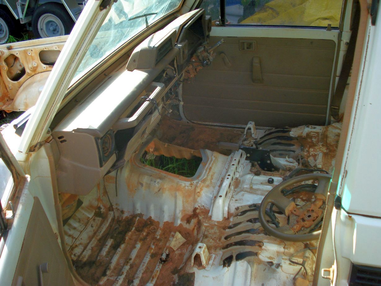

Heres all the junk out of it and the tray
What it looked like inside b4 i started work

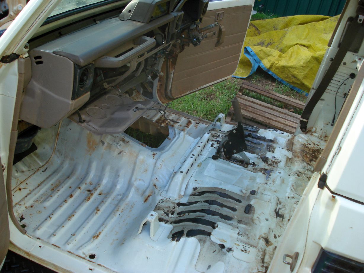

And now

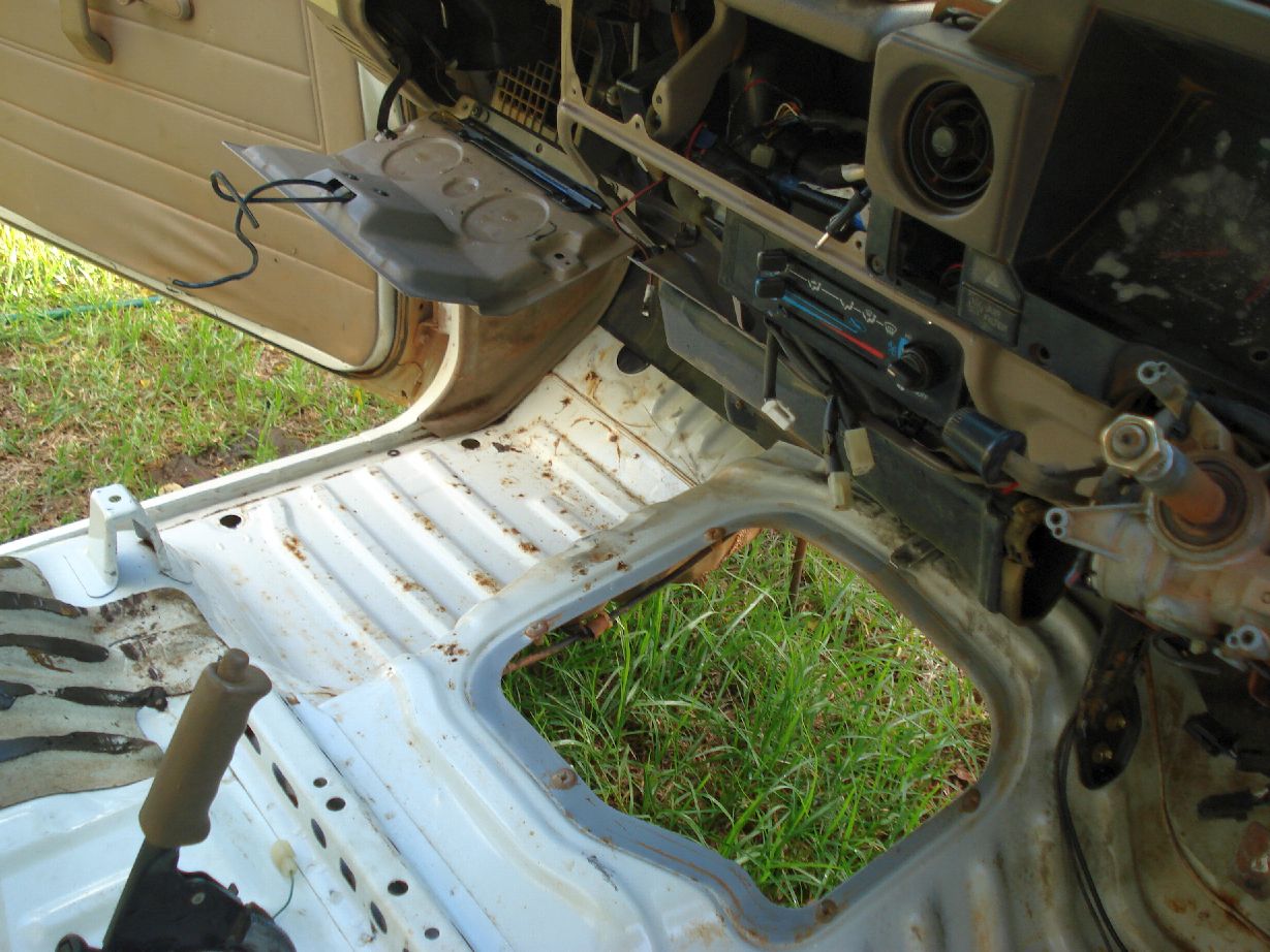

Cleaned the dash out too
You've got some work head of you there.
Winters here ,I hope you have somewhere warm and dry to work:D

Just looking at some of your earlier pics, you've done a fait bit already when you look at it. Just noticed the last pic, with the heater controls. Its the same aircon controls as my new truck. 1st 70 series trucks sold with aircon standard here in NZ, bout time.!!. Ive had some hot dusty trips in my old 91 75.

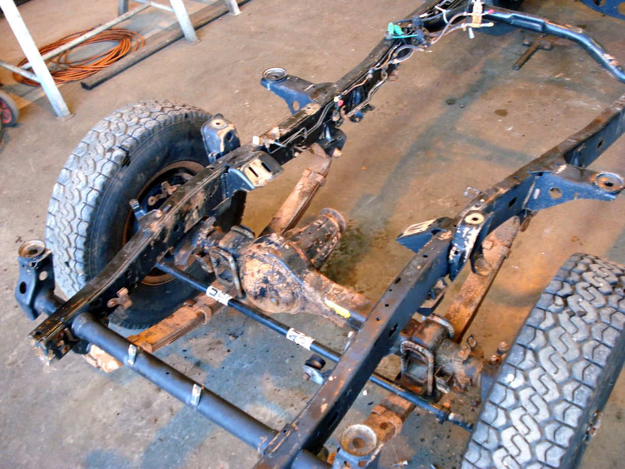

Update:
Got a bit done to the chassis, well i got it to the stage where i can now perform the spring over and drive line lowering exercises..
  • I cut the chassis down to the desired length, just behind last cross member, soon to be replaced by a custom Reece type receiver as ive built before on smash's patrol.
  • Removed rear fuel tank for repositioning later.
  • Removed all unnecessary bracketing such as exhaust mounts and crap thats never used, to make room for new mods.
  • Removed shockies to find that 3 were seized on the stroke
  • Removed all brake lines/breathers and all steering on diffs ready for SOA
  • Got engine mounts ready for being cut off and lowered
  • Took tranni cross member off for modding
  • Rebuilt new springs and flipped centre pin for the SOA position.
Pix follow
