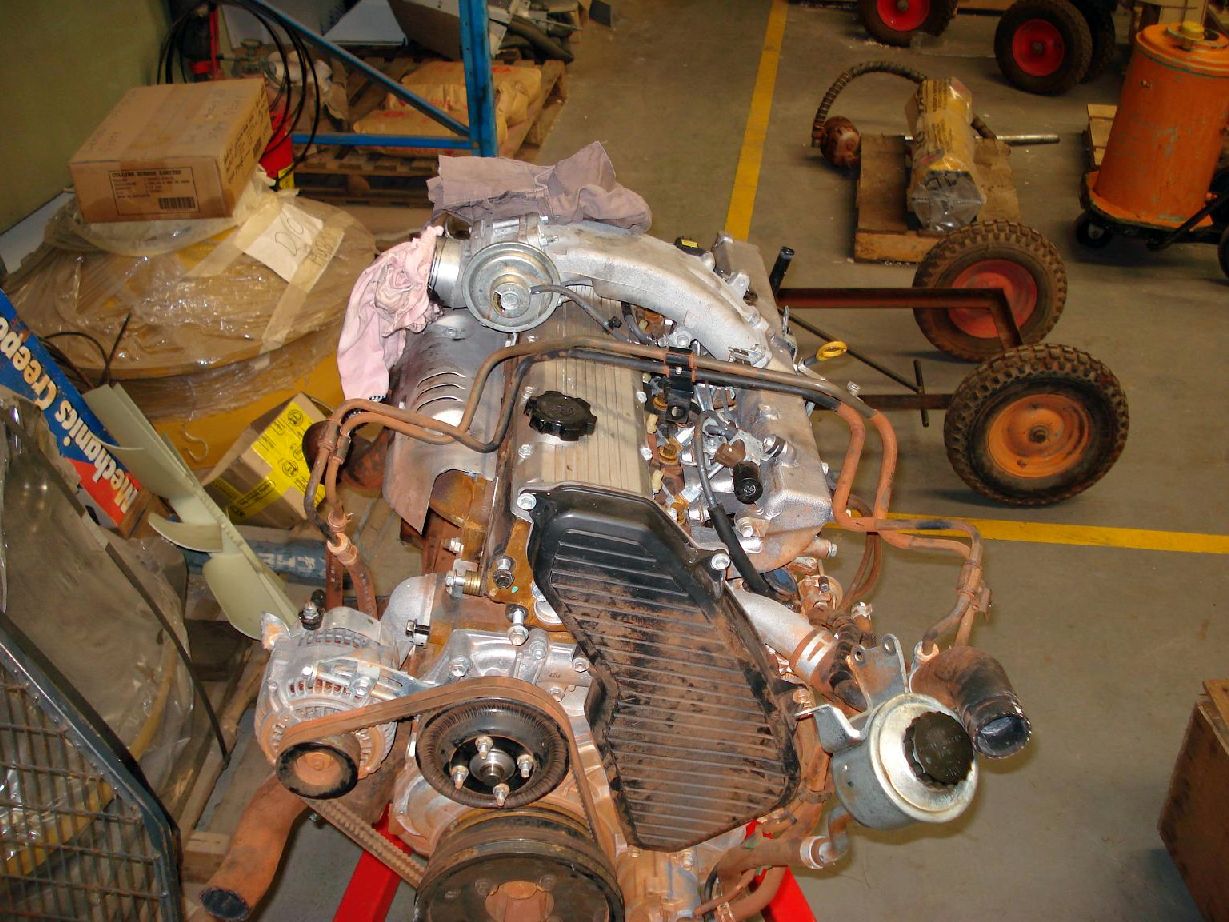

Its been a a month or so, and ive done a few things.
I got the engine, straight bolt in little wiring needed
06 model 1HZ with 5k kms on the clock

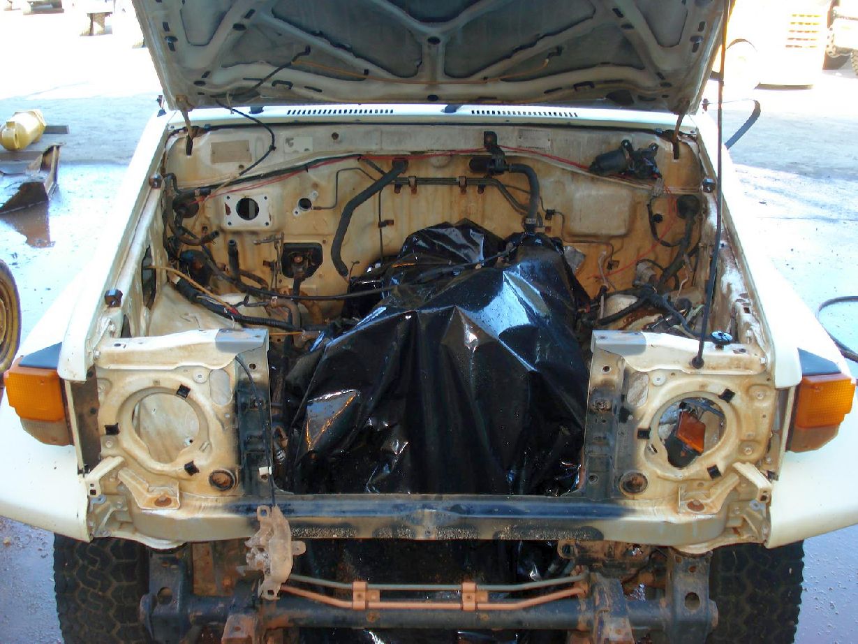

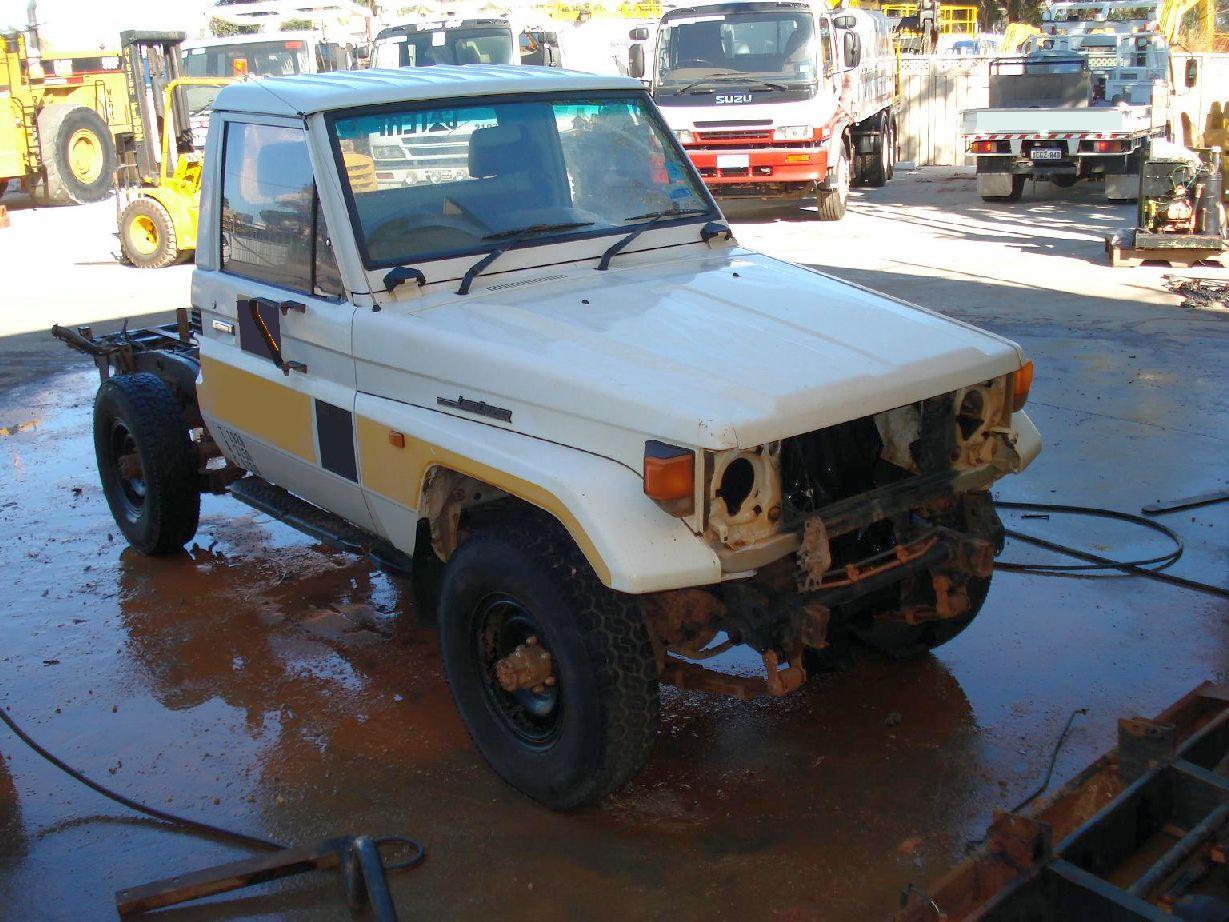

Started to strip and clean the machine, ive taken the tray off for access to cleaning and modding the chassis, the body will come off also
Got the 95 model cruser up and running, perfect and some cheapie tires to make it look the part

The denso module ( black one with the blue letters ) looks like my 1HD-T with A442 have over the Injection pump ..
I love a HZJ75 and 1HZ build up thread:D That body and chassis is looking extremely rust free and is a great start.

what do you meen by that? they use the same injector pumps dont they?
NAH and the 1hd ft and 1hd fte are different again.
naaaahhh just making apointment to the denso module .. I was thinking it only comes with Auto trannys ..
