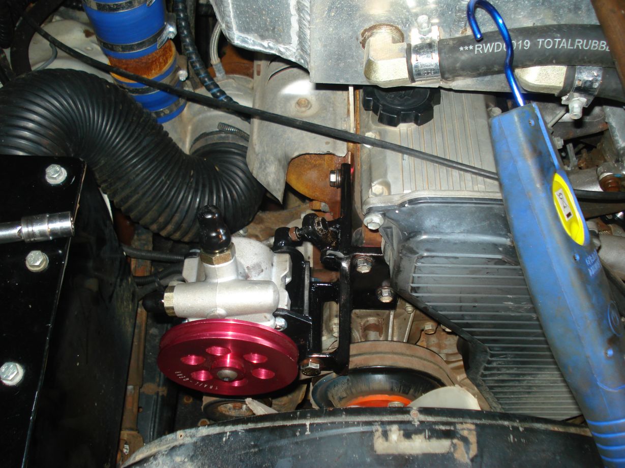

Power steer pump bracket made and pump mounted.

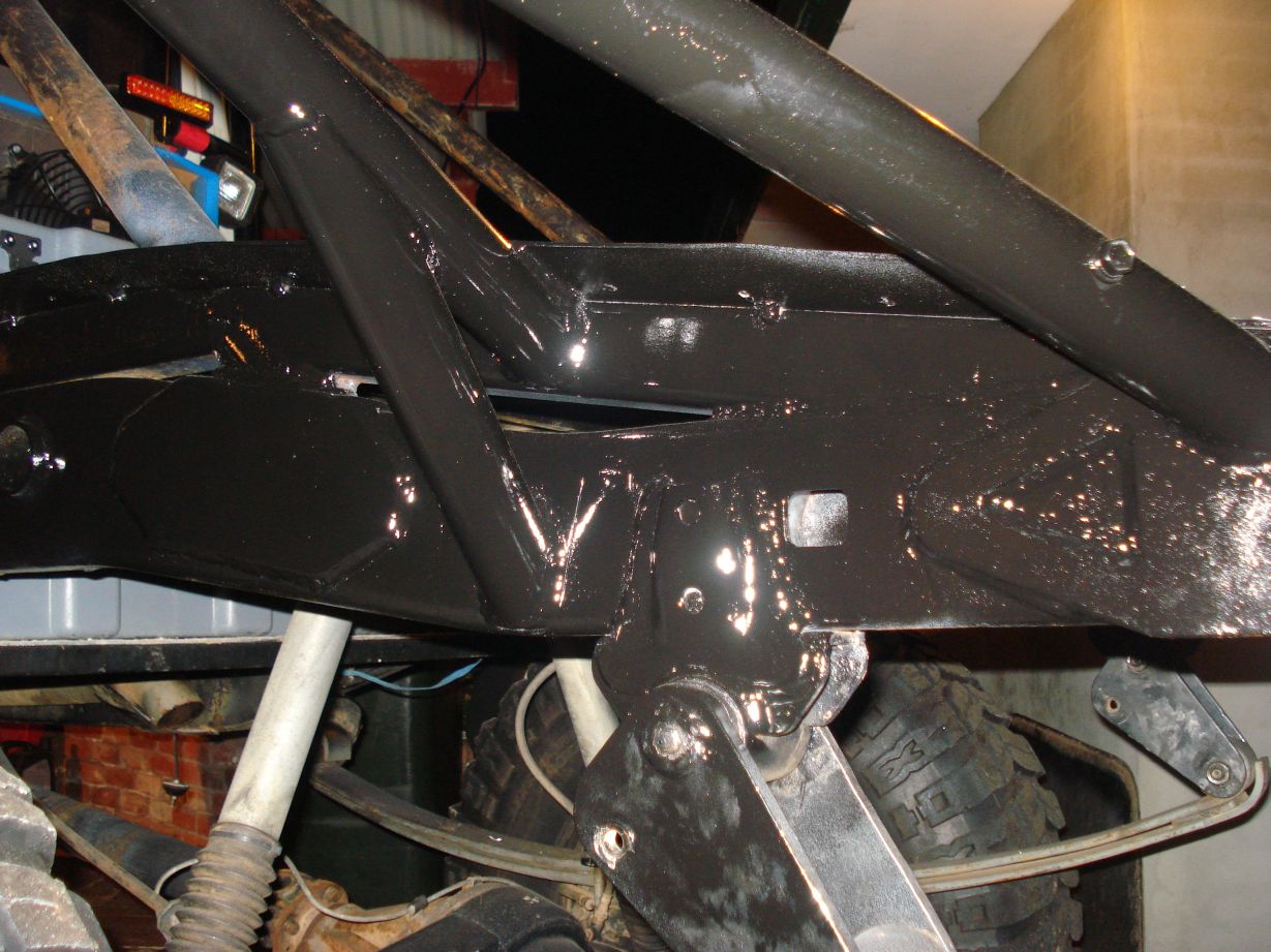

Straightened and strengthened the tray rails and moved my shackle hangers back.
Here u can see my improved shackle angle

Pulled the standard power steer pump out had a look at it, its fried... the sides of the vein rotor are all scored and the inside of the cam ring isnt in good shape either. Bad news for a near new pump. Then i made a blanking flange for it. 10mm plate and some 515 sealant.

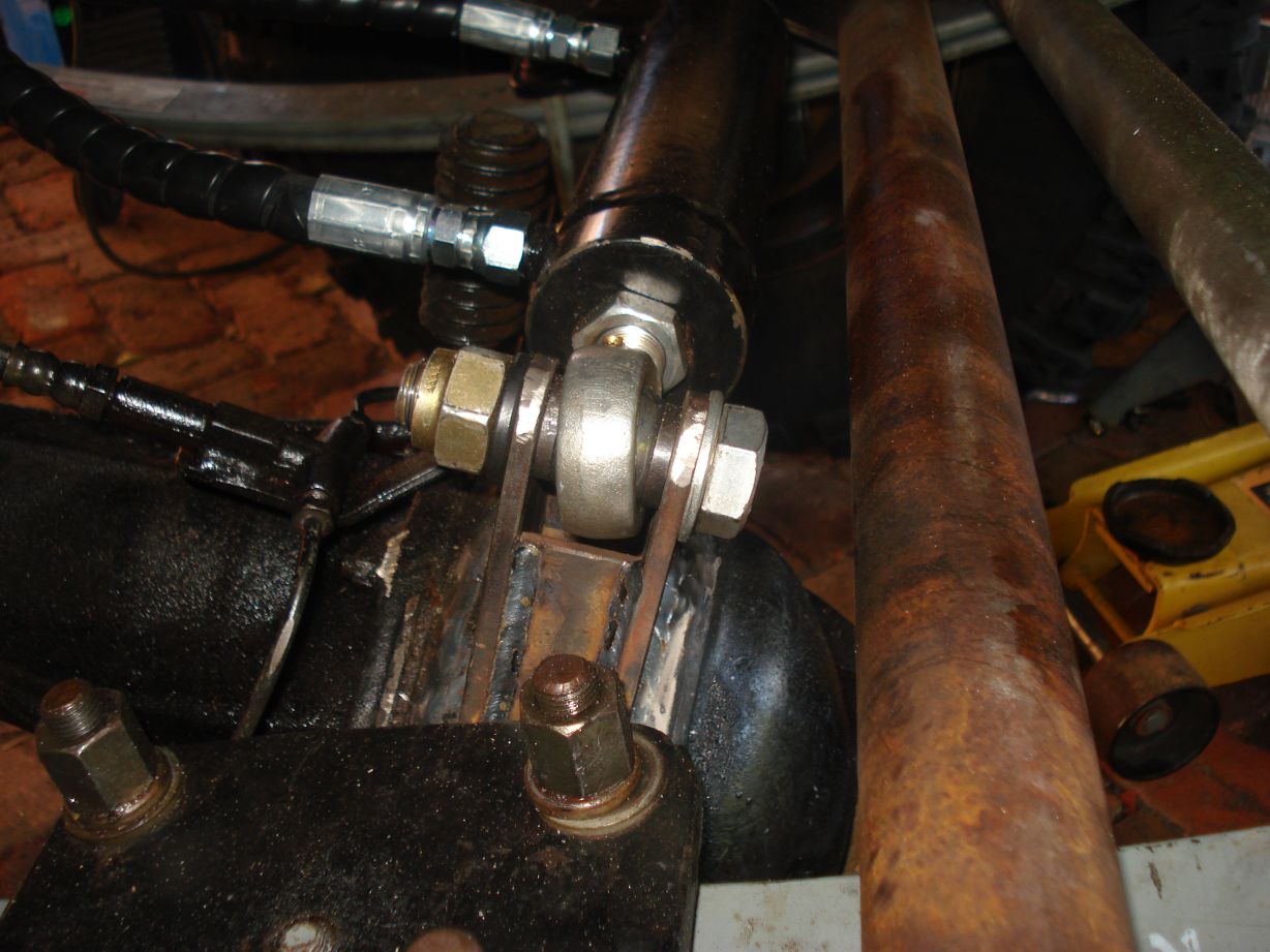

Quick update on the Hydro assist
I used 1/4Bsp to -6Jic nipples in the steering box. Alot of people use 1/8th and tap into the veins, don't know why they would be a big flow restriction in comparison.
I ran the lines to a bulkhead behind the shocks then to the ram.
I had to have to ram so high above the diff because of the ubolts.
