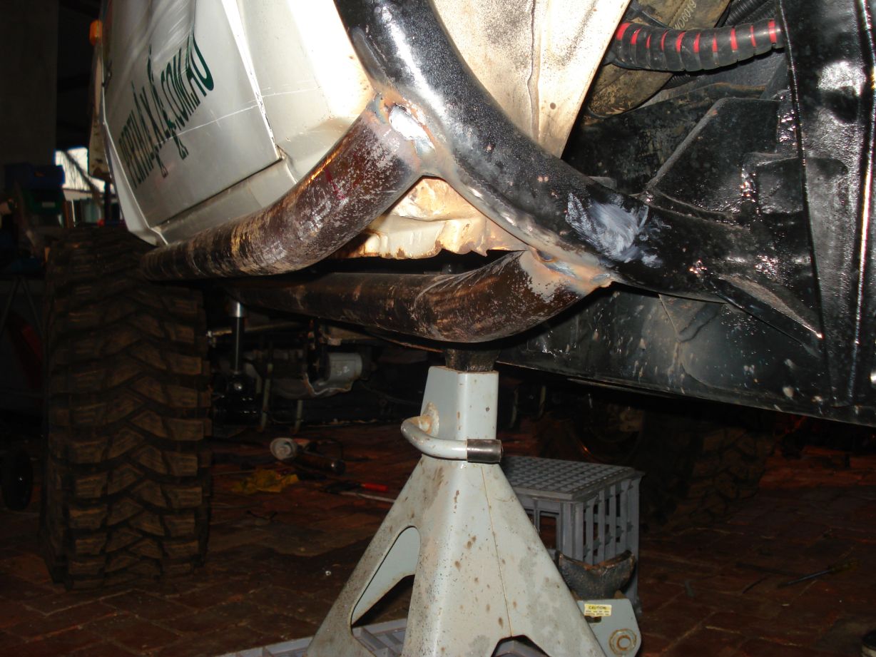

Done a lil bit on the ute today, cut the guards and started making the sliders.
Took about 5" out of the rear of the guard for tyre clearance and to sneak the front mount of the sliders around it to the chassis.
Ive still got to put a few bars between them and to the rail. Then sheet it back to the rail with 3mm plate.

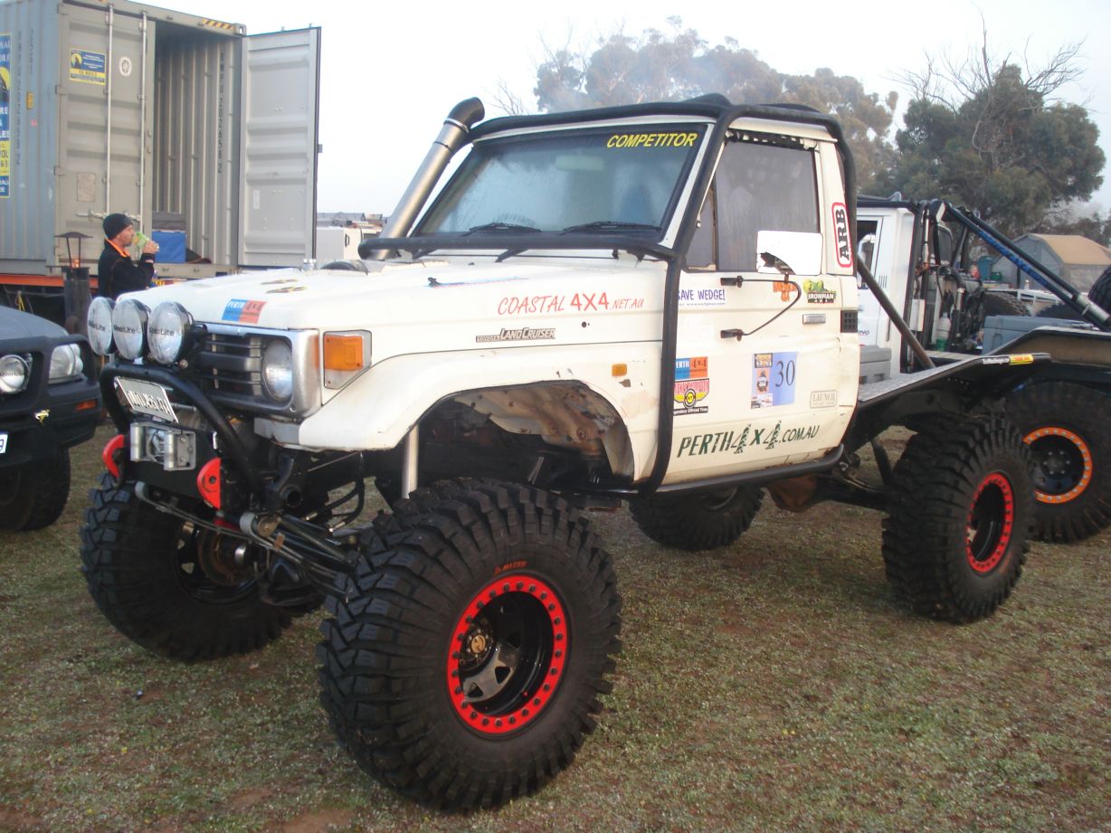

Well over the last few weeks ive been getting the car ready for Coastal Rocks the Paddock, its been some late nights.
The car came up like this with:
40" sticky treps on beadlocked rims
Guard chop
Exo
Front redback airshocks
Sliders
Hydro assist steering
The car still had some issues with spitting power steering belts and was still running clicking longfeild cvs.
The fist day saw us starting from stage 8 and finishing on 2, we aced stage 8 for the full 100 points in the fastest time. 9 we were penalised for 3 or 4 reverses. 10 we had a hard time in as it was very tight we didnt finish it in the allowed time but still got a decent score. 1 we totally screwed up and got 0 on, couldnt get up the first stepup :S. 2 we again aced for the 100 points.
That night we had the mud run, i wanted to make up for the screw ups during the day so i went for it... Launching at high speed off a 2m drop off into mud took its toll. I bent my front diff housing on the LSH up and back at a 30deg angle, snapped the axle and took the Schroeder valve off my airshock with the tyre. Still finished it with the fastest time in 3wd! Cleaned it down and set to work fixing it.
Massive thanks to Duncan for all his work!!!
A late night/early morning saw us back on the tracks for almost the whole of sunday.
Stage 3 saw us get just shy of the 100 point mark, got high sided on a rock not 1m from the finish. 4 and 5 we nailed for just shy of 100 points each also. Stage 6 which no one had finished saw me get just shy of the 80 point mark, i sheered all my kingpin bolts on the LSH, mashed my longfeild cv on the LHS and sheered my locking hub on the RHS.
We took her back to the pits with the help of the tractor once again pulled it down and put a new swivel hub on it. Time ran out and we had to miss out on stage 7.
The car is battered and bruised, the sliders are all bent, sump got hit, front shackle pins are broken, both air shocks have blown out and my snorkel is crushed...
It was all worth it though!!! I came away with 3rd in extreme class!
Now its time to rebuild everything again!!! yay
