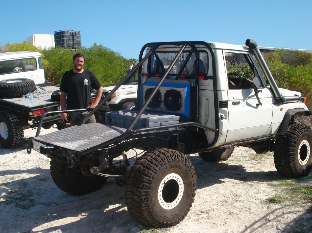

Heres the only pics i took last weekend.
heres another of me skull dragging a navara up a sand dune because it ran out of fuel...
great down travel but it bottoms out on the anti inversion part of the shackle now.
The extra weight of the cage and tray has made the angle more severe.
Im going to need to rectify this.

I made the rear two body mounts solid steel to stop the body squeeking on the cage.
I have to pad the inside of the cage around my head
Then its time to tie up a few loose ends b4 comp.

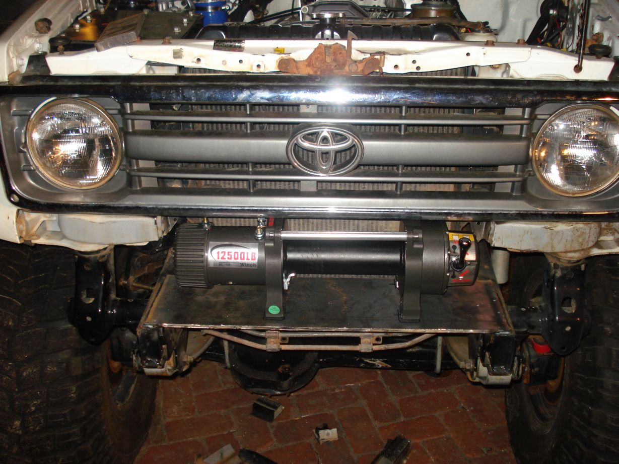

Received my winch, Big thanks to Chris at Locktup for this! Its actually a very good winch, i pulled it down today to check it out and add more grease and its basically a perfect clone of a warn. All going well next weekend, if this winch performs well they could be purchased from Locktup.
Mounted it as far back into the front of the car as possible

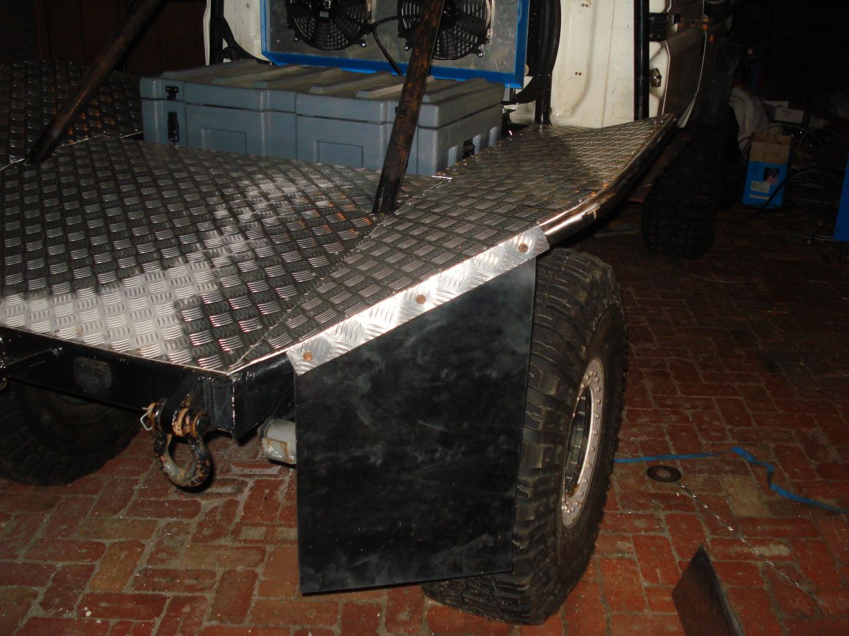

Basically finished the tray, mounted the mudflaps and fitted the pumps into the tray. Ran the wiring for some rear LED lights too.
Finished the winch cradle tonight after work, still dont know what to do for light mounting. The rest of the bar work will go on after the comp.
Im real happy with how it fit for such a huge winch, the only thing that sticks out is the roller fairlead which wont be so bad once i fit rope and run the non roller fairlead.
All i have to do now is wire it up, fit some rear lights and a rear spotlight to illuminate the toolbox and when reversing.

just a thought dude .. why not mount the winch control box remote in the engine bay .. and place the conector in a accesble place for ya .. ( I have 2 one at the control box in the engine bay and other inside the cabin )
