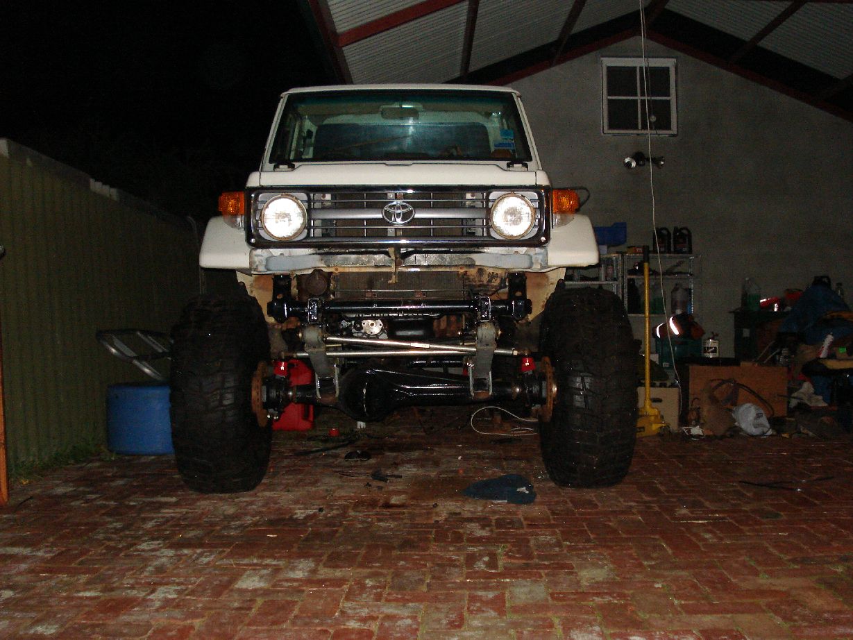

im nearly there...
Random pix from tonight
Looking good. Is there any way of getting the Ubolts to wrap around the axle housing likethe rears?
I was talking to the owner of that SOA 75 series the other night. He says he did rotate the front axle but didnt turn it enough. I didnt check ,it was too dark.
He says it makes a bit of noise under load sometimes.
He is also thinking about going back to stock.
I give him MUDs address but I havent seen him log on yet
Yeah im going to get the front ubolts to wrap the housing like the rears... somehow
