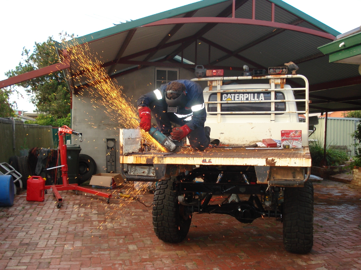

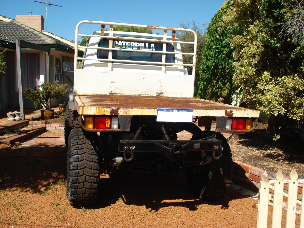

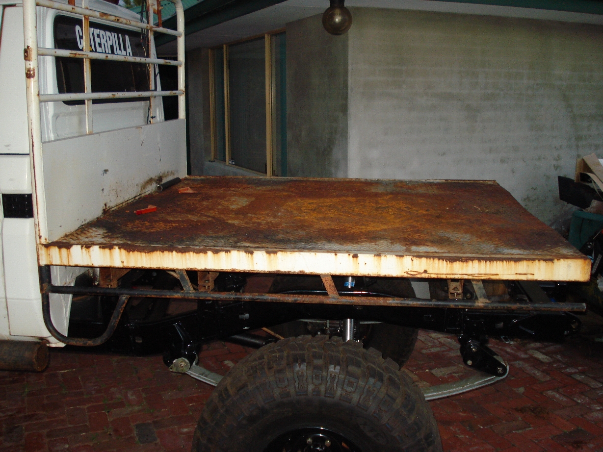

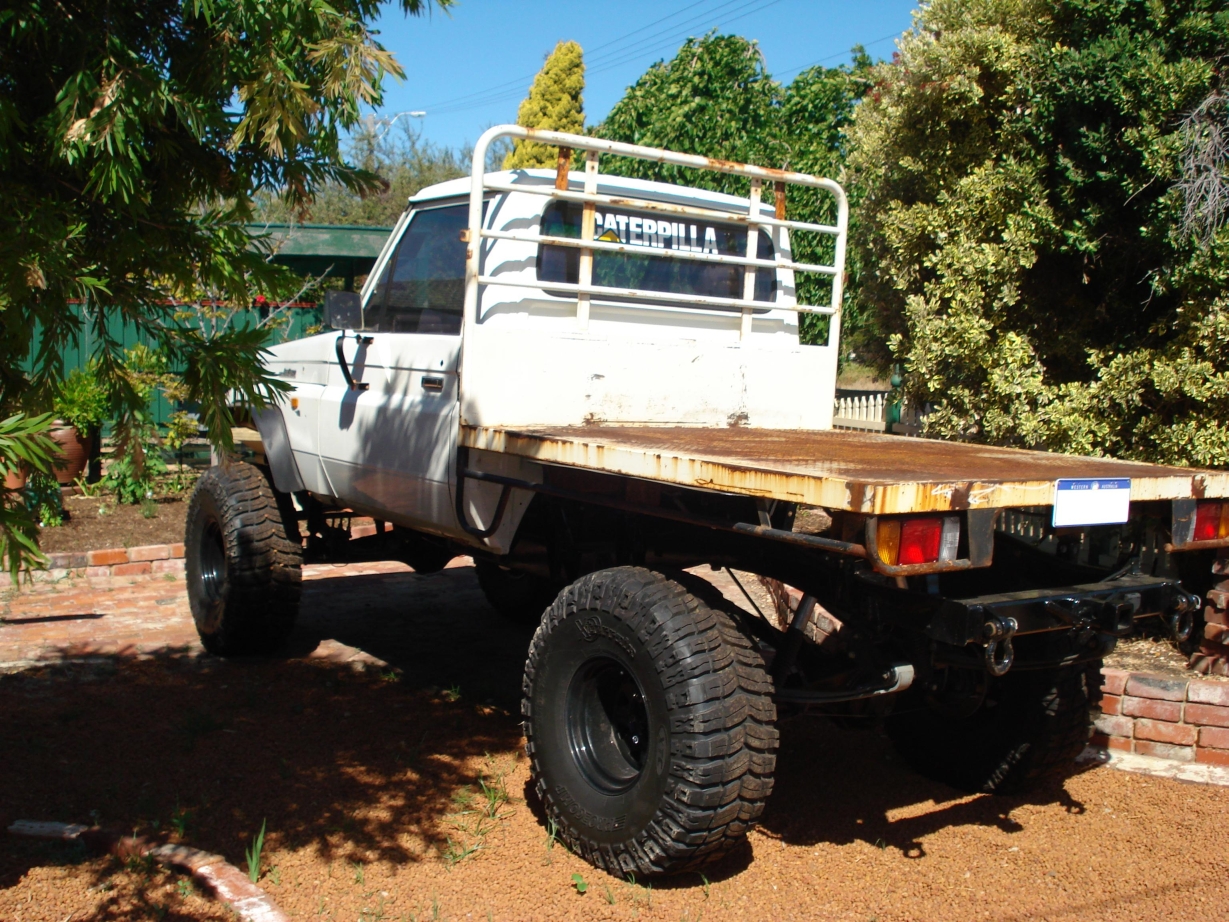

Tempoary tray almost done, 2ft of overhang gone
OMG!! he used the steel tray:bang::bang:
Keep an eye out for an alloy tray and feel the difference unless you are going to be carrying around buckets off 50T excavators:D
i need the weight over the rear... BAD
and the tray doesn't weigh any more than 350KG
Ok,I know what you mean. But the alloy tray is about 250kg or less,I know 2 strong guys can lift one.
If you throw 2 big spares and a tool box over the rear axle it will be enough;)

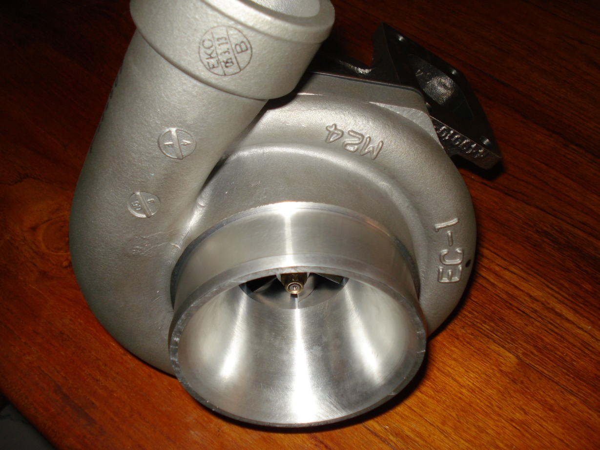

I ended up getting a Water cooled Garrett GT2876R BB turbo with a .64A/R, this will fit a little bit better within the ranges of the 1HZ compared to the GT2871R i was going to get. Its the same rear housing as the 71 but with a slightly larger front. It has a 4" inlet and a 2.5" outlet. Ill have to make a 3" exhaust side dump (the T25 bolt pattern is going to be tough...)
I got a DTS turbo manifold and a T3 - T25 adapter flange.
Ive got it 1/2 together i just need to get some new M8 bolts for the turbo mounting.
