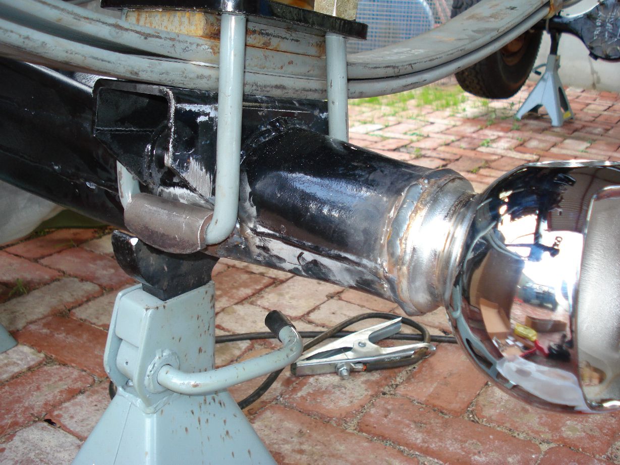

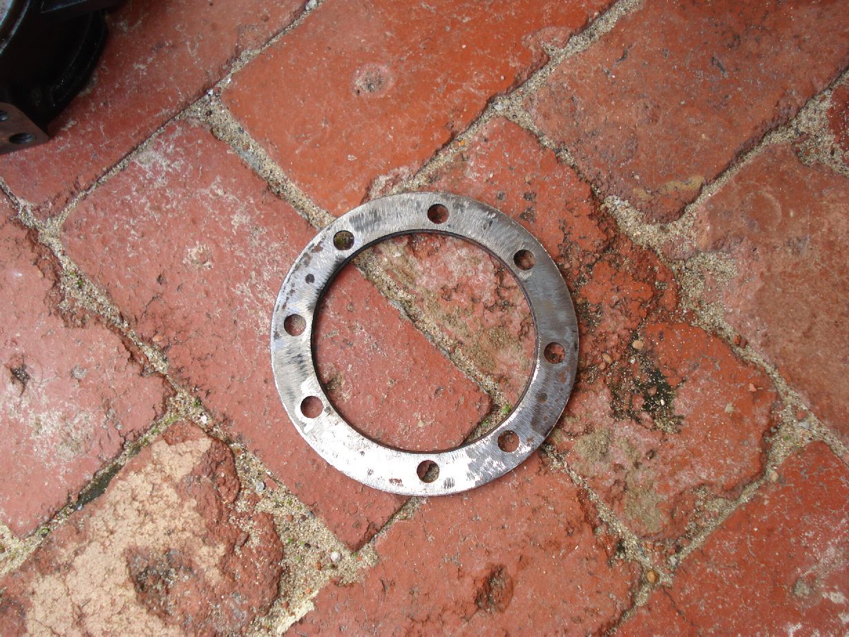

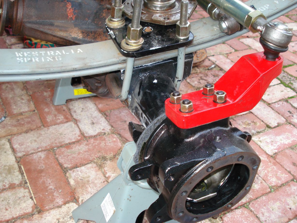

Anyhoo i managed to fit my knuckles back onto the housing with 5* of Castor, welded on my u bolt receivers (not yet finished) i put together the passenger side swivel housing and high steer, made a spacer ring out of the old backing plate so as to do away with the backing plates all together. I put the center in an did a few other things... I wet and cold... but happy as i have made some more progress...

Oh and some update pix
Its coming along;) but those fishplates need to be bigger. I can see ongoing problems with ubolts coming loose.
Another way would be to have some custom u bolts go around the axle and held there with some guides
your right and ive been thinking the same.
If i had my time again i would have made the spring perch the lower ubolt holders..
anyhow i need custom ubolts neway as the thread dont go down far enough.

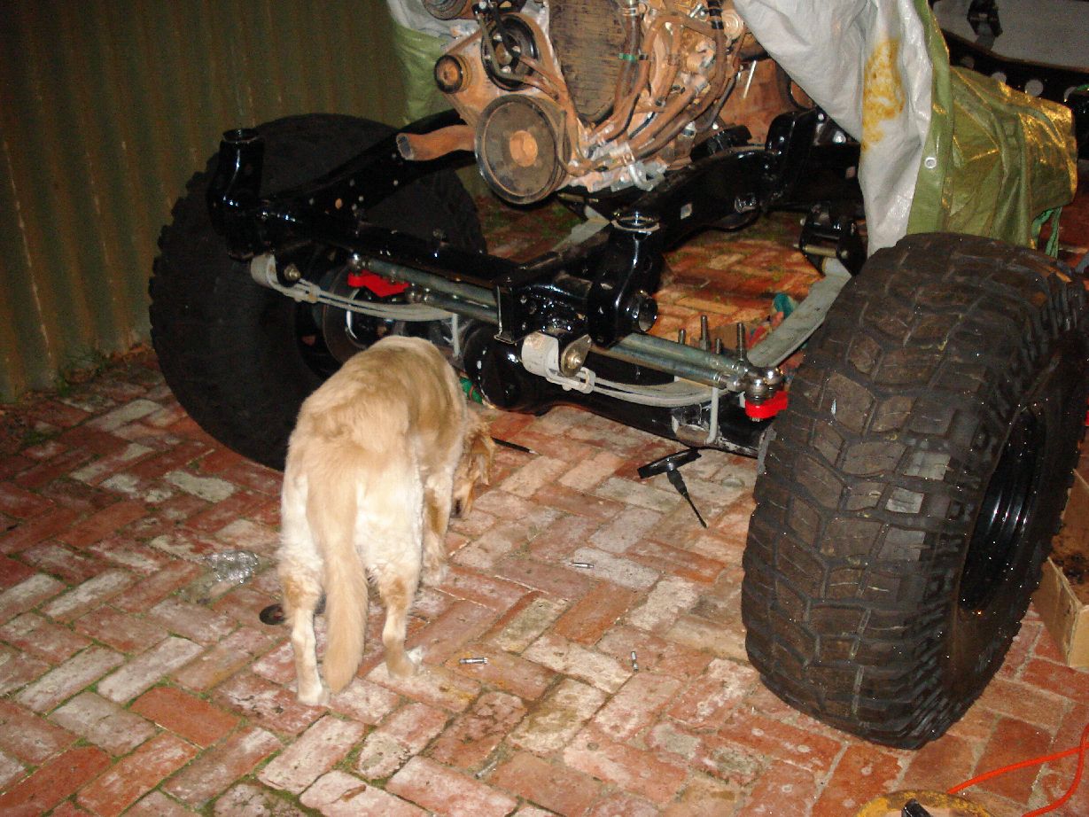

Well what do you know... She does hold her own weight!
For the first time in 2 years, she can hold herself up!
Check out that Approach angle :D
And the pix: Maby a sticker that says caution over width is needed?

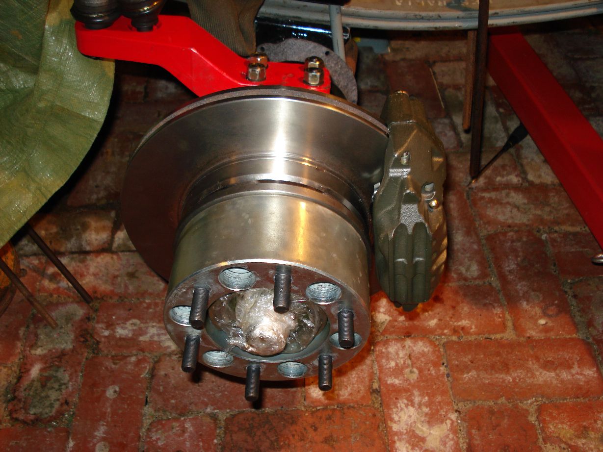

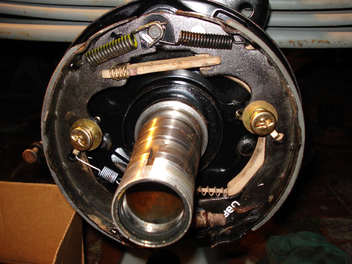

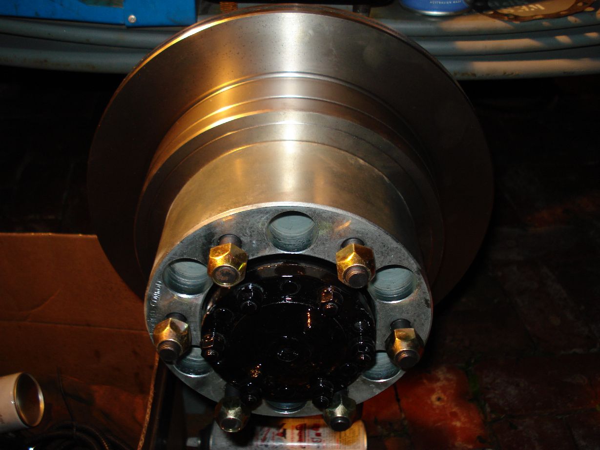

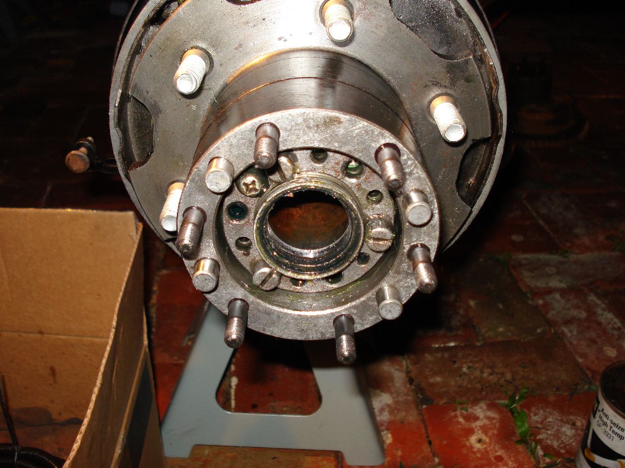

Removed the rear backing plates and cleaned/painted the hub assembly.
The 10mm x4 dowel conversion
Completed Hubs
Fun Time lol
