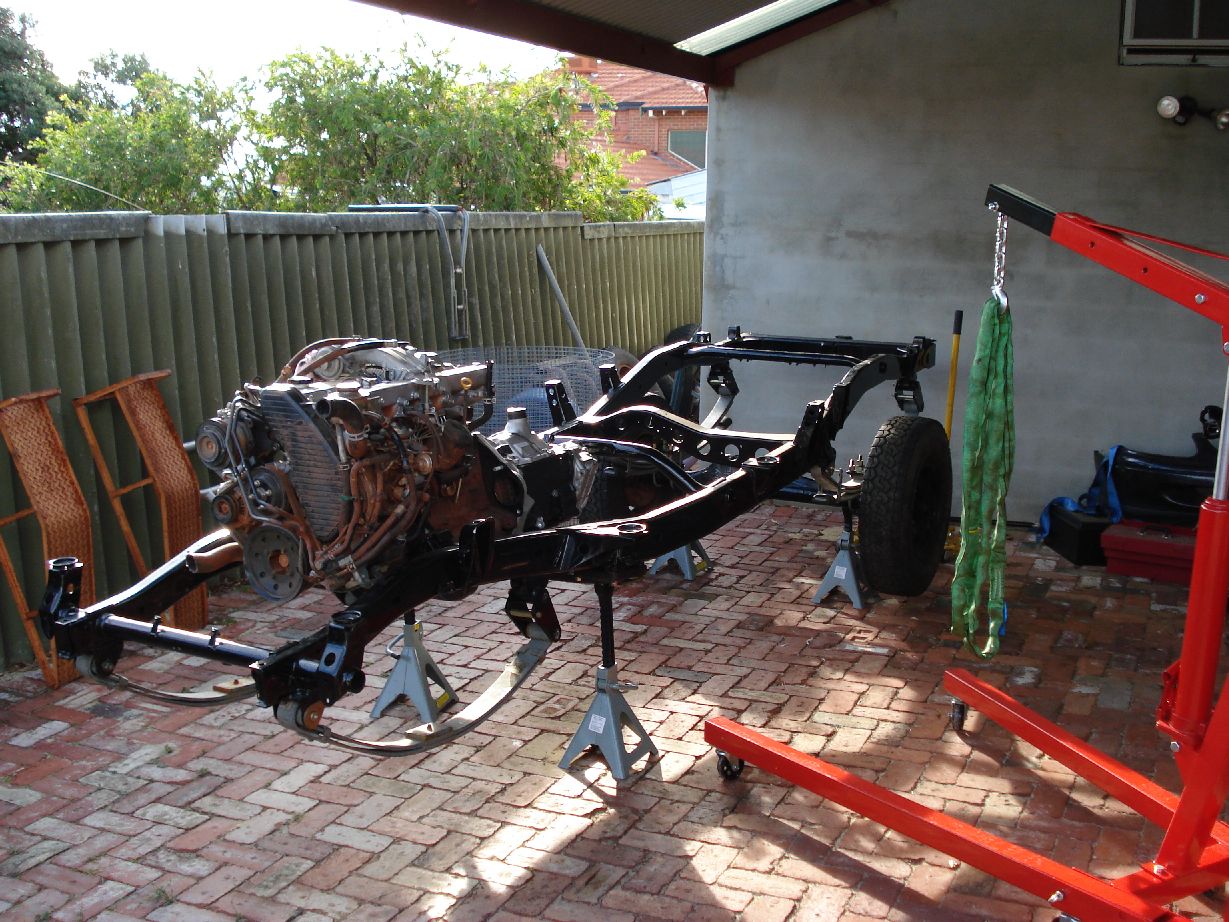

Hello all

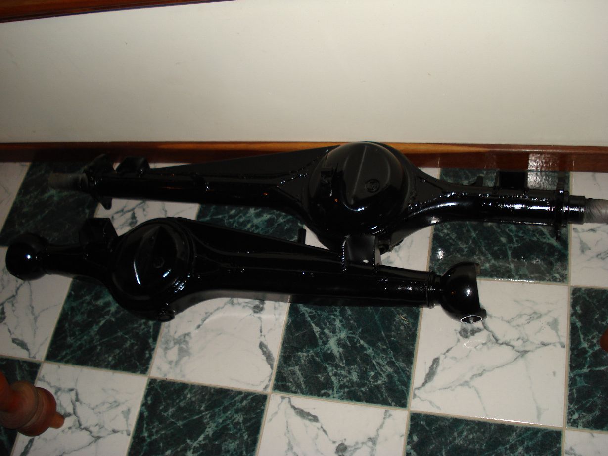

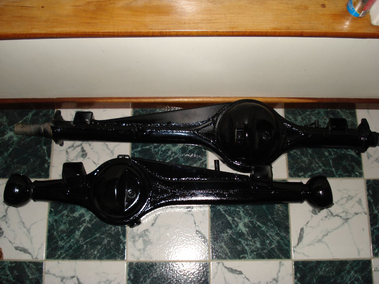

Ive been busy moving everything back to my place so i can work on it every day/night if i want (YAY)
I had both difs in place, i had all the hubs on and wheels on, i put it on the ground and it stood under its own weight for the first time in so long!
Its a fair wack taller than i had first wanted... but i can live with that
But then my stupidity struck... i didnt finish the C&T, i cut and i rotated but i didnt weld it as i wanted it perfect and i was going to adjust it later. POP off comes the knuckle and ball and down goes my rig onto the floor again... But im going to take advantage of this, im going to get the other one out too and get them chrome dipped BLING BLING!
Yes you all may laugh... but after 1 1/2 years i was getting a little eager to see some action!

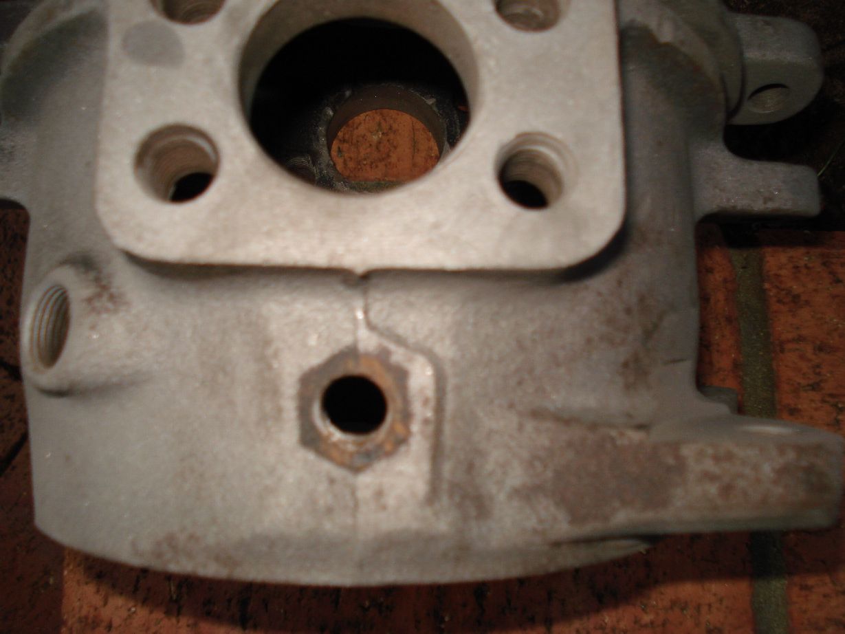

Ive got to buy some new thrust bushes for the inside of the spindle and possibly some new lower kingpins as the last people to work on this truck were realy rough and gouged into everything (as you can see from the above swivel housing pix)
