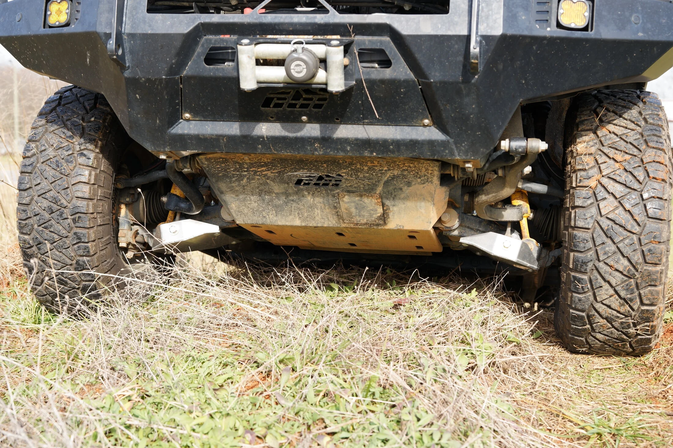

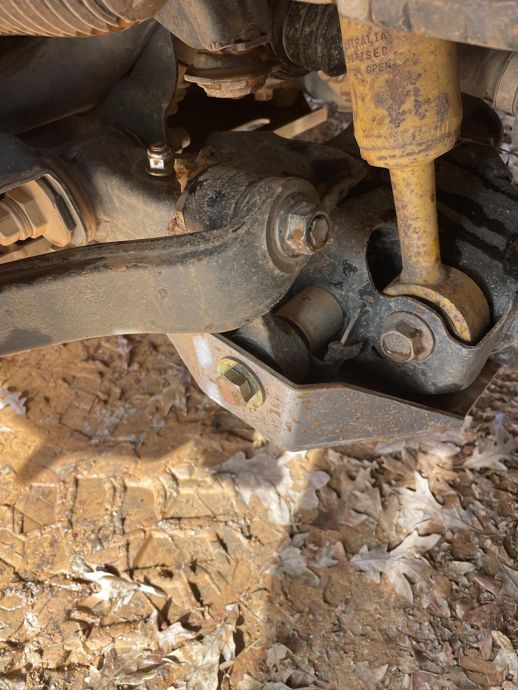

After test fitting and taking Our new KDSS relocation kit on the trails of Uwharrie for 2 days, it's ready for production.
Our Kit moves the front KDSS sway bar 1.5" forward (an additional 1/2" more than other KDSS relocation brackets), and encompasses a LCA Skid plate/ End Link support to keep the new longer end link bolt in double shear.
The kit includes everything you need to install.
2 - LCA skids
2 - Frame side KDSS relocation brackets with hardware
2 Custom Spacers for the factory LCA end link pockets
Longer Grade 10.9 M15-1.5 Bolts
Custom length carriage bolts for the LCA Skid
This gives you the maximum allowable room for larger front tires.
The first run of kits will be $650
Made in North Carolina
andersonoverlandoutfitters.com
KDSS MAX Relocation Kit
Anderson A4X Land Cruiser 200 Series Full Front KDSS MAX relocation kit. Relocates the front KDSS sway bar 1.5" forward giving you the Maximum room for additional clearance of larger tires on the 2008-2021 Toyota Land Cruiser 200 series. The LCA skid plate fully captures the KDSS end link...

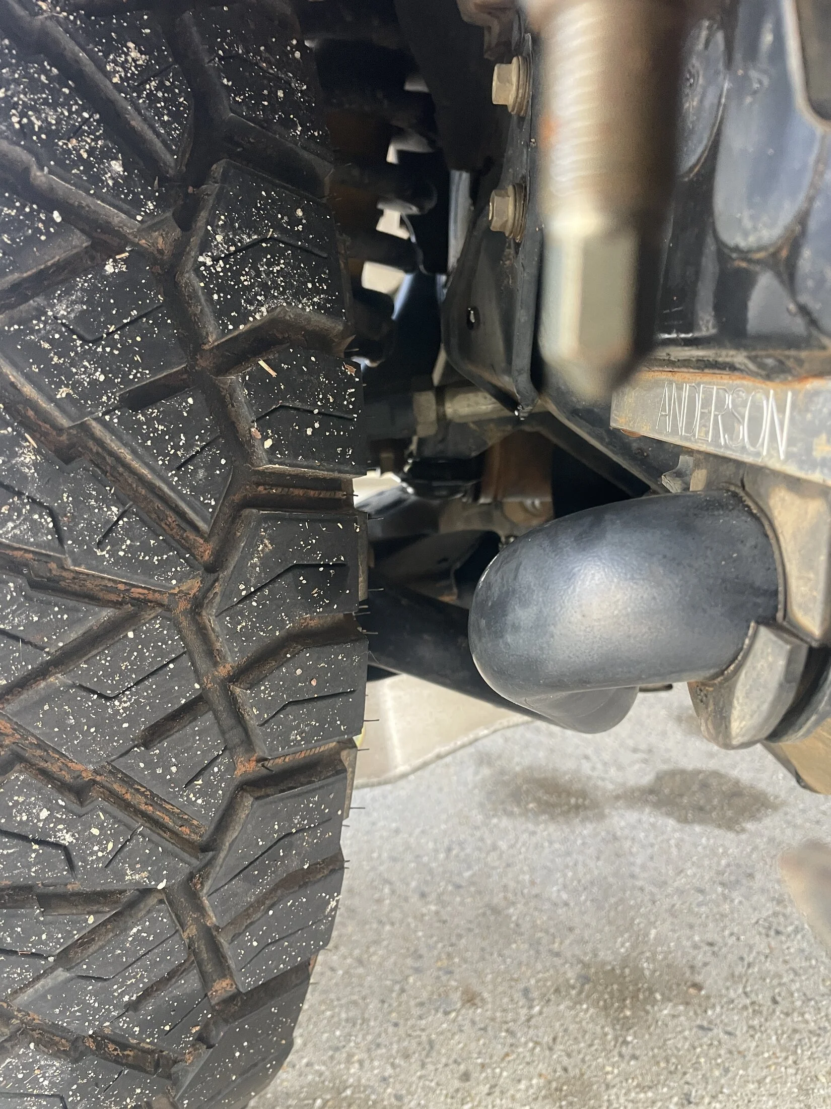

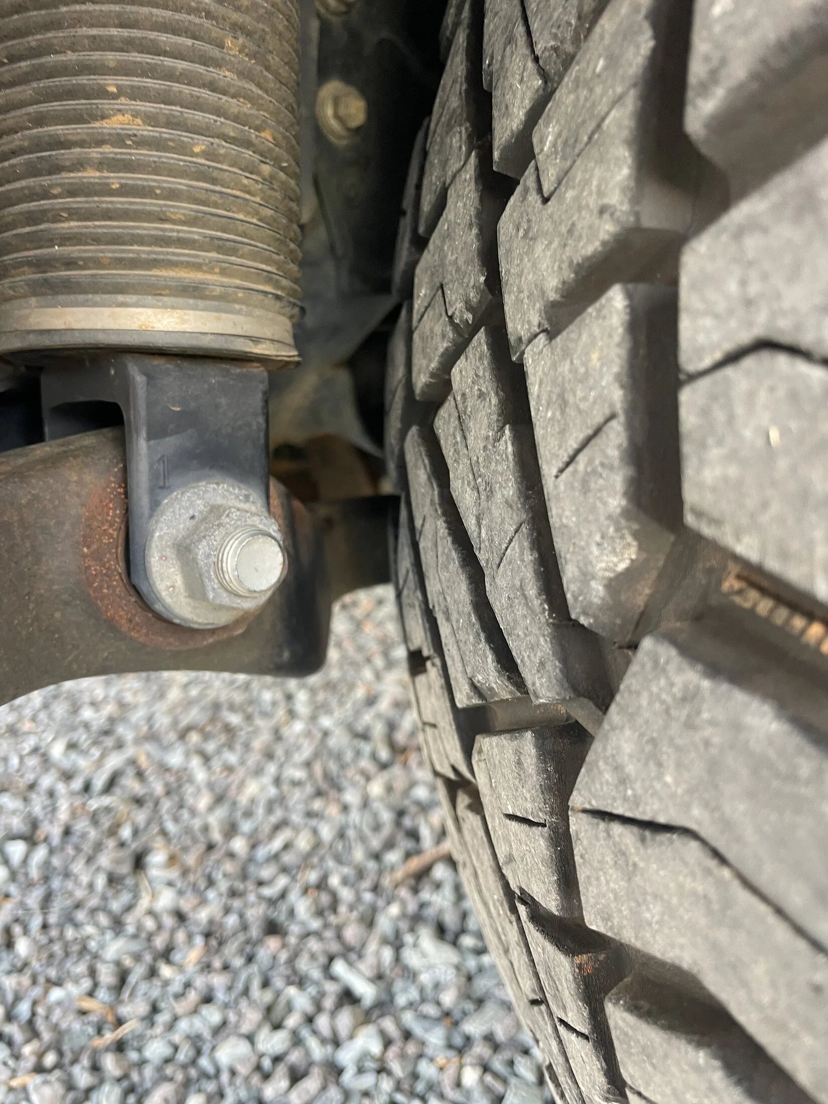

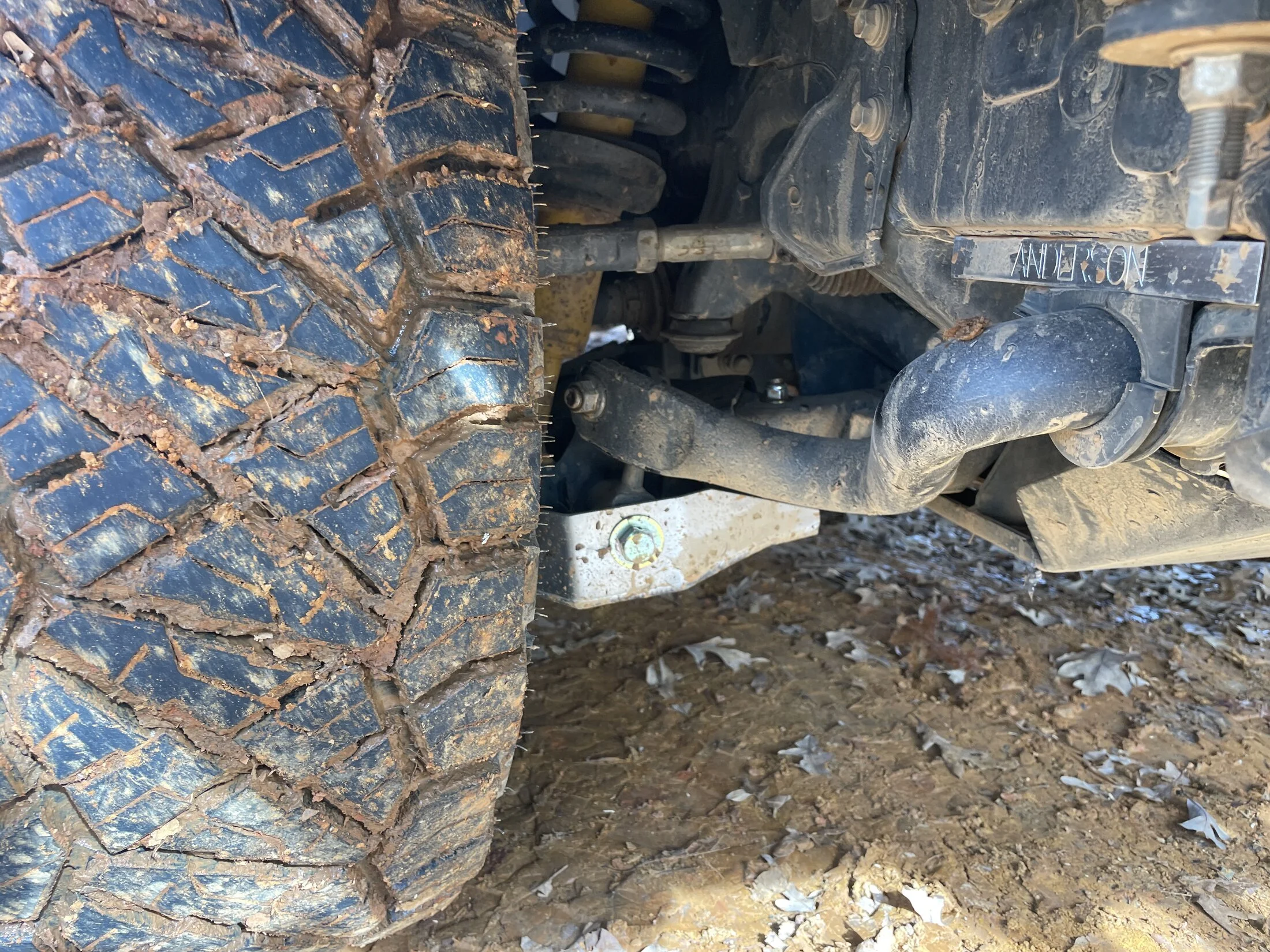

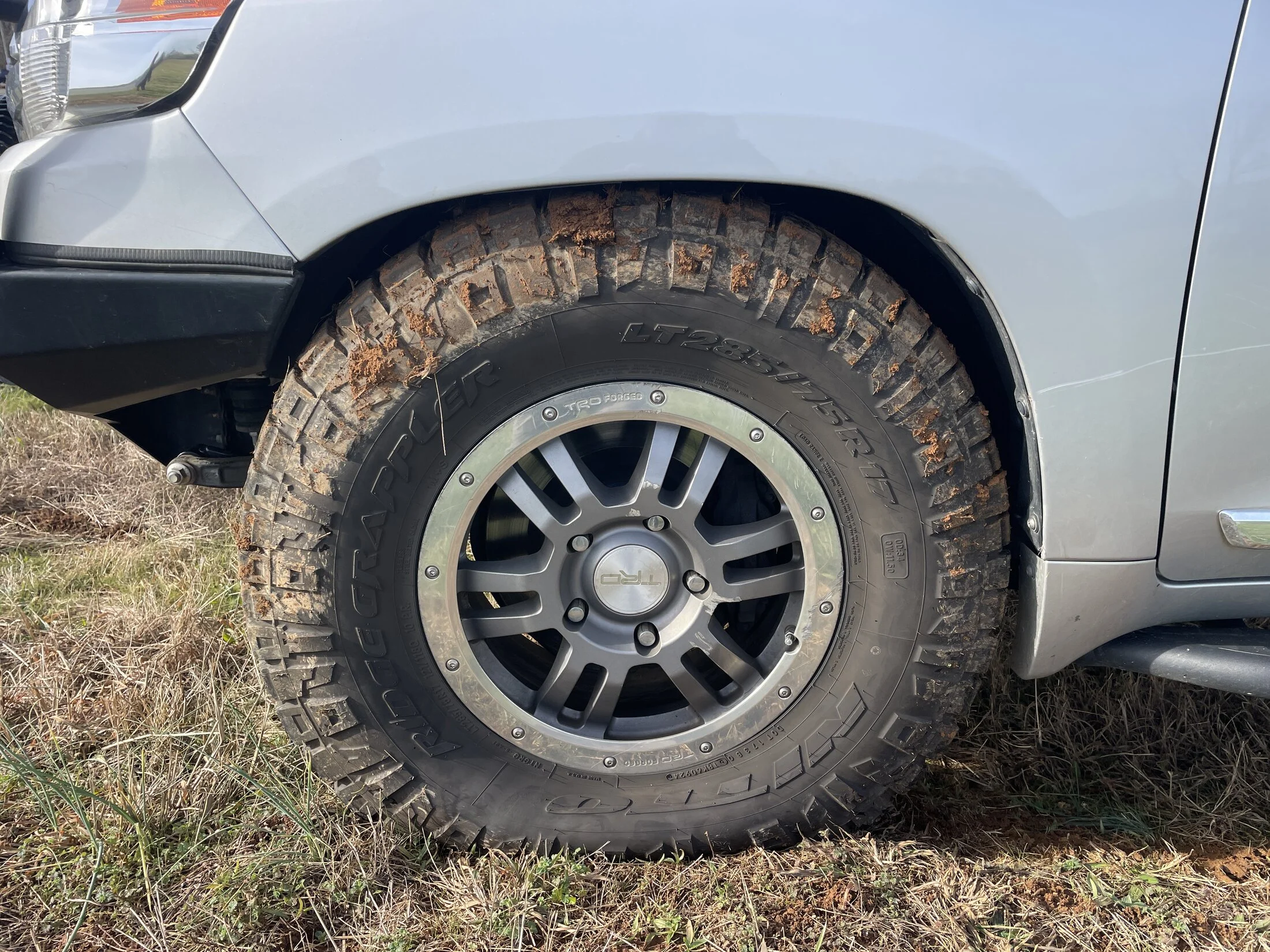

Any Questions about 35x12.5-17's should be answered by Thursday... I have a set of Ridge Grapplers going on Wednesday...
My truck is sitting at near standard alignment specs on 34's (OME UCA), +2" OME standard lift, and right now stock bump stops (that will change soon to Timbren Active Offroad Bumpstops)
Nitto Ridge Grappler Tire specs: 35x12.50R17LT E 121Q - 34.76 tall, 12.52 wide.
Hoping to get back to Uwharrie private land to do some more testing over the break with the 35"s....
I took these shoots today, steering wheel cranked over to the max and held in place..
Effective wheel offset is 18.25 (rock warrior + spydertrax 1.25” spacer)
