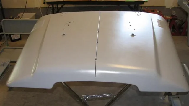

Hood after some minor bodywork, ready for high build primer-

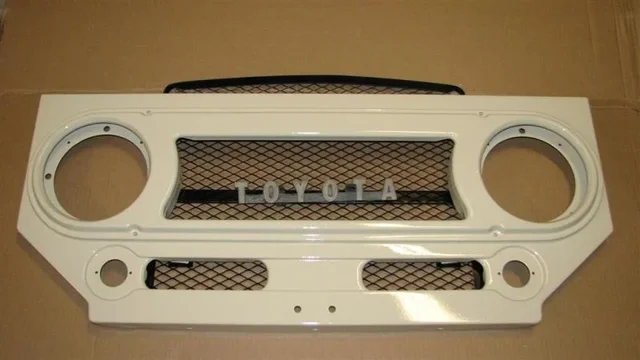

Bib and bezel in olympus white prior to wet sand and compound/polish-

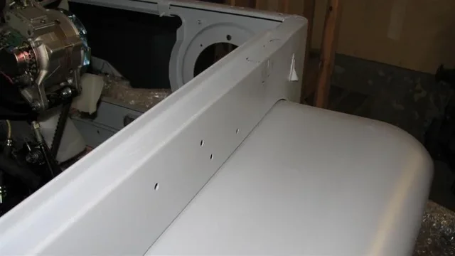

Front end aligning and marking spots that need body work-

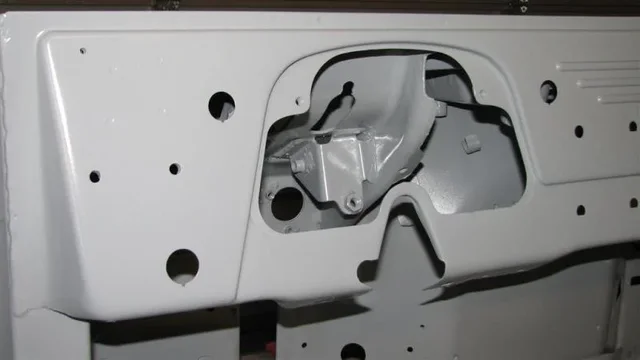

Once the front end is painted I plan to tackle the tub, I have a couple holes that are not correct in the dash, and a couple small spots of rust, but nothing too bad.
