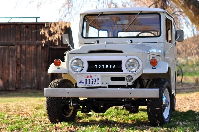

Before:
After:

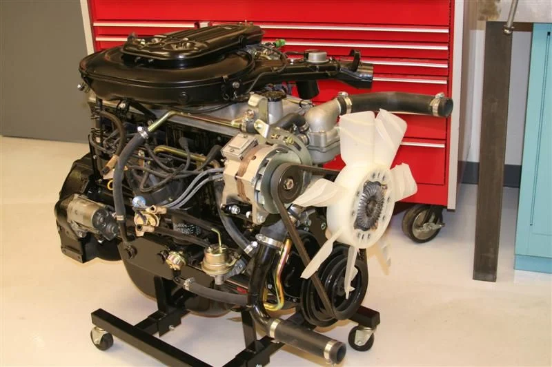

Pic 1- The super clean 2F, this was removed from a 1984 FJ60 and then rebuilt with 100% OEM parts including all the bearings, rings, pistons and seals; and a brand new carburetor. This is the only thing that will not be stock to the truck. I am going to see what I can do to make it "look" a little more period correct. I am going to try and use the original air cleaner and valve cover from the original F; which is blown but was included with the truck.

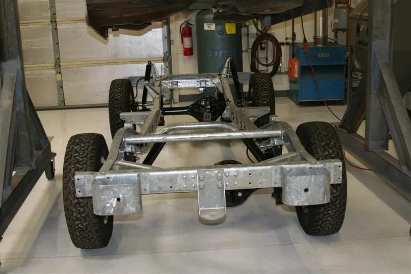

Pic 2- The rolling chassis as I picked it up. The axles are almost finished up, there are no brake parts in the right front wheel, no hubs installed (have the period correct Warn hubs to restore and install) and the rear pinion seal needs to be replaced.

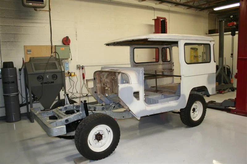

Pic 3- The body as I picked it up. Some minimal rust; but about as good as I have ever seen for a truck this old.
