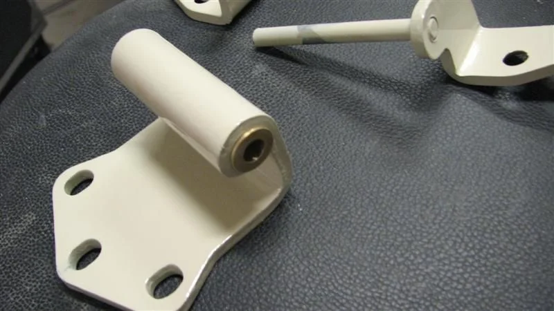

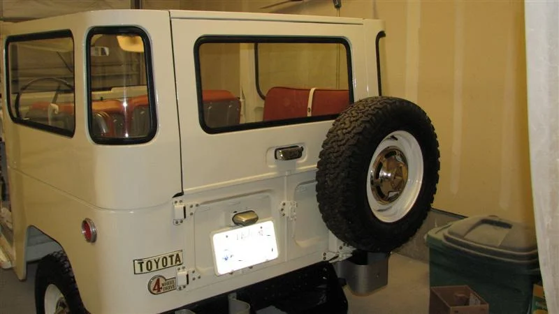

First, the rear hatch is finished up. I struggled a bit to get it straight, but a good friend of mine helped me out and it looks great now. I put bostonmangler's brass bushings on the hinges as well to increase the durability a bit.
A couple pics of the hatch work and hinge's:

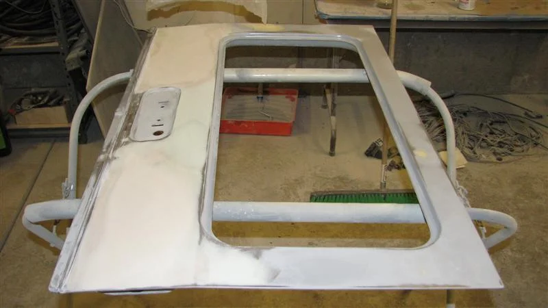

Also, after way too much sanding, priming, sanding and more sanding the top is finally in paint as well. I debated what color to go with for the top and bezel, I was considering olympus white body color, shell ivory and a brighter white. I ended up going with Toyota code 040 super white. It is a very bright white, and I am really glad I did, the bezel really pops from the front of the truck and just looks like a classic Land Cruiser should. The top will be buffed/polished tonight, install the headliner and then I hope to get the top bolted on tonight as well.
A couple pictures of the top in progress, completed and the bezel:

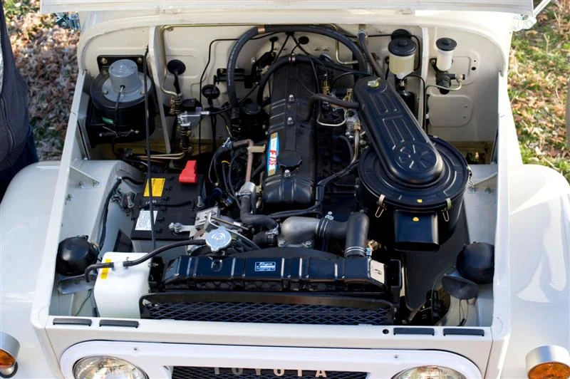

Last update for now, I am basically done under the hood as well. I added a coolant overflow bottle from and FJ60, I know its not stock but I hate the idea of anything leaking from this truck; and at least it looks stock. I also added a couple decals under the hood.
Next on the list is to finish the rear wire harness and a whole lot of buffing and polishing. I hope to have some higher quality pictures of the complete truck in the next couple days and will post them up when I have them. Thanks for all the compliments!

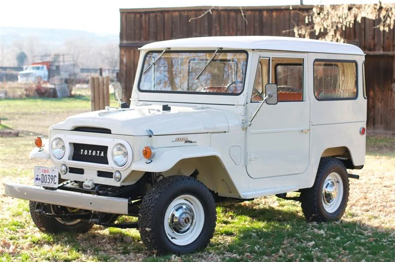

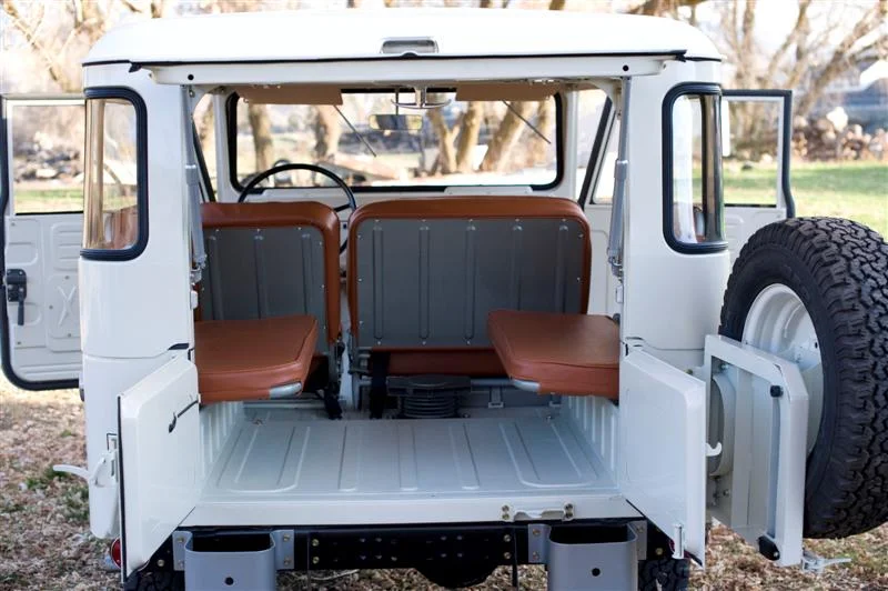

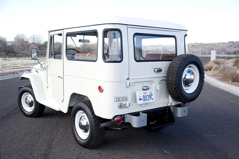

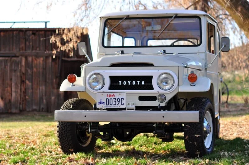

Well, the truck is basically done now. Still a couple small things to finish up but basically its all done. Still need to buff the paint out, and refurb the stock jack among other things.
I had the chance to have some professional photos taken last weekend, and I think the truck turned out pretty darn nice.
