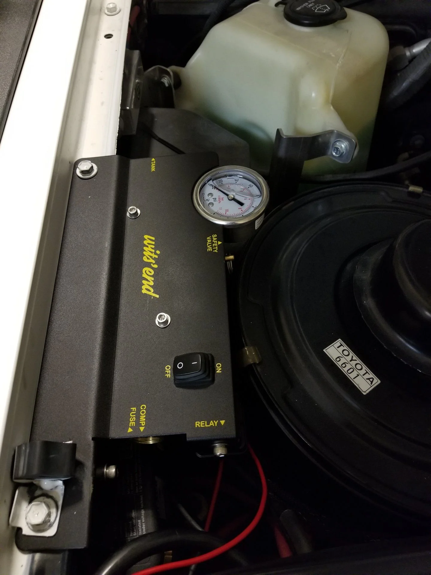

I have joeys OBA panel which is designed to mount on the passenger fender. I am in the process of mounting another one on the ARB so i don't have to lift the hood to see the pressure.

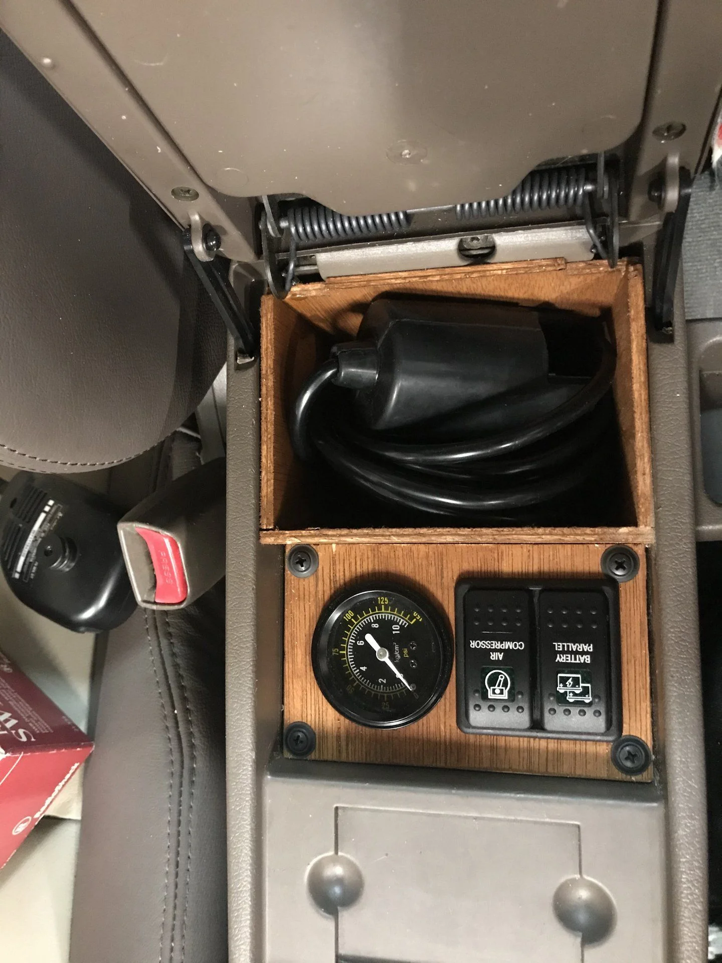

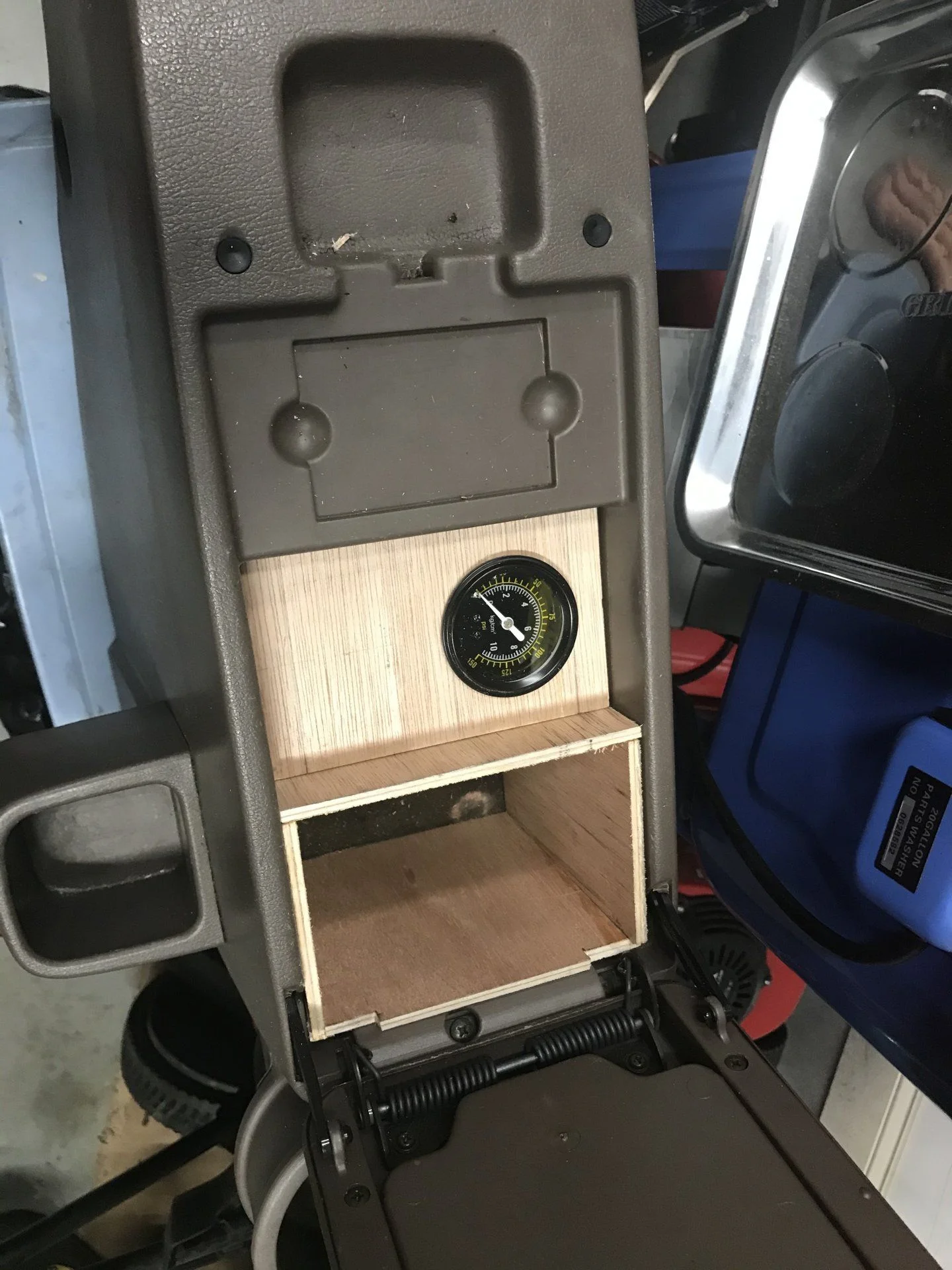

Decided to go with hiding the switch and pressure guage in the console. Also will be adding the dual battery Switch to the panel as well.

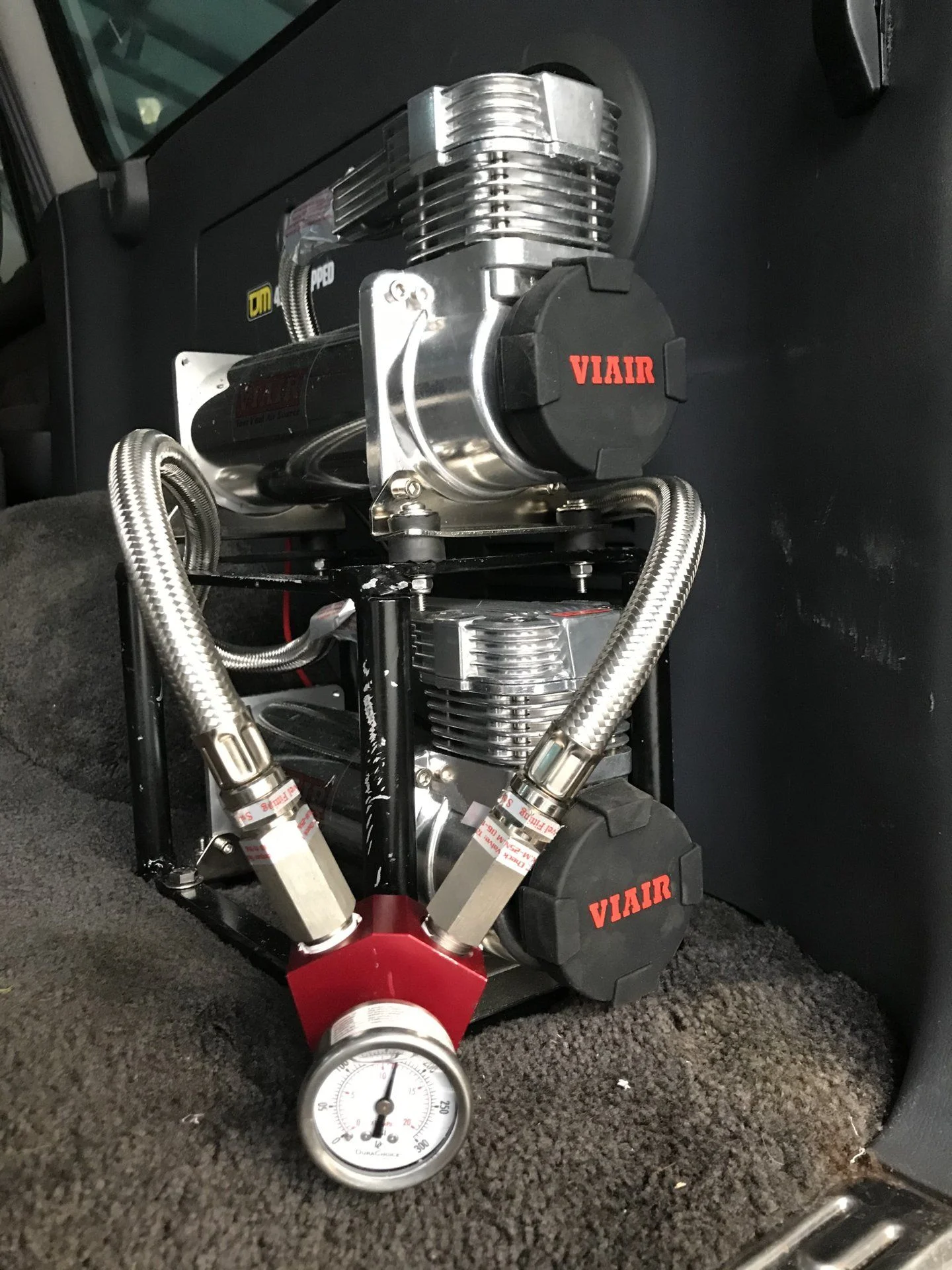

I use one behind a regulator for monitoring locker air pressure. Theoretically though, once it is set it's not needed provided that the regulator doesn't break...
I ran a viar and now a pacbrake, wouldn’t go back, though the viair looked fancy they are junk if you wear out a piston seal. They’re replacement parts are costly, and they won’t sell things like Teflon piston rings without also selling pistons and assemblies that cost almost what a New compressor would.
