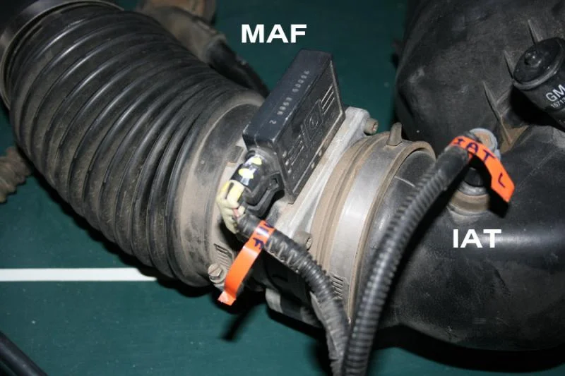

It looks like this engine has a MAF and a MAP. That seem correct?
That would seem redundant. A MAF is much more sensitive and accurate than a MAP so I wouldn't know why you would have both. I'm guessing you are seeing the EGR modulator - it would look similar to a MAP.
MAP and MAF is redundant, but the MAP sensor you have might be just an absolute pressure sensor. Basically an altimeter for the engine. It's a way for the engine to get better stoichiometry and fuel economy before the O2 sensor kicks in.

It is a Speed Density engine (aka Manifold Absolute Pressure). But, as you can see it has a Mass Airflow Sensor as well.

Yeah, I'm confused too. According to your diagram the MAF is located against the firewall but it should be in the TB if it's going to be sensing intake flow. Maybe yours is used to sense exhaust flow for some reason?

The MAF is in the big plastic intake pipe after the Inlet Temp probe and the air filter.

OK, I looked at the photo you sent me and now it makes sense, at least for the location of the MAF. Still dunno about the MAP. Maybe it has some sort of "limp home" function.
