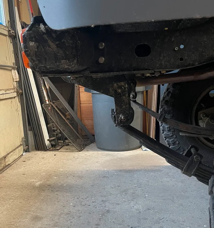

I put OME 2.5" lift springs on my Fj40. I also put on new SOR greaseable shackles. After a year of driving around, the shackles are still nearly vertical, front and back. Is there a solution for this? I run a hard top from September to May, then topless for the warmer months. Generally t he ride is nice, but if there is a hard bump in the road it is jarring.

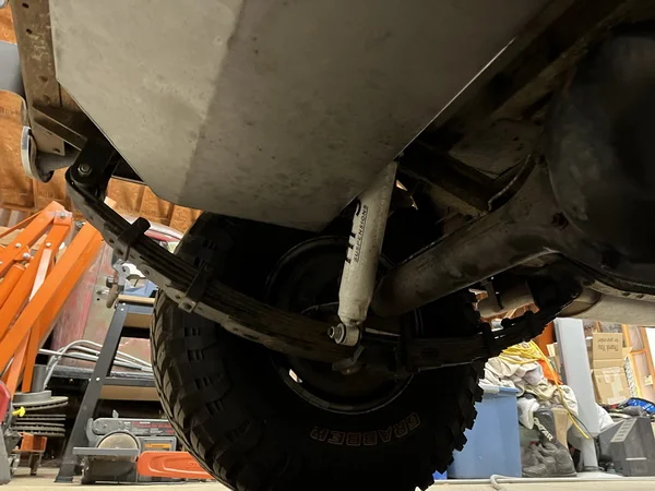

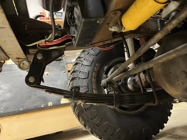

My longest leaf that does not have a U riveted to it would be the 1st leaf for both front and rear, see pics below, has anyone done this and have the mounting leaf not flatten out since not supported? Willing to give it a shot since the wife wont drive in it the way it drives now. I'm not a hard-core rocker but my son wants to take it to the Rubicon here in Nor Cal. Pics taken before shock replacement.
I'd 1st remove the bolts in the clamps that are going across the top of the springs. It's hard to see in the pics, I think id remove the 3rd spring from the bottom. Do the rears 1st and drive it. You might not have to do anything to the frt. I'd hold on to what you remove.
Top pic looks like 3rd from top is clean
Same with second pic
3 and 5.
Toss em
Thanks for the input, I may start with only removing the 3rd on each, check ride height (have 34 x 10 5 tires) and ride. If noticeably different will stay that way, if still stiff but have not lost much height, may try removing the 5th leaf and check again. Only labor involved, no $$ (which I like to do) so what the heck. Thanks again.

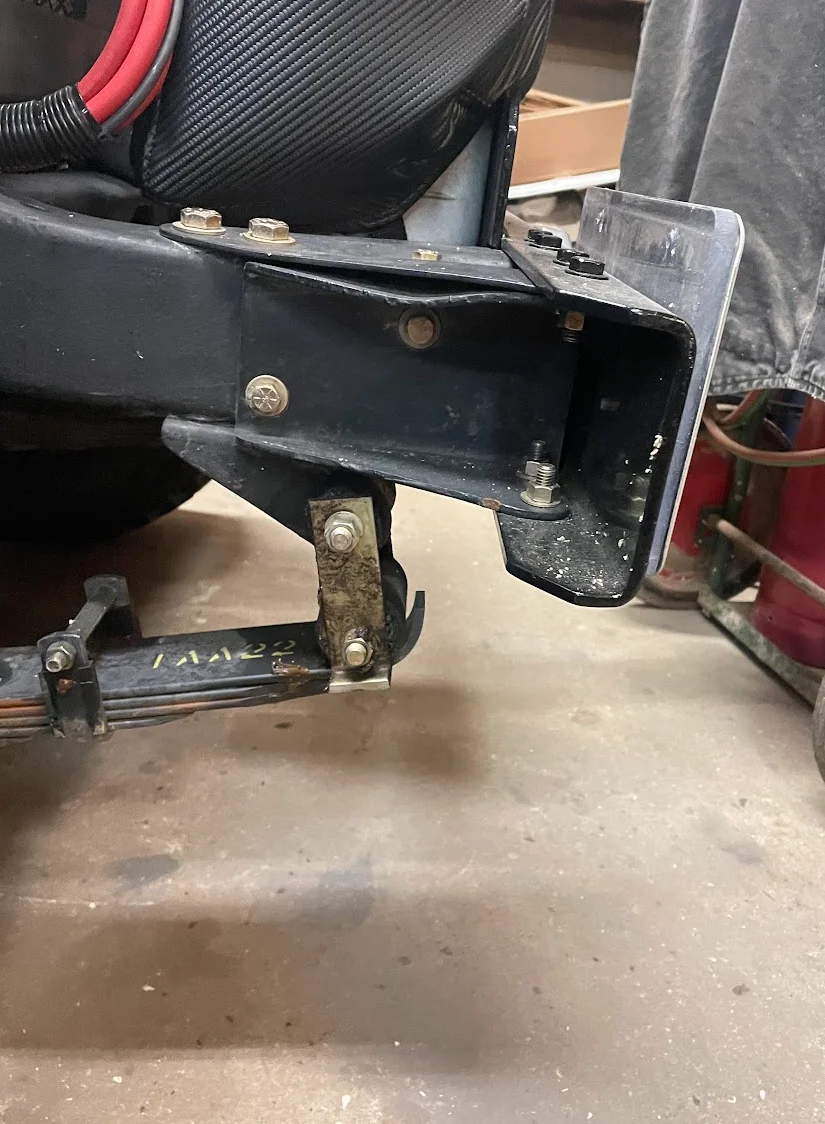

Finally, since removed, what's the opinion of others in installing the BTB shackle reversal kit? it's my understanding that the BTB's are part of Man a fre and do not add any additional height when welded to front of frame. If I do, would I need different rear shackles or do I just use the front ones in the rear position? I'm already using the U bolt flip kit.

I wouldn't do a shackle revesal. Too much work and money for no real benefit.
Remove the bolts on the clamps and allow the leaves flex and remove a leaf. Cheap and easy.
Good to hear, I may need to look into those springs. Any opinions on doing the shackle reversal? looks to be allot of work but would do if it is worth the effort and cost.
I am very opposed to shackle reversals
