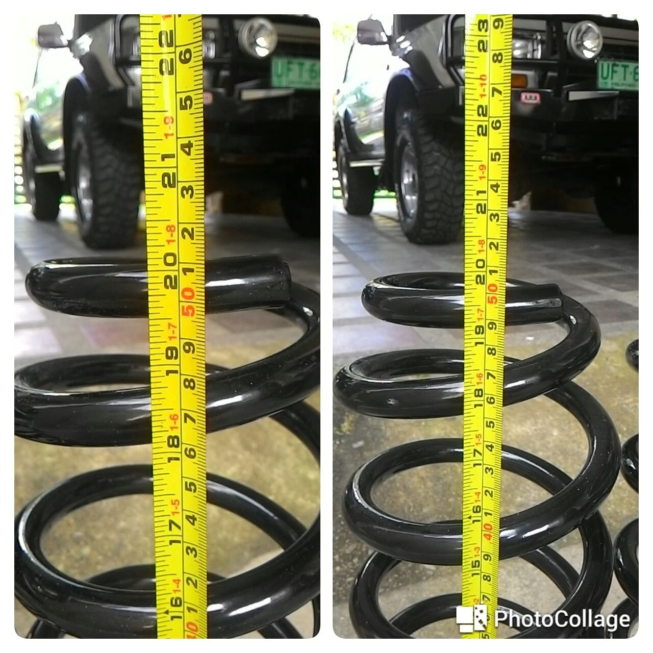

In my case I measured all the springs and put the taller ones on the driver side. Here's a photo of the 850, one measures 510mm while the other is only 500mm.

uneven spring height can be easily fixed using 2 different sized coil spacers. a friend of mine using an 851 spring fitted 1.5" spacer on the passenger side while around 2.5" on the driver side to get an even stance to the rear. it was a garage made spacer that looks like pipe (with diameter size of the spring) with 2 flanges welded on both sides. a cheaper version of using a thick metal plate :)
