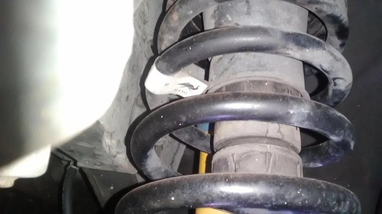

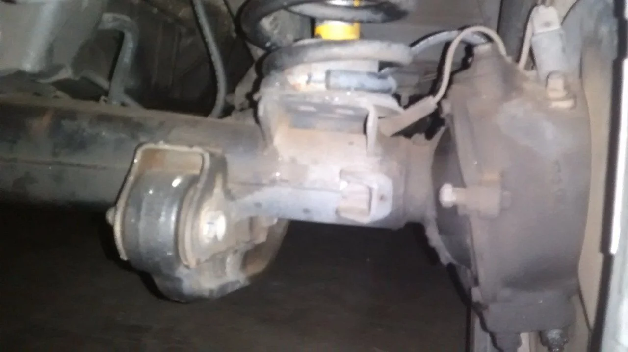

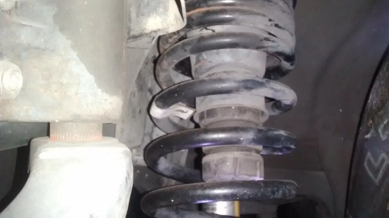

I gotta bring this thread back, cause my suspension bothers me.
I got B spring for DS, here in US.
First the measurements.
DS fr....21.25"______ PS fr...21.75"
DS rr....20.75"______ PS rr...20.5"
I turned my front DS coil 1" so it sits about 0.5" higher and it's still lower than front PS, with 30mm spacers up front. Otherwise front DS would be at about the same height as both rear ones. Front PS would be way too high by itself. Without compensating bu turning the DS spring, it would be lower than PS by 1 inch.
Should I just swap the front coils?
some pics.
