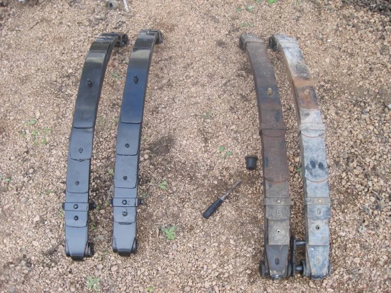

A few weeks back I picked up a set of OME Heavies from Kling-On along with shiny new OME hardwear to mount it all up. It was just the ticket that I was looking - broken in OME heavies that were of the old Aussie manufacture.

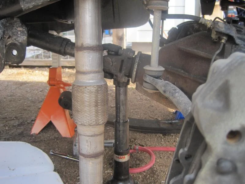

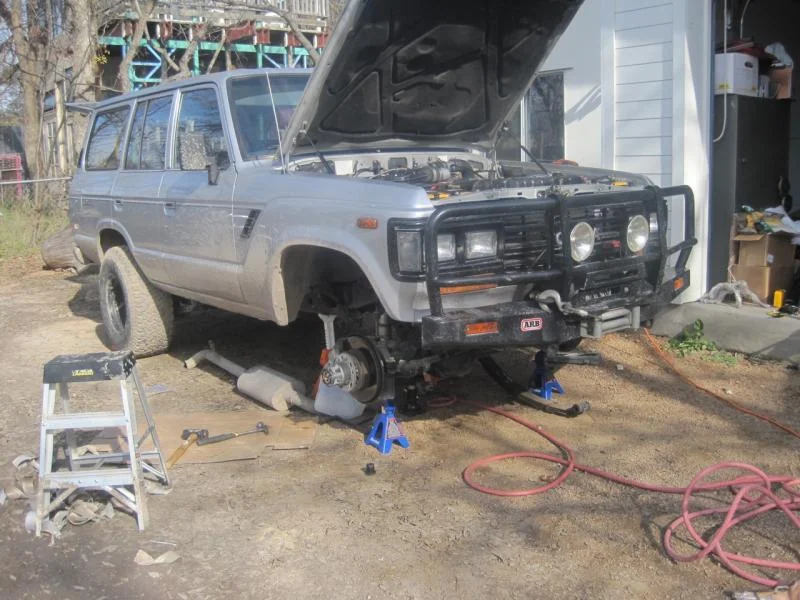

So, to start with, get everything up on Jackstands as previously mentioned elsewhere. The two big stands are for the frame and the little guys hold your axle. I used my bottlejack here to also hold the pinion angle, but an additional jackstand works for this as well (as previously suggested).
Once everything is up on jackstands and you've got the droop set in the springs, etc, you can start pulling bolts. At first I just tried to work on one of the springs but couldn't get anywhere. The secret to making this job a lot easier for me was to loosen all the bolts/remove nuts, etc of the entire suspension on that end of the truck.
This made getting pins out a ton easier for me and really sped up the work.

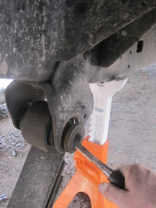

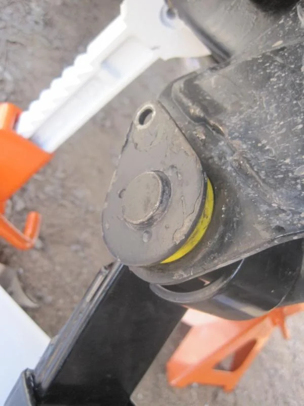

So once I had the u-bolts off, I pulled half the shackles on the front, pulled the nut off the fixed end and the little "keeper" bolt on the outside and did this on both sides. Once everything was off I just started working my way around a leaf spring slowly wacking the pins out. This was the slowest part of the work but I lucked out in that all the pins came out relatively easily (i.e. with no need to use fire/cutting wheels).

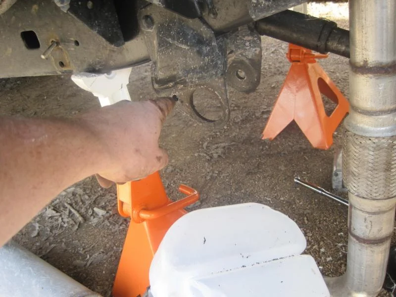

Once you've got the shackle ends dropped out, you can work out the fixed end. I was able to get these loose using the hand-sledge, a 12" long piece of metal rod I used as a pin driver and the pry bar/chisel to help work things loose from the outside of the spring mount as well. It took some work and cussin' but they both came loose.
