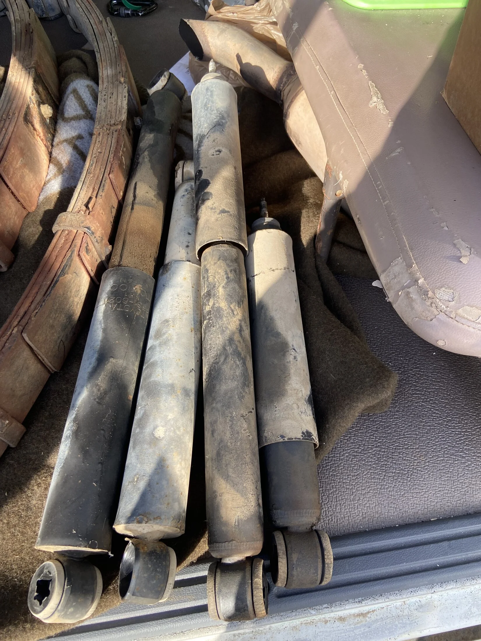

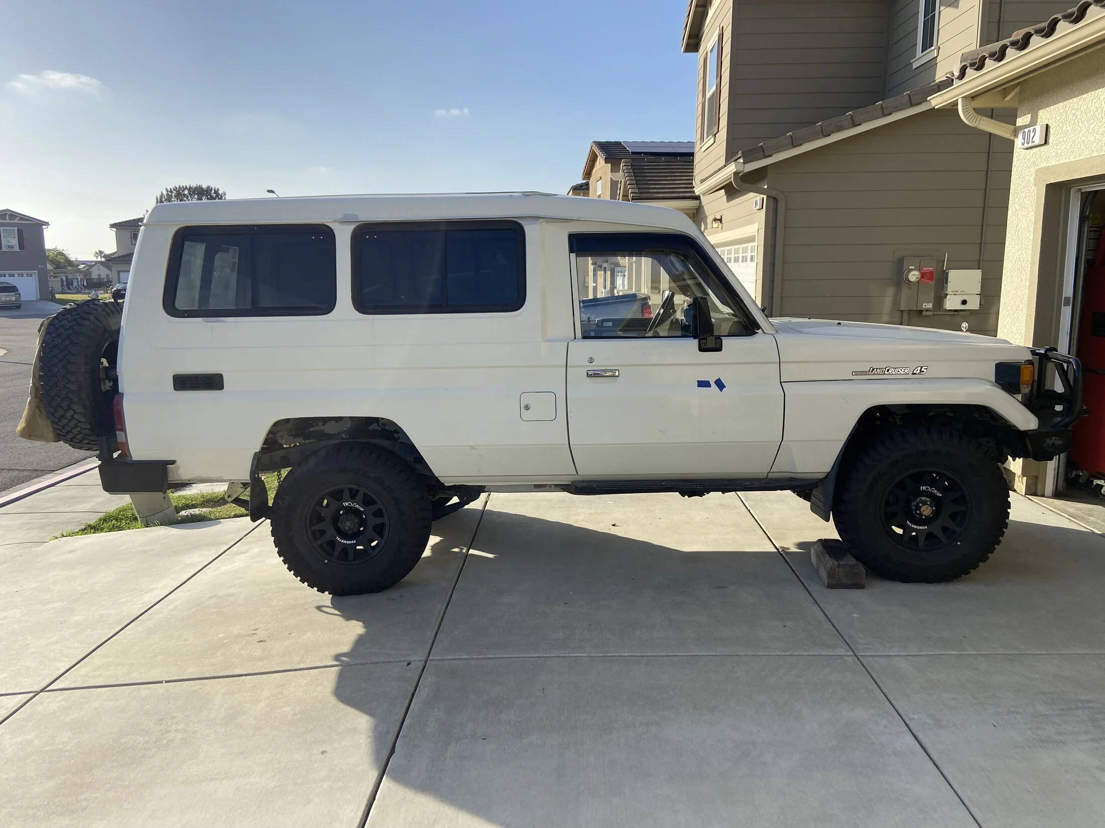

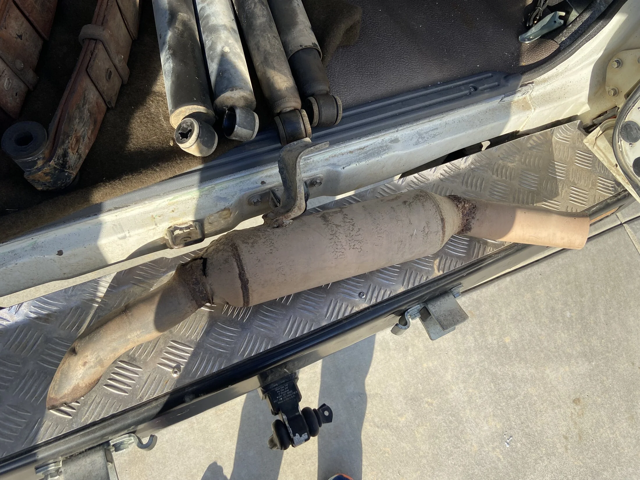

Installed a 2" OME heavy lift. My old leafs and shocks were totally clapped out. Despite the heavy leaf pack in the rear, this truck is so much smoother riding now. This lift took my caster from -1 degree without the lift to +2 degrees with the lift!

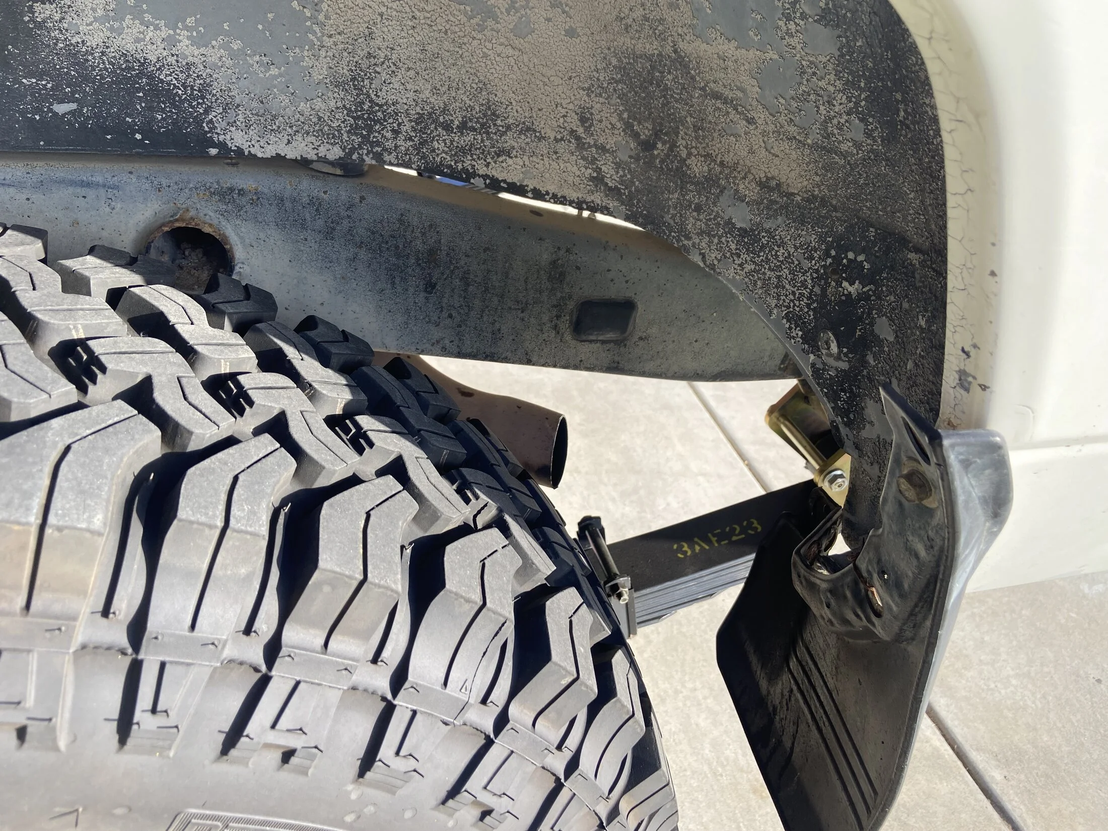

Made some slight exhaust modifications as the resonator was touching the rear bar.

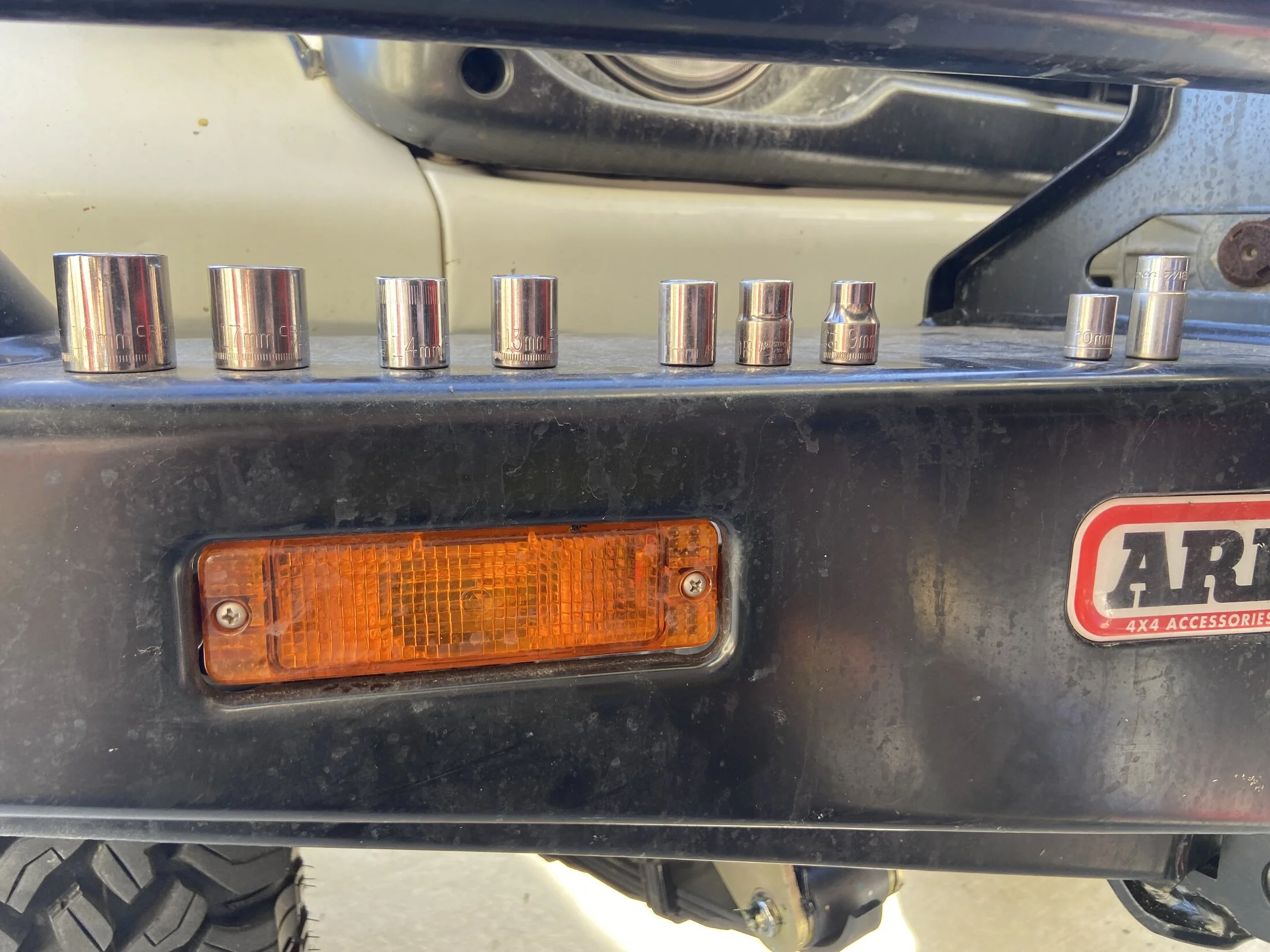

Also managed to pick up some USA made sockets for 5 bucks.
Craftsman USA: 19, 17, 14, 13, 9
Armstrong: 11, 10
A random 10mm with no markings
And my first ever Snap-On item, a 1/4 drive 7/16 socket that I bought just because 🤣

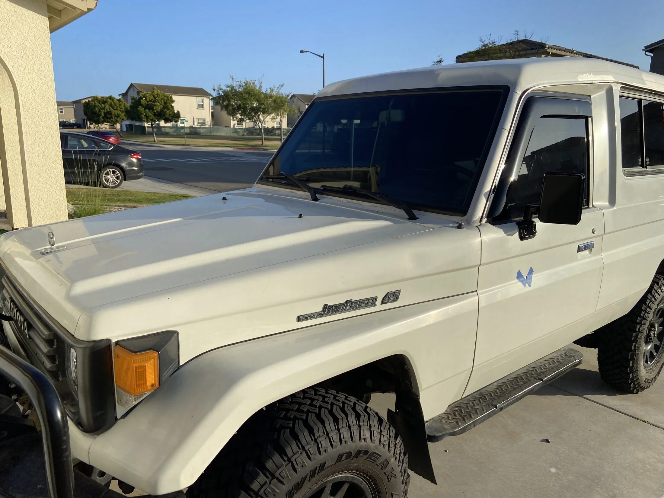

In preparation for living in the Mojave desert for the next couple of years had ceramic tint installed on the troopy.
Blocks the heat, but now also has blacked out my cargo area so fewer peeping eyes.

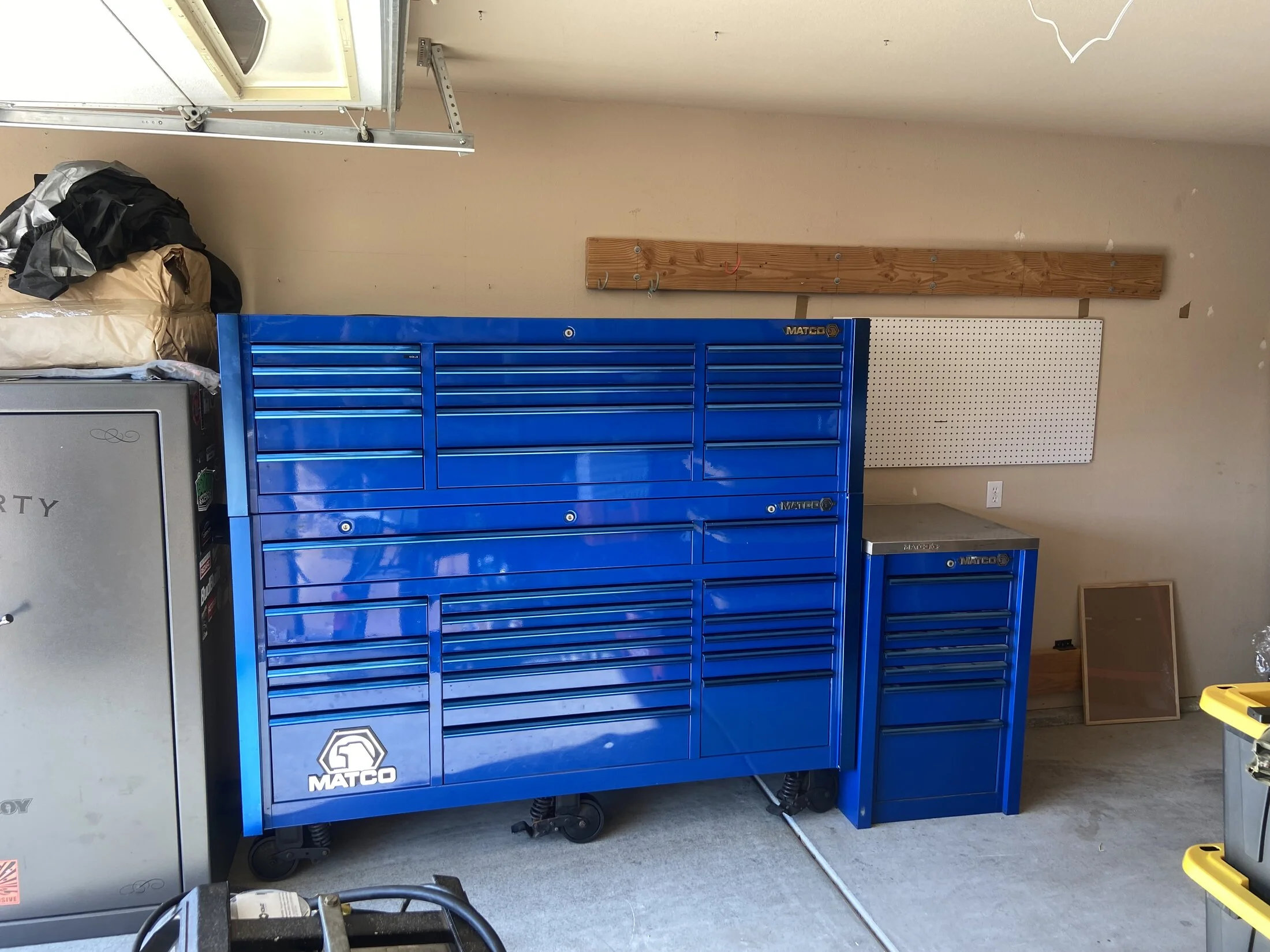

Picked up this toolbox and locker before I moved up to the desert. Should be able to put all my tools, electrical stuff, and everything else into this box instead of having it strewn all over my garage like my last house!

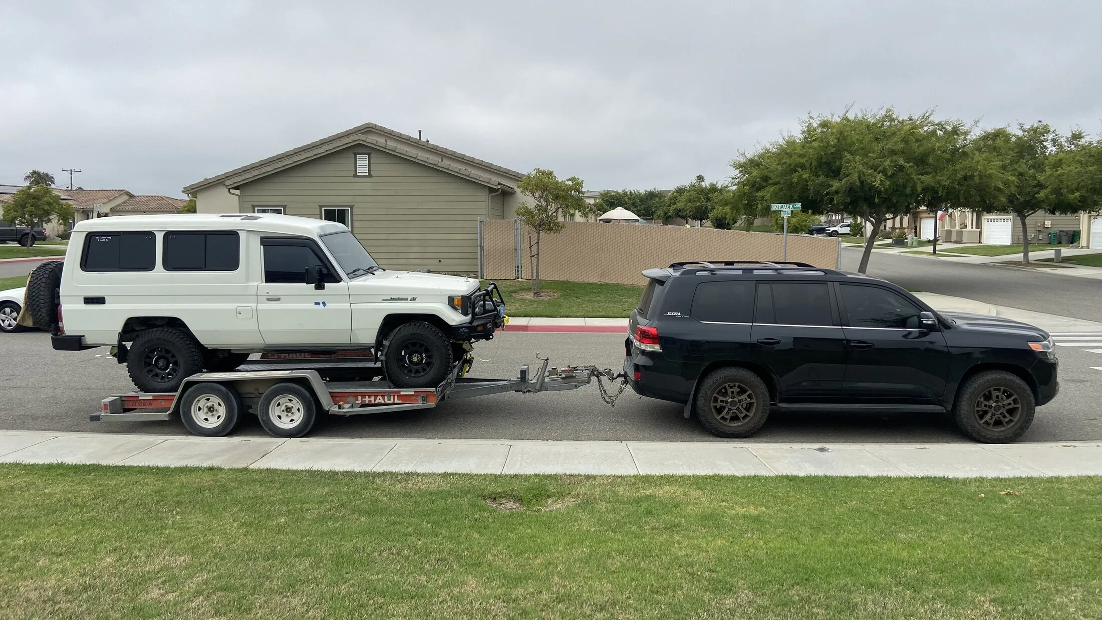

Towing from Camp Pendleton up to Twentynine Palms was miserable. Max speed of 55 otherwise the trailer started to sway way more than I was comfortable with.

I hope you got a brake controller on that 2 hundy ... thinking a uhaul + troppy is a wee bit more than they are rated to tow
Absolutely have a RedArc tow controller.
Troopy weighs I'm guessing around 6,000 lbs (I need to put this on a scale here soon), the trailer another 2,000. So right at the limit of their 8500 rating I'd say.
As a point of reference, I weighed my troopy recently at the trash scales and came out right around 5500 lbs. That’s with front and rear HD bump, pop top, and empty interior.
