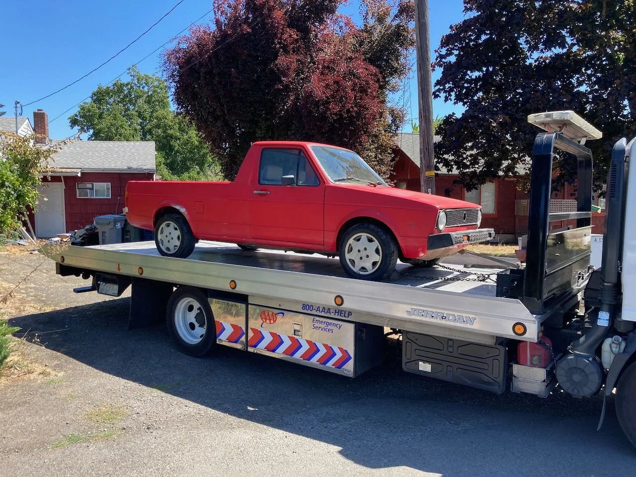

Newest project...
Yes, a German "pickup" (so to speak). Actually built in Pennsylvania. Not as slow as it looks, this one has been "refreshed" with a '92 GTI 2.0L 16v twin cam motor, connected to a very close-ratio 5 speed. It will be a very quick little bunny.
Cool. If there isn't a "I hate coyotes" web site, post a few pics here.
Still debugging the Motronic injection, problems from sitting too long, as well as ill-advised tampering by the PO. It runs, and shows promise as being really quick. But it doesn't run right yet. Awaiting some additional parts for that now.

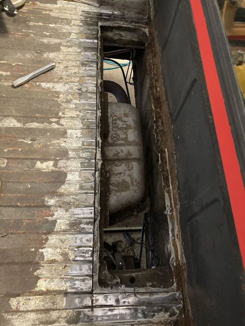

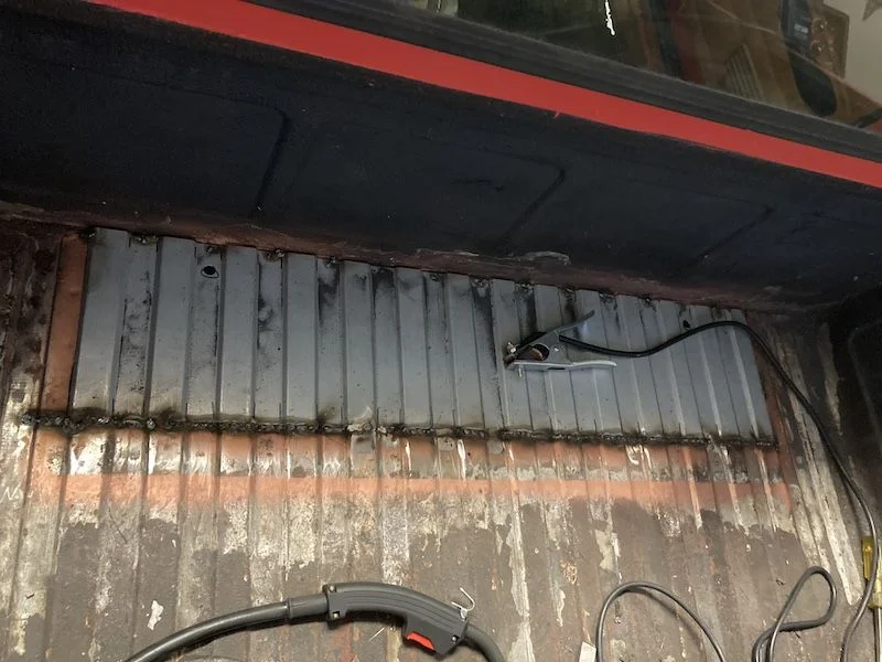

And now the rust exploration has begun, pictured below is the back half of the passenger floor pan. Rust is present, but not horrible. Better than I feared.
Will be expanding my work to a new area on this one, as I plan to tackle the rust repair myself. New MIG welder should be delivered any day now.

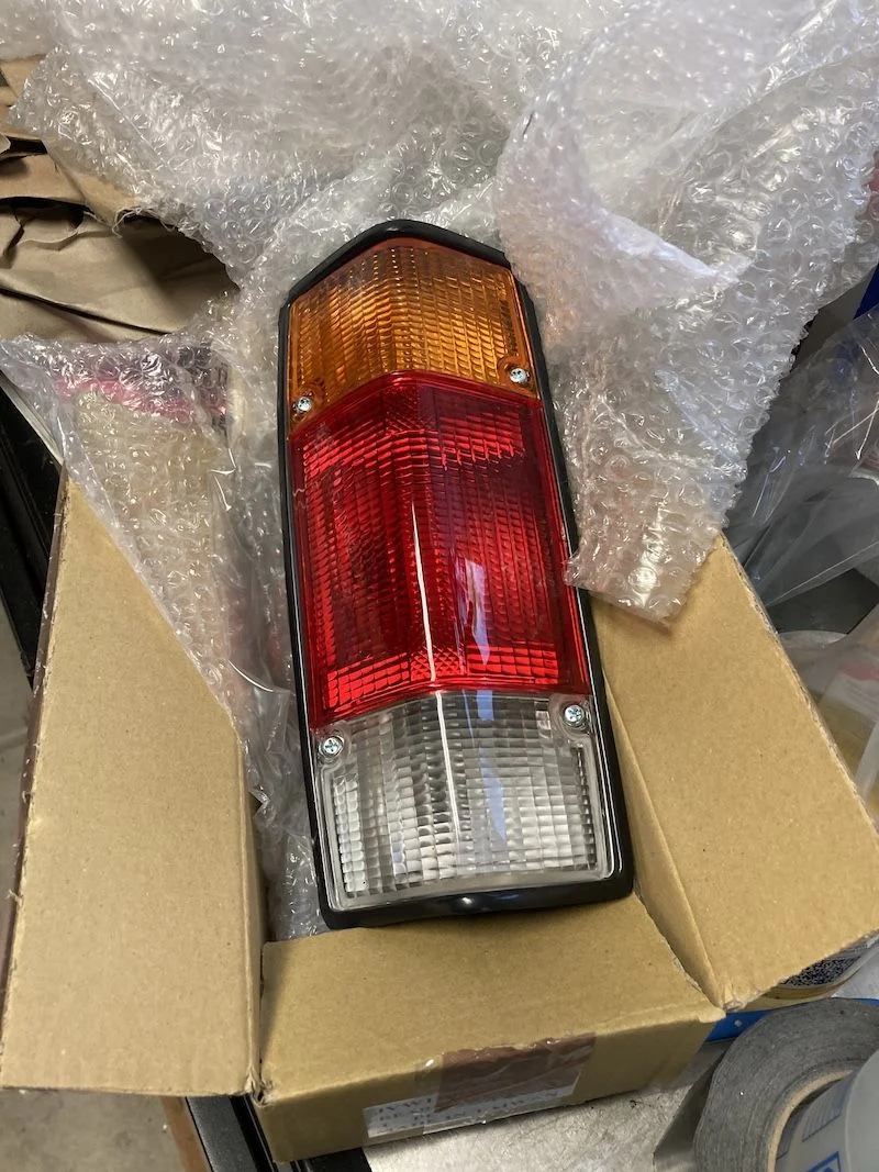

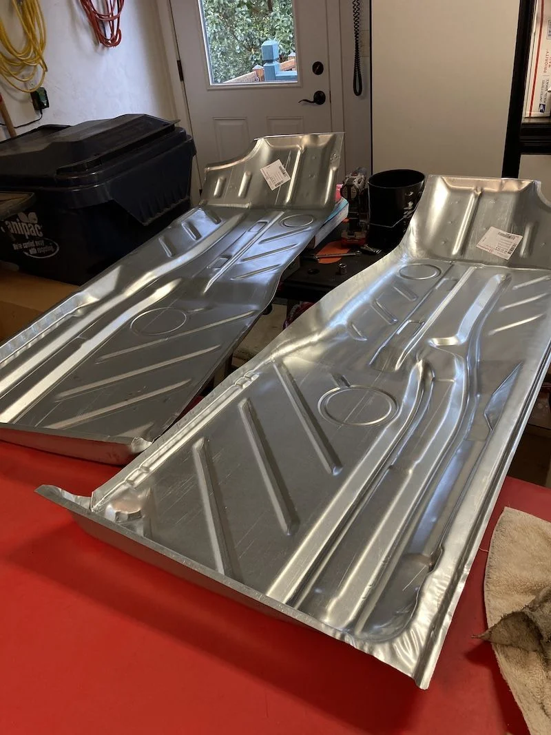

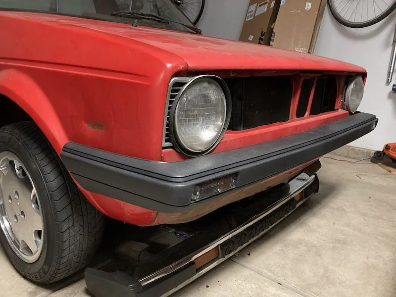

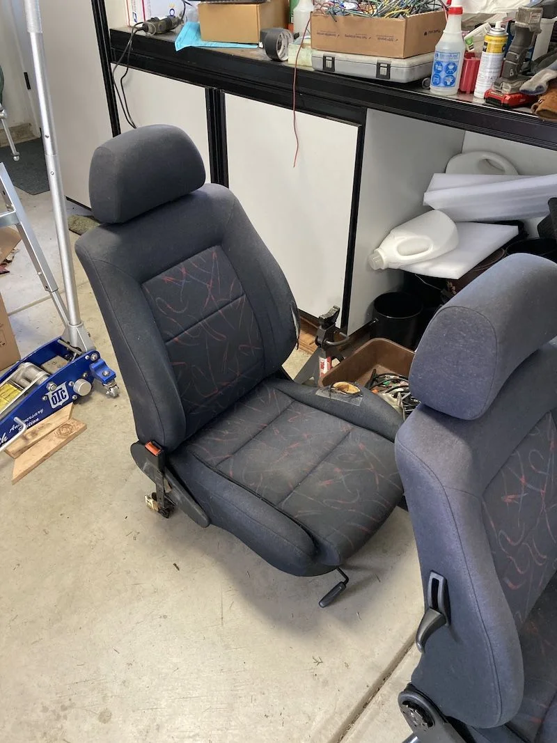

First, new MIG welder arrived. And then several boxes of parts, many from the UK. Notable bits include a new stainless header (found some nasty stress cracks in the one the truck came with), tail lights, rust repair panels, front bumper, seats, exterior trim, mirrors, seals, etc.
Rust repair is proceeding.

Welcome to the world of body repair Arne. Great job!
