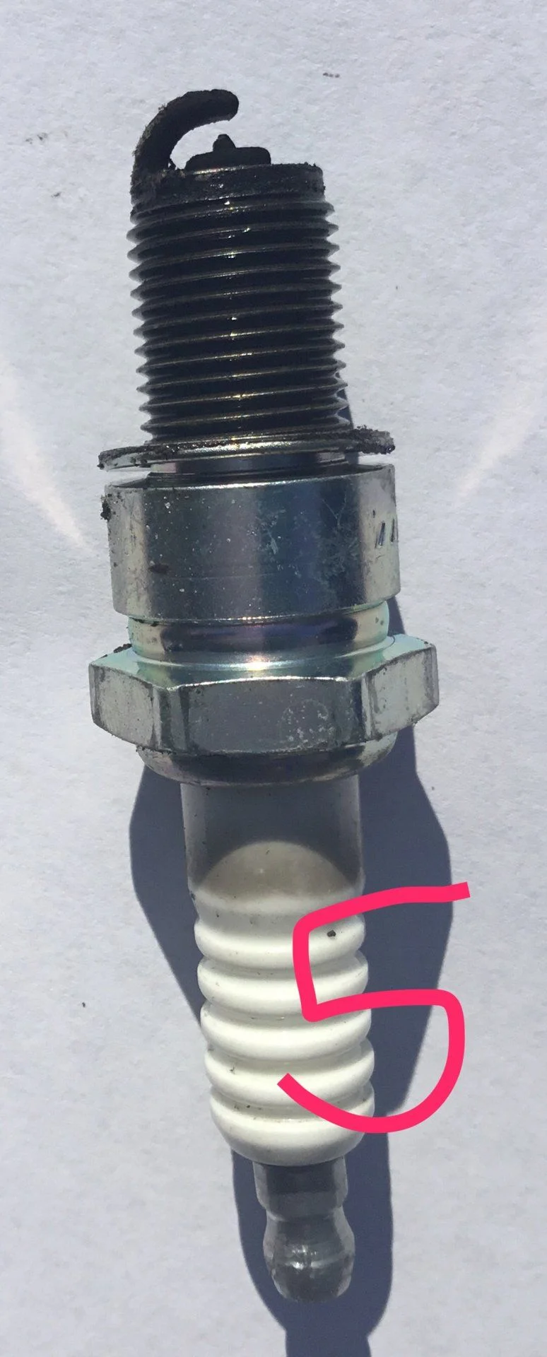

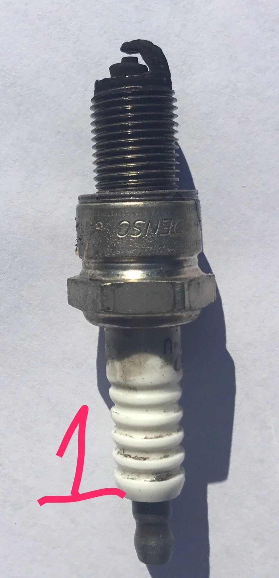

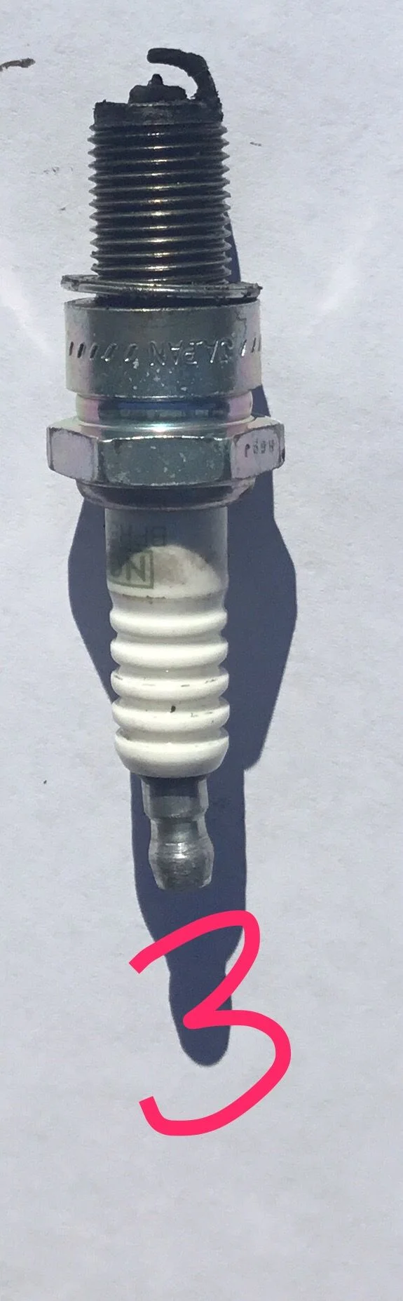

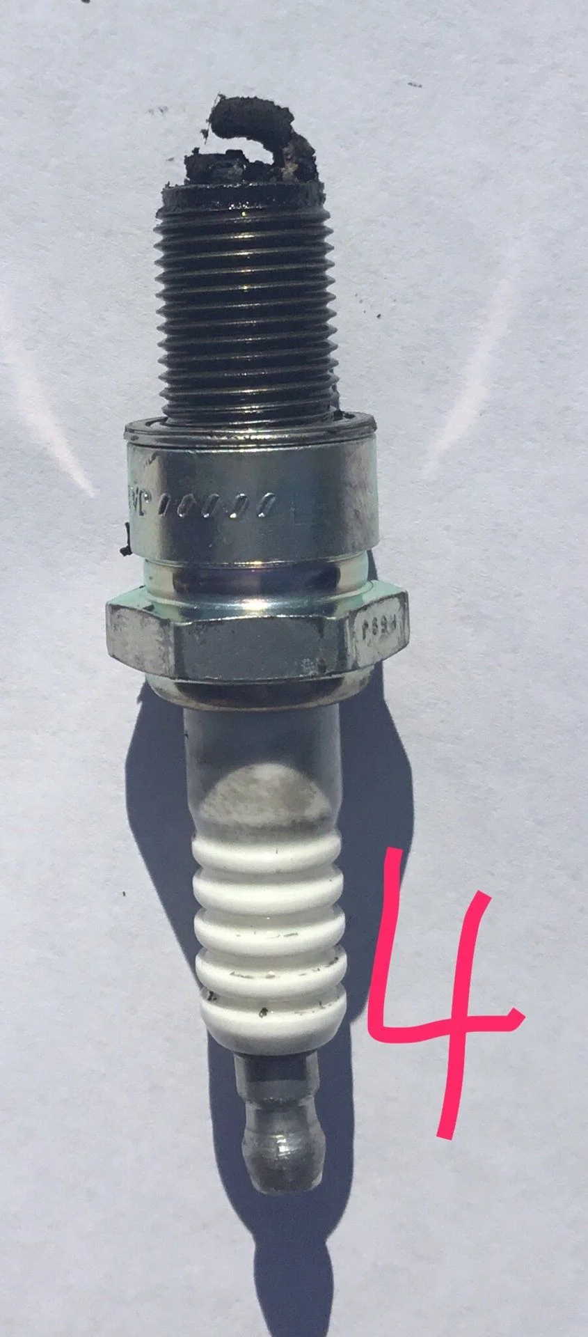

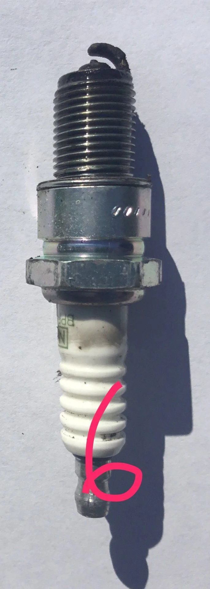

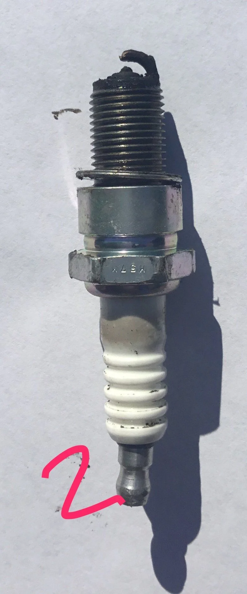

Here is a close up picture of each plug. You can definitely see some fouling happening. Mostly at #4. The others have a good bit of soot build up and some wetness around them.
All look pretty clumpy. Know anyone who can do an actual leakdown test?
Add all new and check in a few weeks?
What about the air cleaner? Any oil residue in it?
Maybe add a pan under the Oil plug so you can see the condition of the oil to get a better idea that there isn’t coolant in it? Or better yet send off a sample to blackcreek or whatever that testing place is called.
My readings were high like those other than 2 & 5 being around 140. Could def be valve seals. They CAN be done on the truck. Tricky but they’re is a shade tree method to doing them....

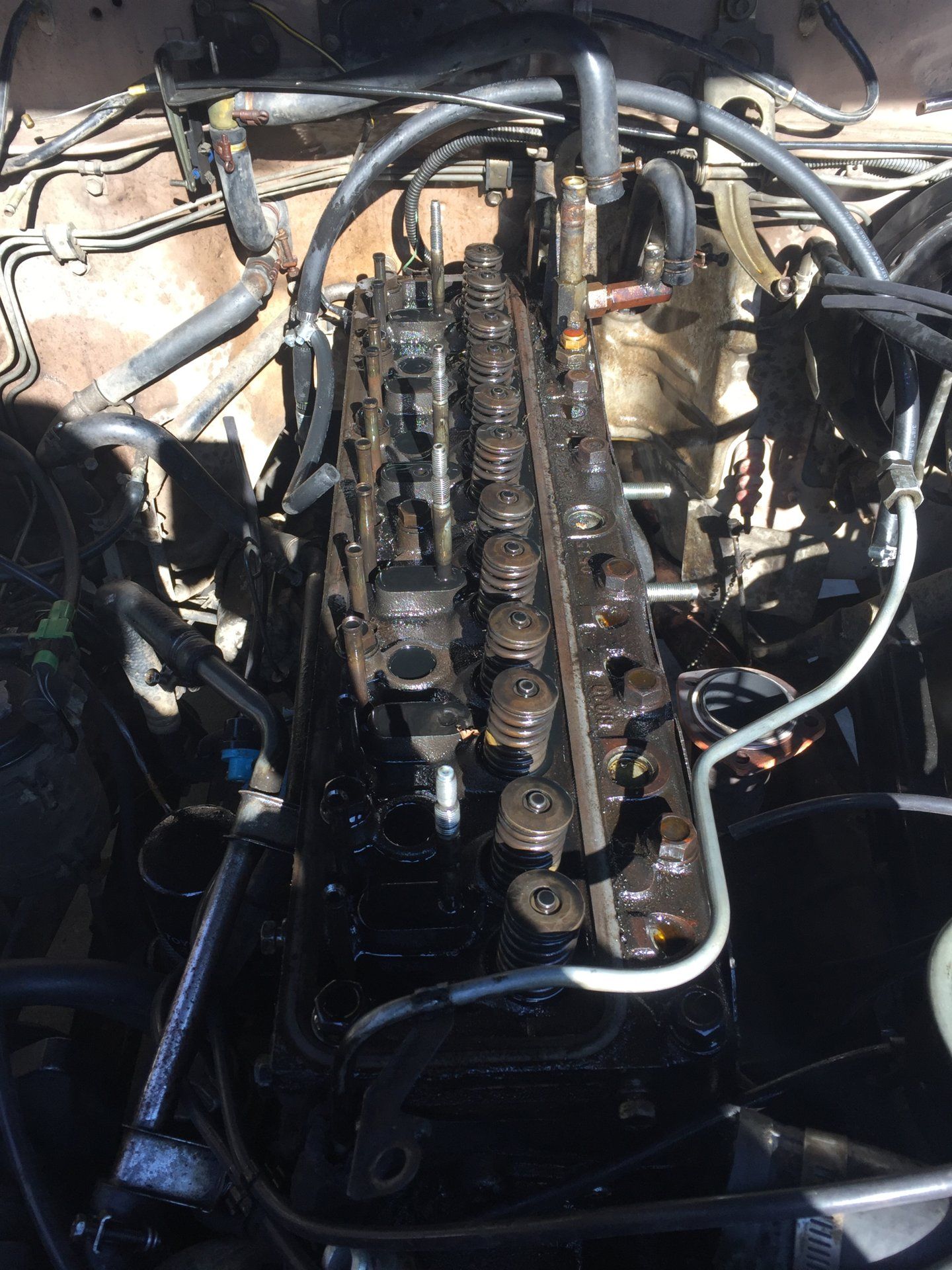

So.... I decided it was time to rebuild my head. And while I was in there decided to send my carb to Jim C for a rebuild and my dizzy for a recurve. Oh and replace all of the hoses and thermostat. You know... while your in there!
This was the first head rebuild I had attempted. I was confident that I was getting in over my head but with the help of the FSM, MUD and some good friends I made it through.
Somehow I forgot to snap a picture of my newly rebuilt head before I put it back on but she went back on perfectly without a hitch.
I read a lot about people throwing their backs out trying to pick it up by themselves. So I rigged a long pole with ratch straps that went over the pole to both ends of the head. My 14 year old daughter grabbed one end and I grabbed the other. We slowly pulled it up and were able to get it out of the truck without a problem.
The only challenge with that method is balancing the head on the pole. If I did it again I would have one more person in the middle that just kept the head from leaning one way or the other.

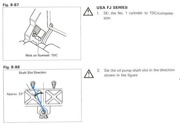

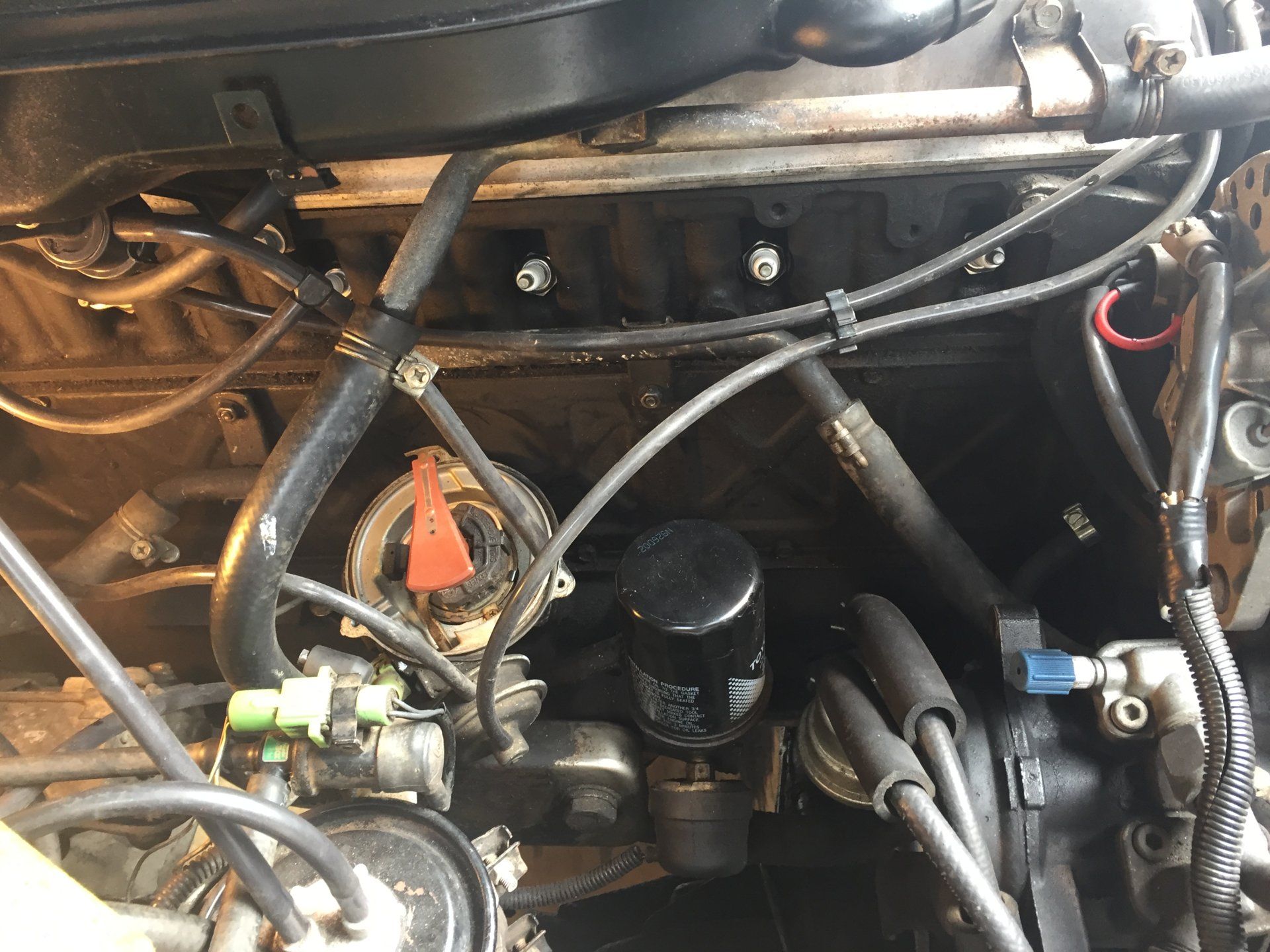

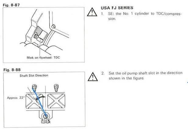

Before I pulled the dizzy out I set the truck at TDC. This way I could drop it right back in per the FSM.
This turned out to be the hardest part of this entire job! I could not get the dizzy set in there for the life of me! I thought I must have done something terribly wrong with the head because the truck just wouldn’t start.
However, after reading MUD for hours and trying a lot of different things I noticed that when my dizzy was placed in the truck and fully advanced I could get the truck to start. It didn’t run well but it would start and that was a sign.
I decided that I must be off by one tooth like I read so many times on MUD. But looking at the FSM I had it right. You can see the markup I put on the picture of the FSM. If Toyota asked me... and they are not.... I would draw the line a little to the right like I did in this picture.
I finally adjusted the dizzy advanced one tooth and she cranked.

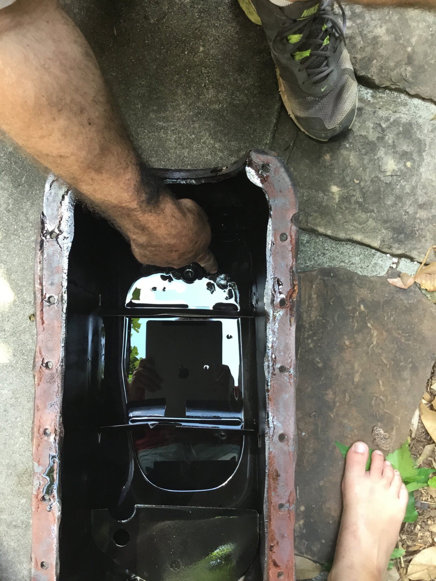

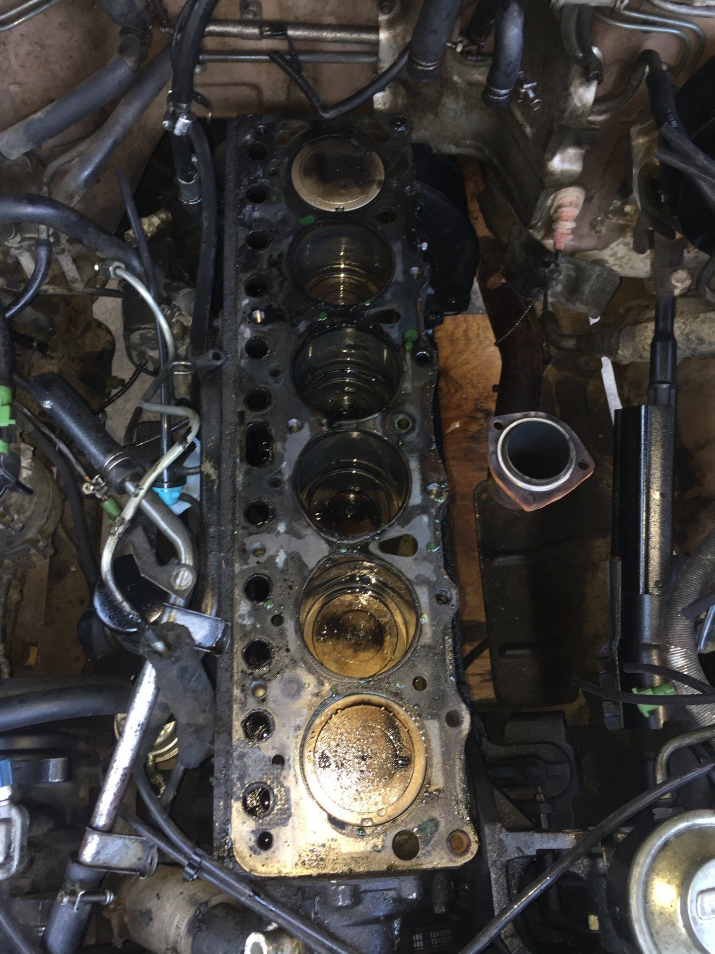

So.... I brought the truck back home and that brings me to today. It’s time to do a little diagnosis of my own and see what I can find out. I’m going to pull the oil pan and see if I find metal shavings. If so I’ll pull the rod bearing caps and see what I can find.
I’ll keep you posted and need your help throughout the journey! Thanks MUD!

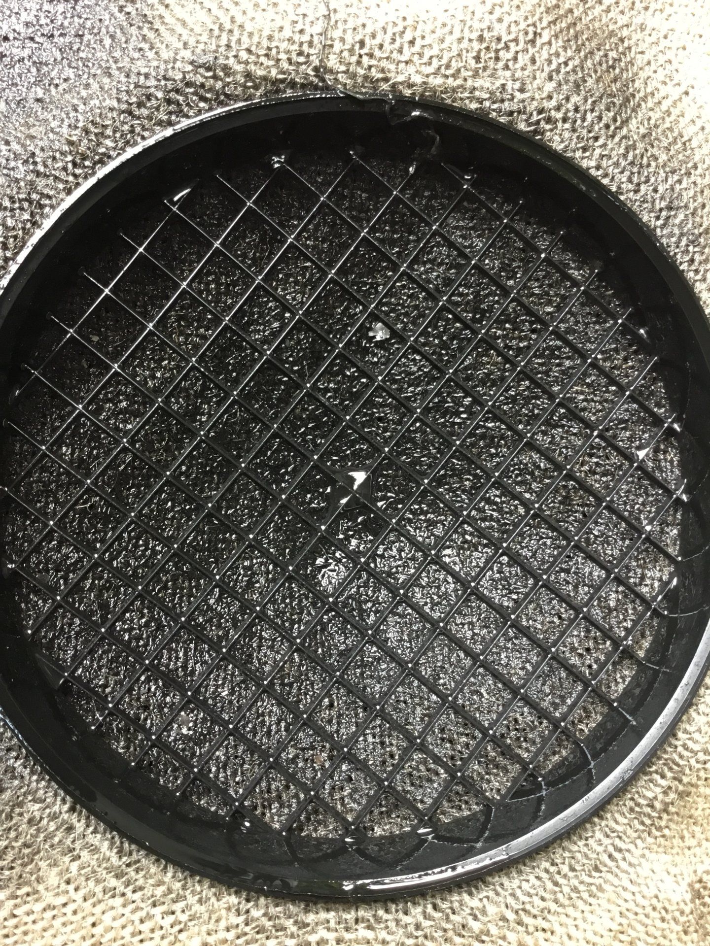

Ok here’s the update from today...

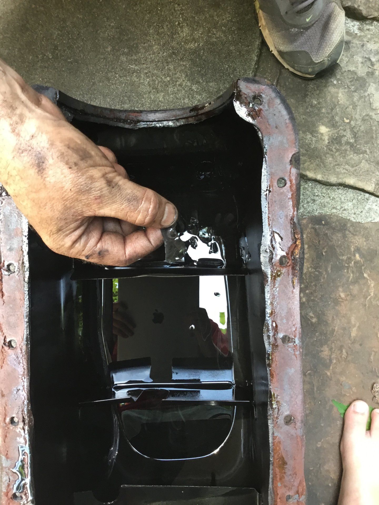

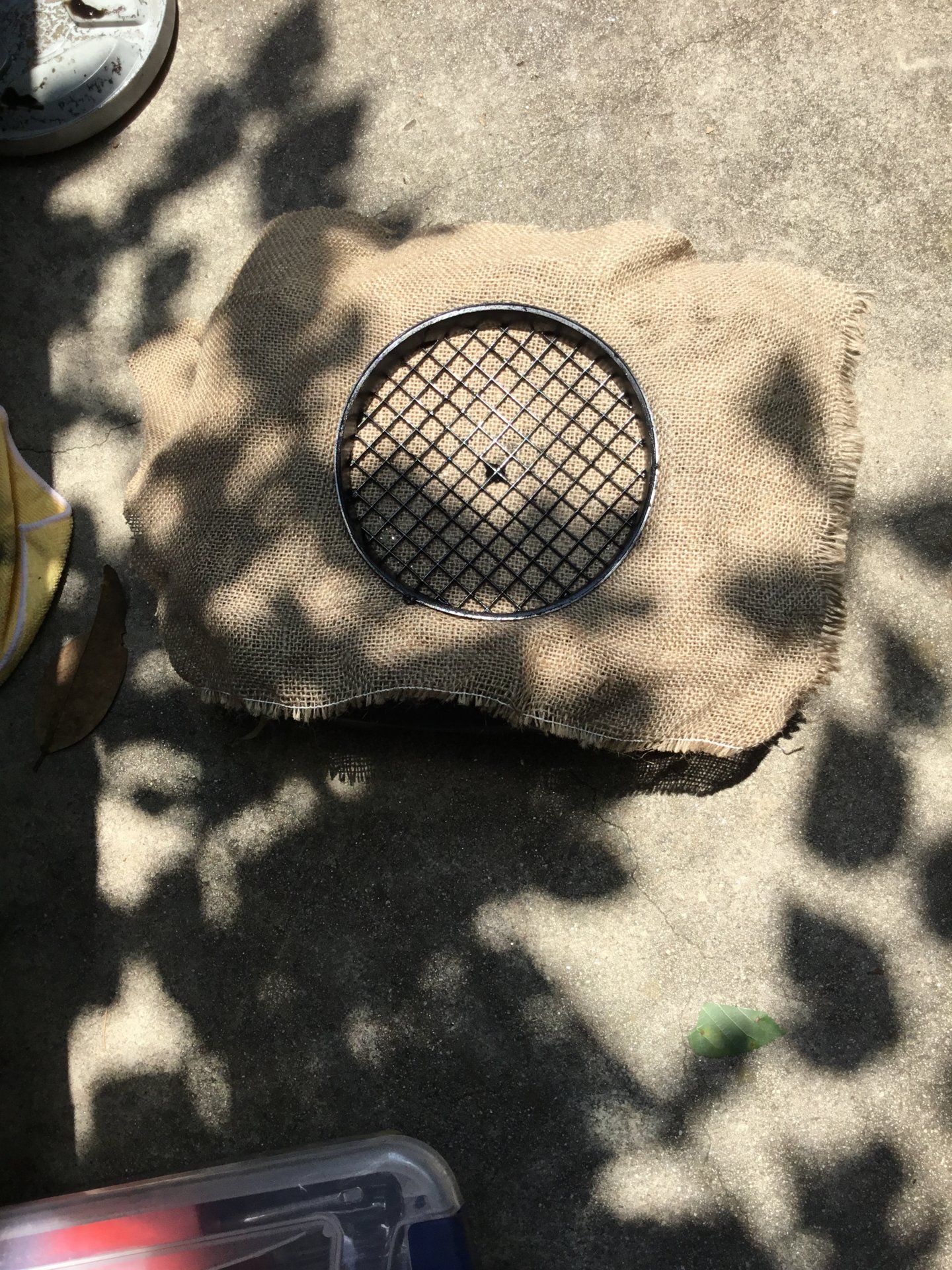

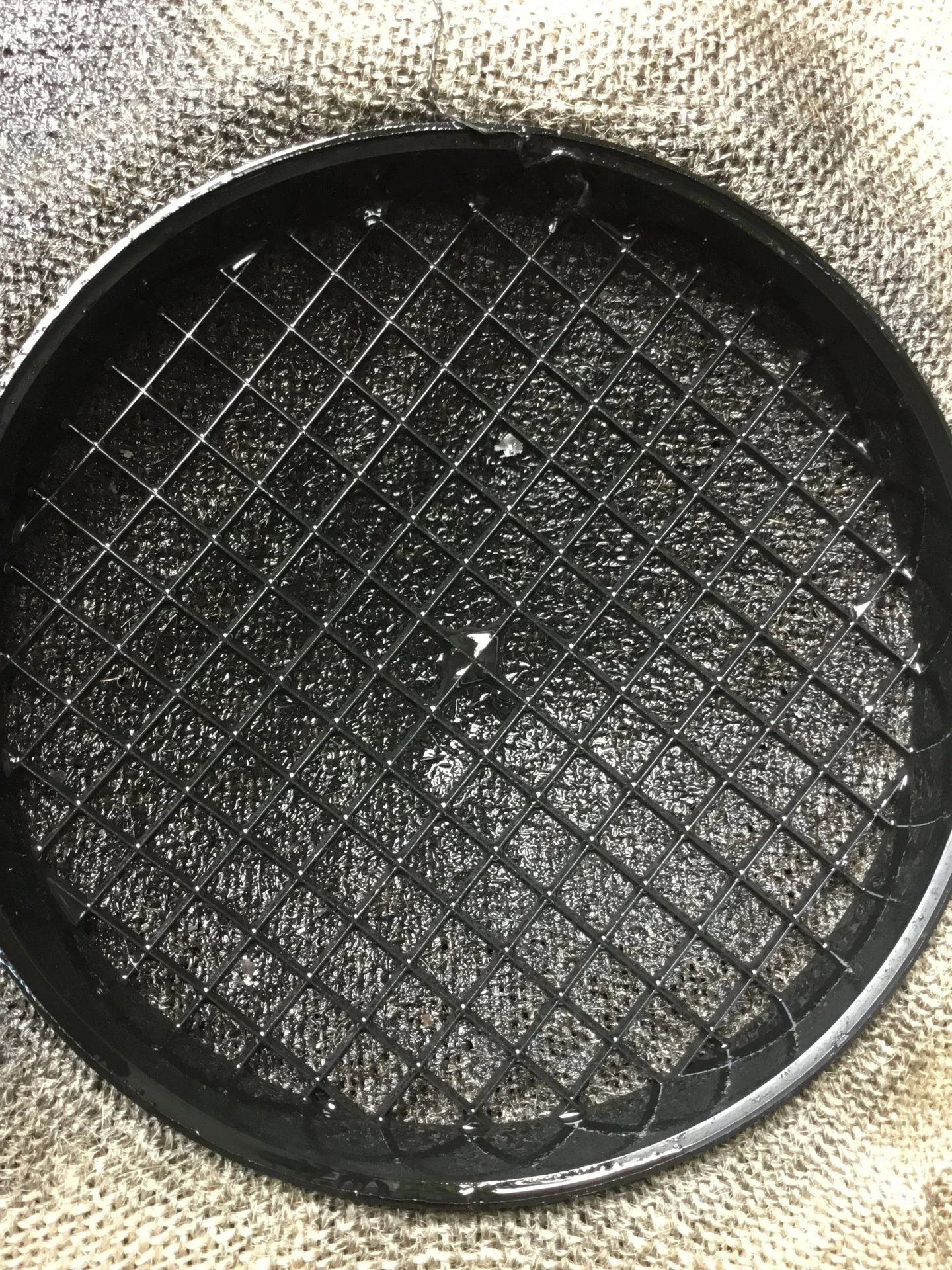

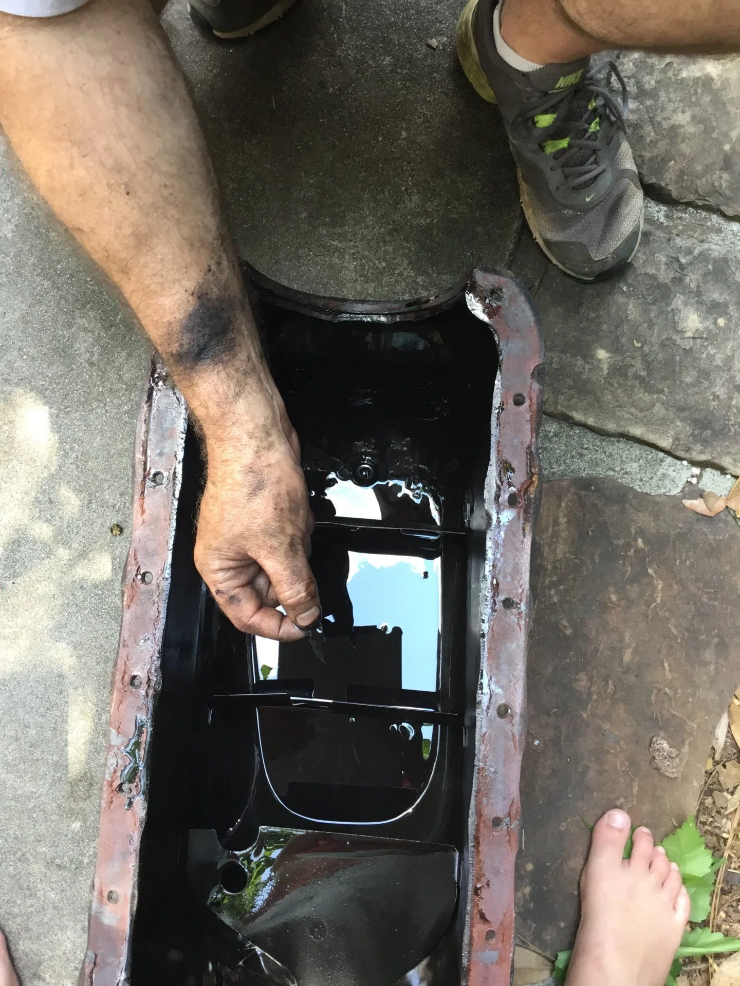

I wanted to confirm that I did spin a bearing as I was told so first I drained the oil. I used a burlap cloth as a screen to pick up any metal pieces.
I didn’t see anything that stood out to me. But then I looked closer and saw two very small flakes of shiny metal. Not good!
