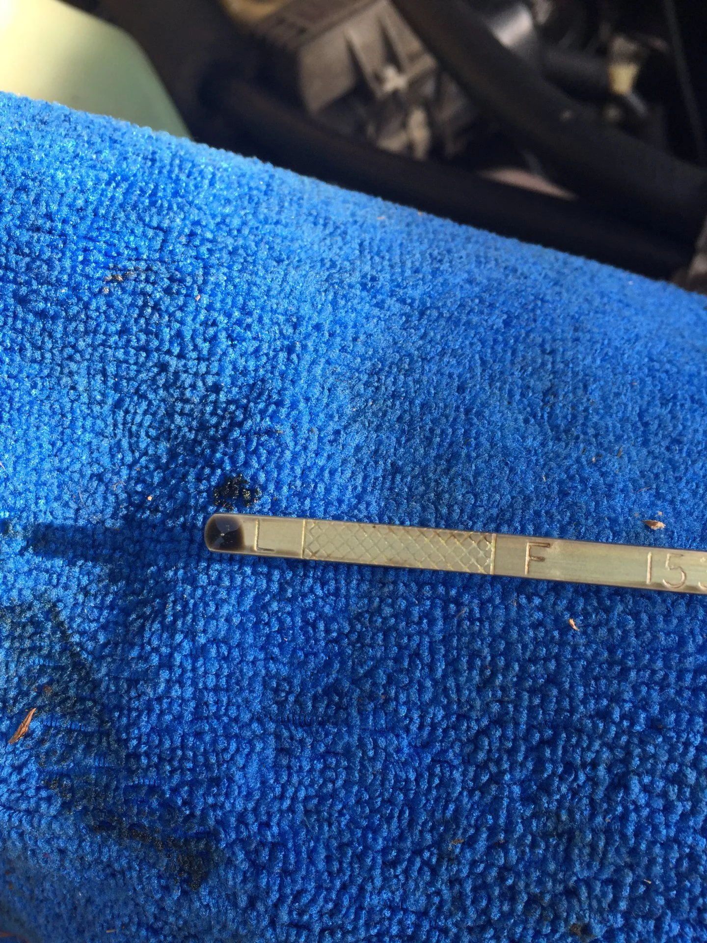

Here's a bit more info. I checked the oil level this morning after warming the engine up. I drove it about 180 miles yesterday and it was full of oil before I started. You can see it is really low now after just 180 miles. I added two quarts to fill it up.

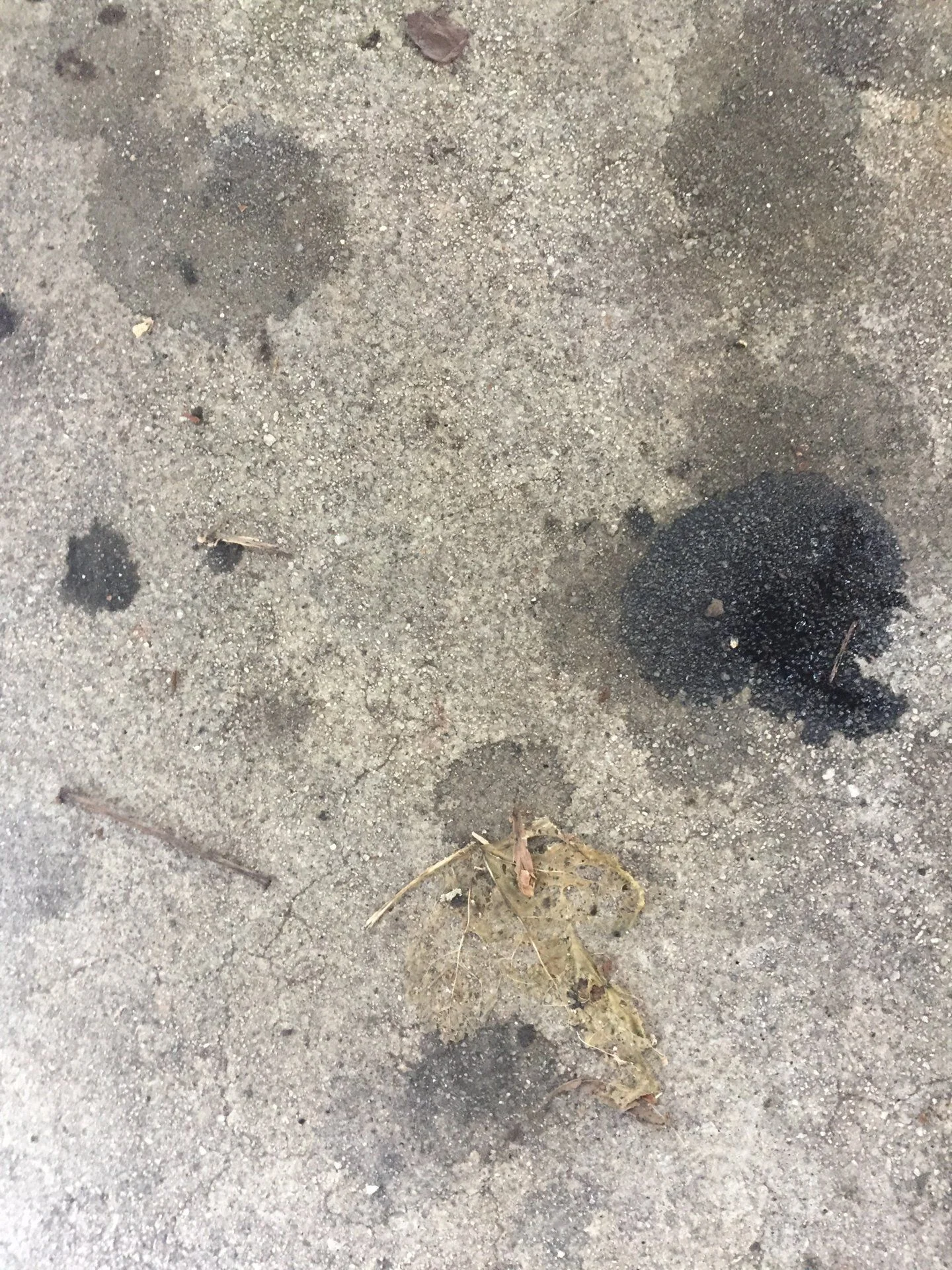

I checked underneath again and I do have a leak. The good news it is not from the oil pan gasket. It is from the oil pan plug. It is was leaking before so I replaced the gasket around the plug. That hasn't done the trick so I will probably get a new plug.
Regardless I don't think I'm losing all of this oil there.

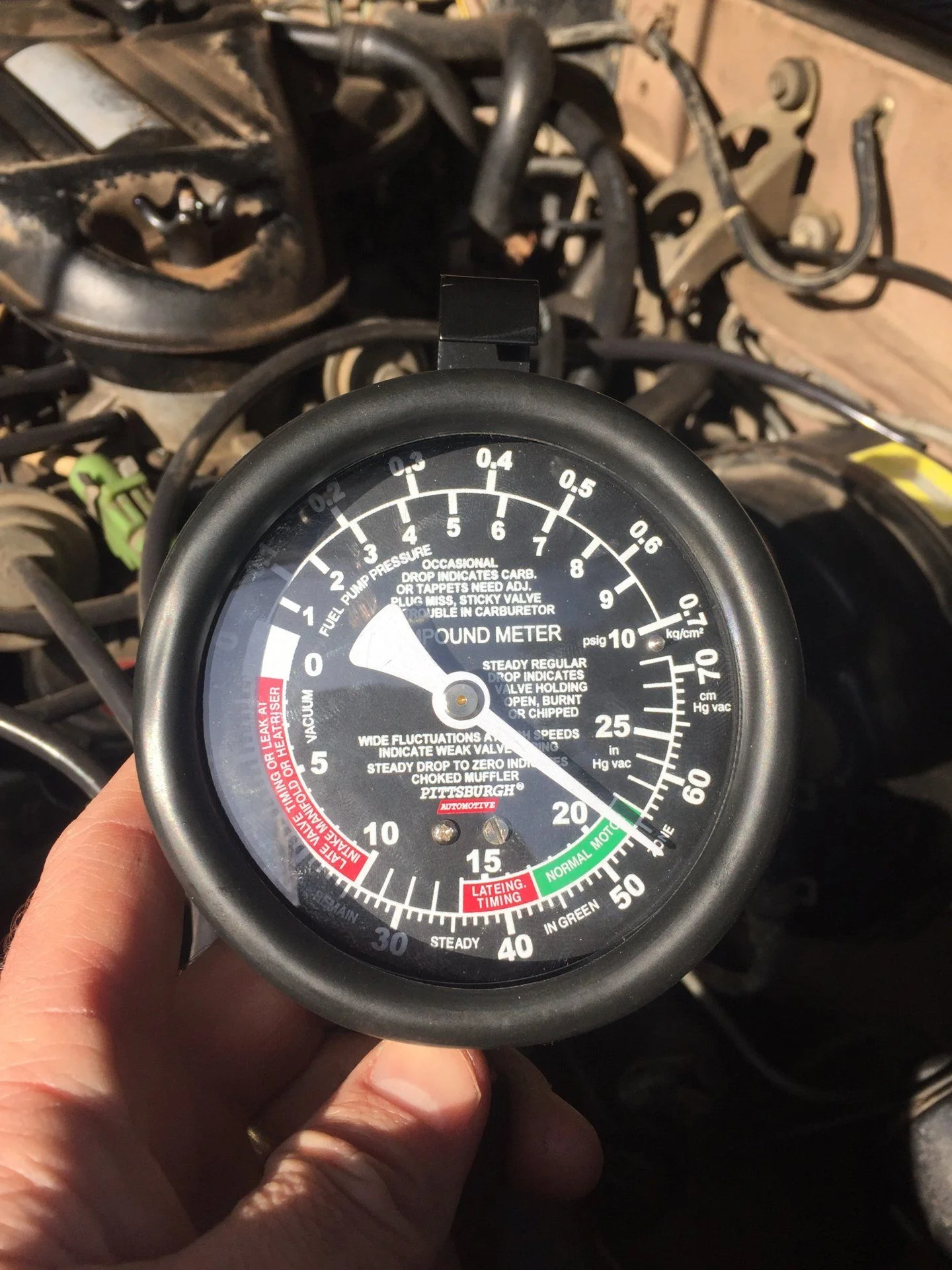

Vacuum reading is from the "thingy" ( I can't remember the name for the life of me!) that is on top of the intake manifold near the engine bay. There are two openings on top and I attach to the smaller one. I've done it here before several times and haven't had trouble with it.

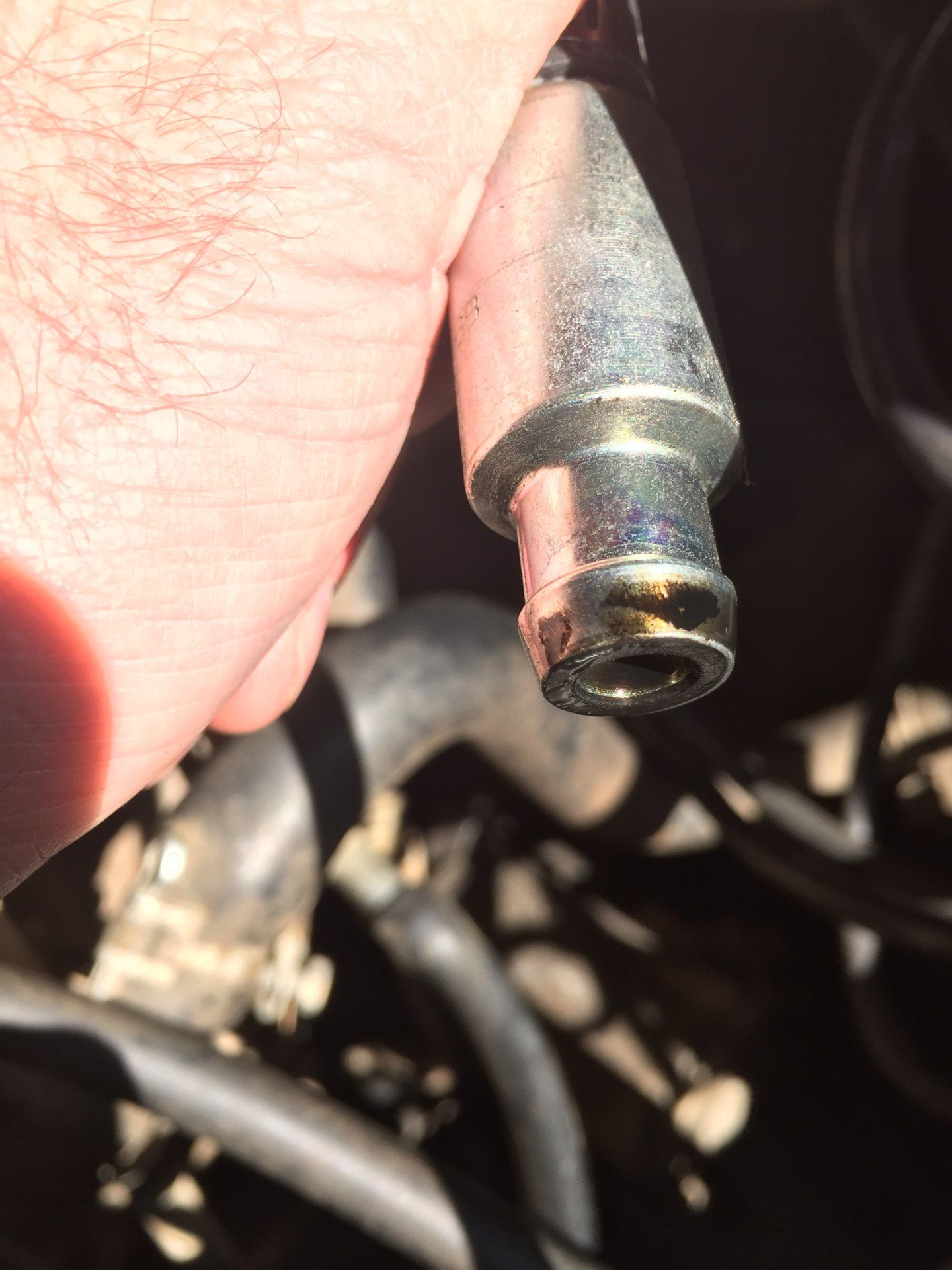

I replaced the PCV valve with an OEM one less than 800 miles ago. The old one was not OEM and was making a lot of strange noises. I don't think it is a problem but I can do a quick check and see if it is rattling.

PCV sounds fine when i shake it. I can hear the ball rattling.
