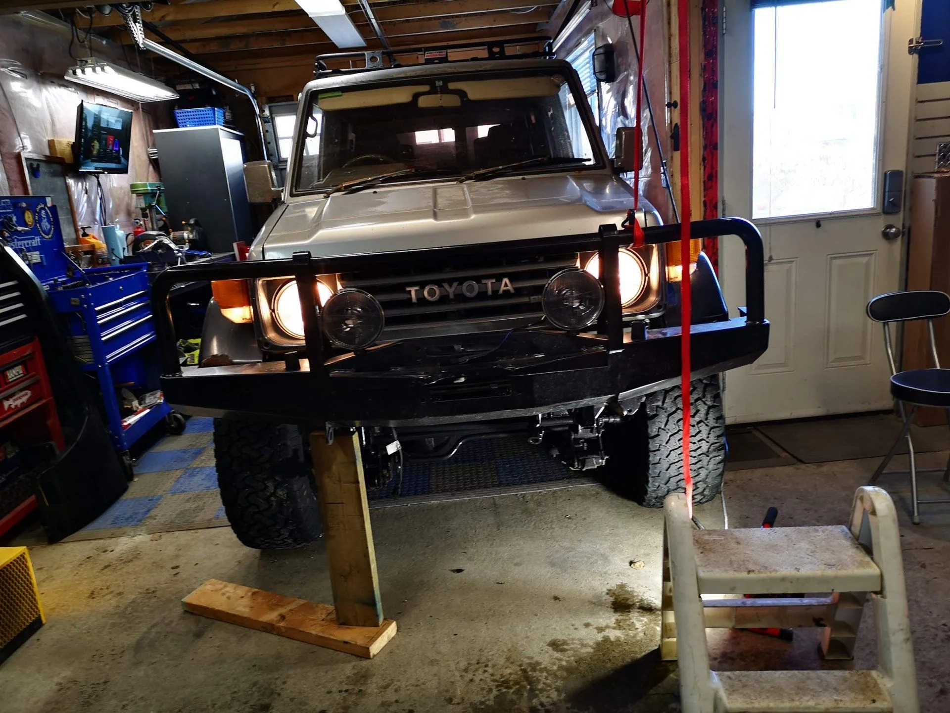

Well, yesterday we decided to offer up a Range Rover Classic ARB bumper to see how close it was.
Unfortunately, "not very". The uprights are 1/3 of the way into the lights, the mounts would need customizing. The factory winch would be practically entirely below the bumper. If some parts of it lined up, we might have started cutting, but it is so far off that I don't think it's worth the effort. I really really want a proper 70 series ARB but budget is not there yet, esp in light of the body work that I still have to do.
This was simply a whim, since we had the bumper... so back to the more pressing issues.

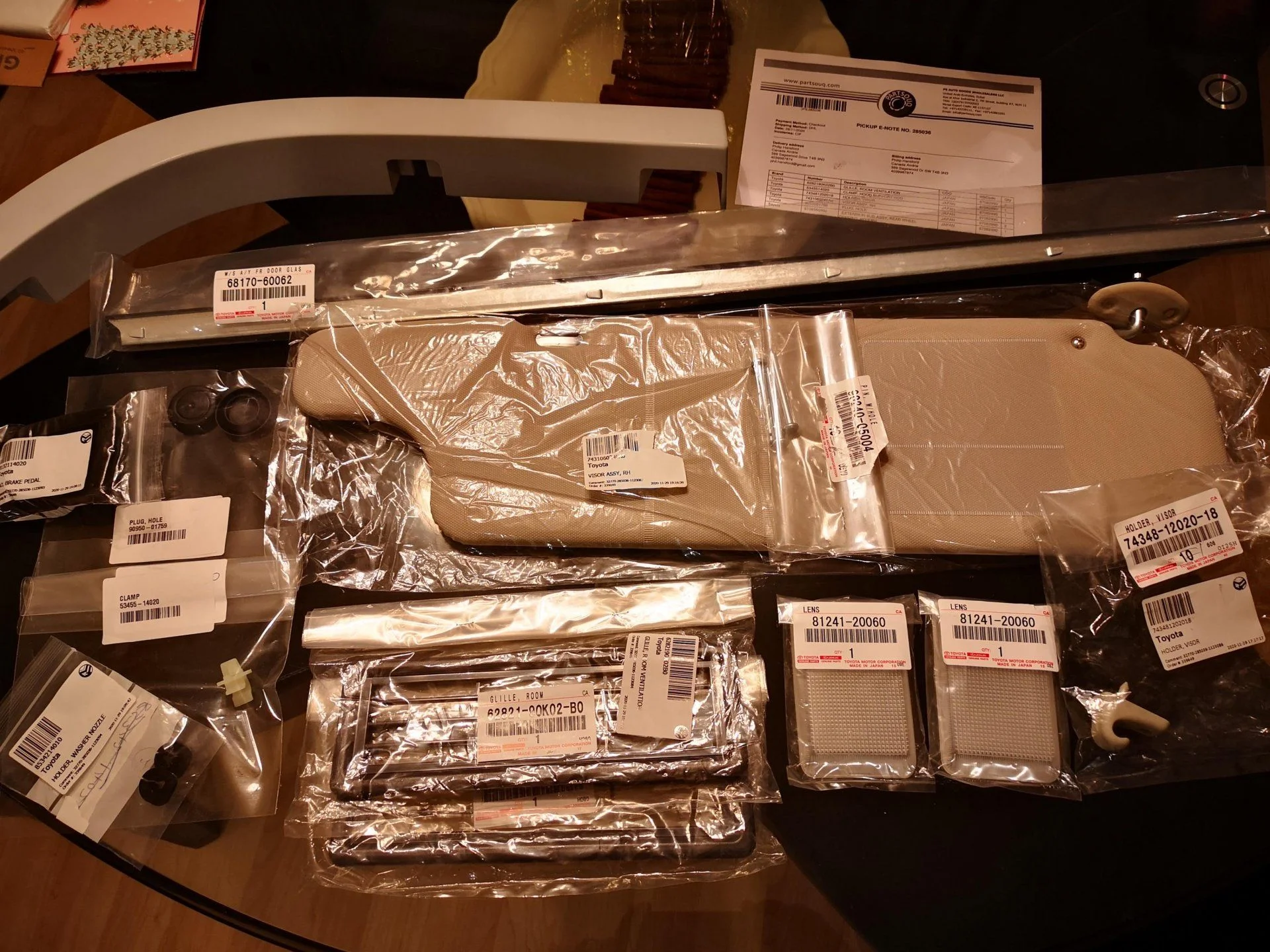

This one is mostly interior bits... Replacement pedal pads, new drivers side sunvisor and clip, hood prop rod stay, interior window gasket, interior rear grilles, dome light diffusers....
Plus... New fender flare for right rear to replace one that was cracked/repaired long before I got the truck.
None of this was essential but does a nice job of sprucing up what was already a tidy interior.

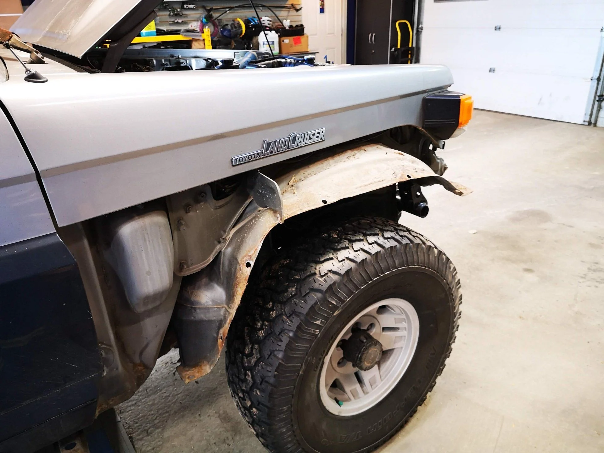

Old lowers are now removed. Not a huge amount of fun. Wheel wells are in great shape. Some surface rust but solid underneath. Hit it with a flap disc and down to bare metal quickly. Just need to wipe down the rust dust now and then paint, before installing my factory fresh new fenders.

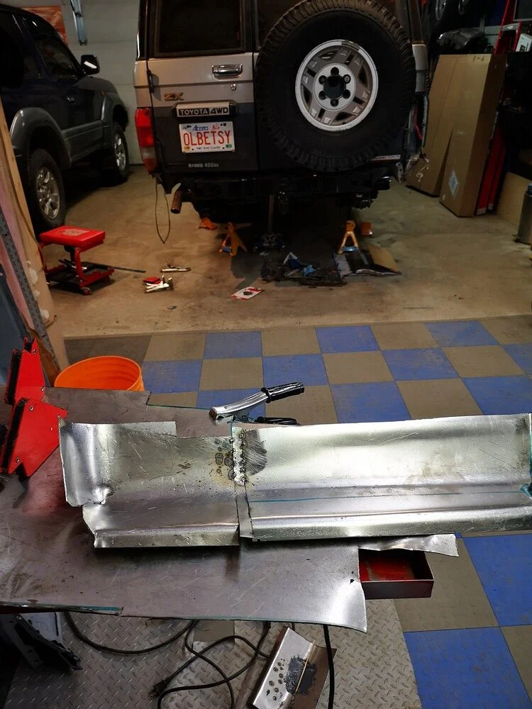

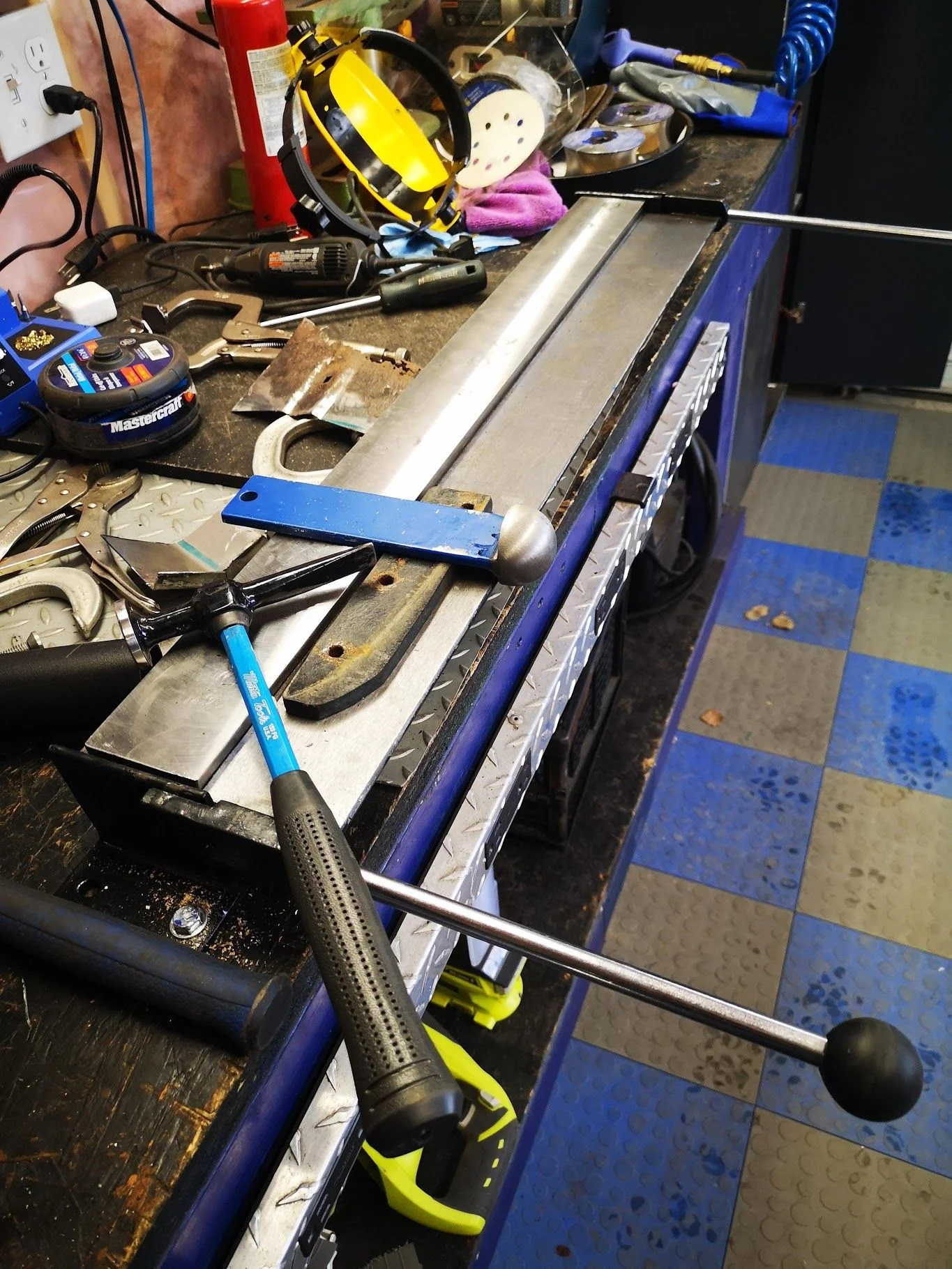

First I had to get some tools...
Then it was time to start practicing forming panels...
Bear in mind this is not my dayjob, and I am a complete neophyte in bodywork. Goal was to keep away from fibreglass etc, and replace metal with metal. Longevity trumps pretty.

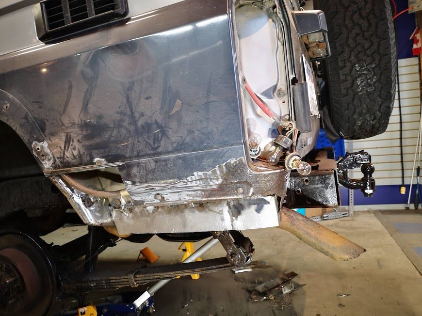

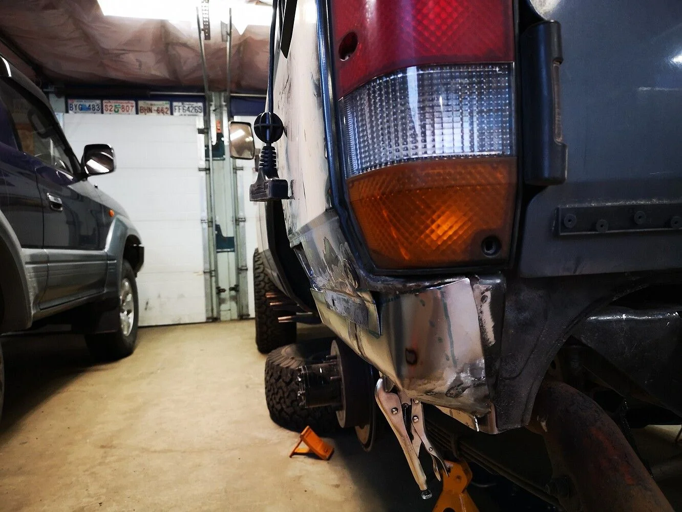

Here's my first attempt at a corner. Mig welder with flux core wire certainly takes practice, and I've burned through a lot of wire.
And once mated to piece number two, I tried mocking it in place. Not bad for a first attempt. Much more massaging to come on this one., before it is put in place for good... but call it a good start?

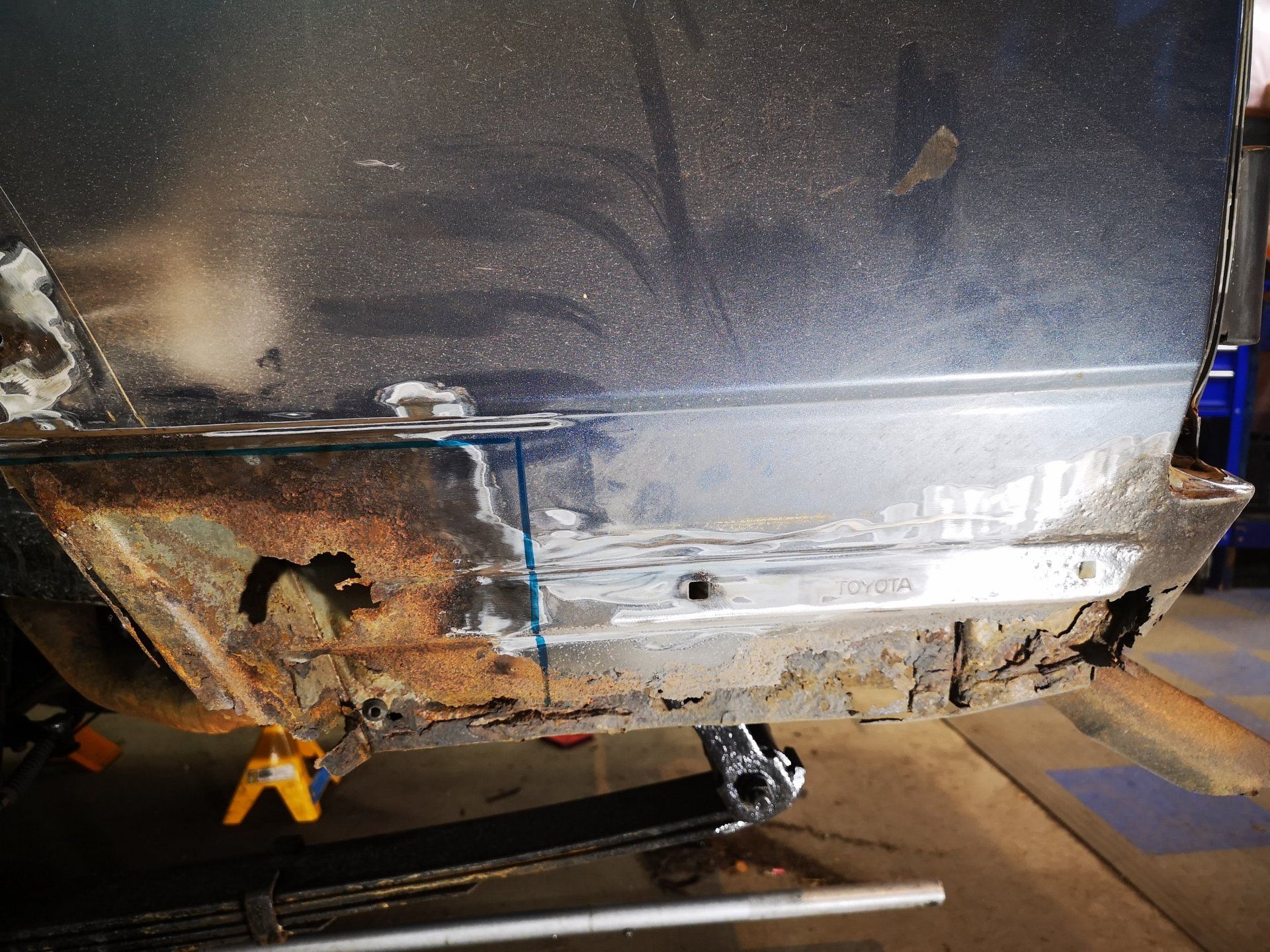

But.. that was the "good side". So here we go, to the hard part. If rust makes you squeamish, cover your eyes...
Next up, we'll cut this out, and see what needs to be done underneath...

Really not bad for first time my man. 👍
You want some tips, I bet you do! 😉
Get off that flux core wire first and get on some gas. You will not regret that. Jump on the Eastwood website, for not a lot of cash you can get a bench top brake and several other tools that will help you a lot. I am sure you have noticed, Toyota used a lot of seam sealer on panels. Go to your local automotive paint supply shop and get SEM seam sealer in tan, it’s almost the exact same as Toyota used. POR15 or anything similar on any rust, the idea is to encapsulate the rust. I never have had any luck with “rust converters”. You can also use weld through primer which you can get from the auto paint shop. They are also usually helpful and willing to give advice in those stores.
*edit: never mind I see you got a brake. I got old eyes and short attention span. 🤗
Good for you for going for it!
Cheers
Thanks for the encouragement, Ian. And the tips. Much appreciated. Since I'm just getting caught up with my progress, some of your tips are coming post-process, but that's still helpful since in some cases it reinforces some of the things I did. In others, it'll be advice for next time.

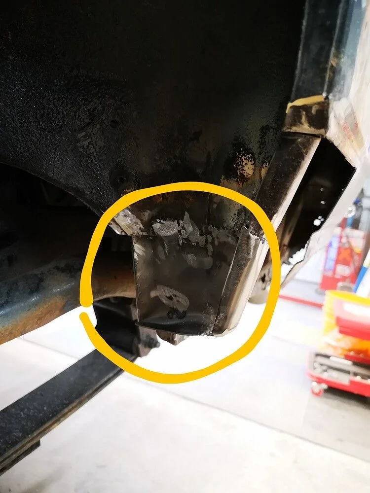

So I was about to get into the LHS (I won't say "driver's side" because JDM yo, but it sure does mess people up in Moab when they're trying to spot you through an obstacle, and they yell "drivers! No.. passengers! No LEFT! So funny!) Where was I? Oh right, driver's side... or is it left? :D

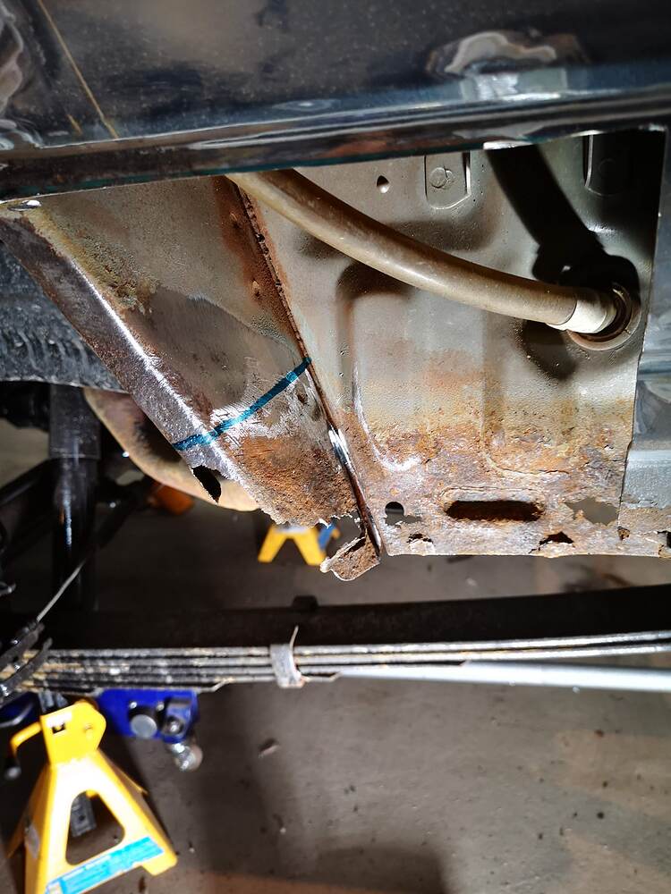

I could see before I even cut the outer, that the inner had been impacted on this side as well. And the lower wheelwell too. Some reconstructive surgery was in order.

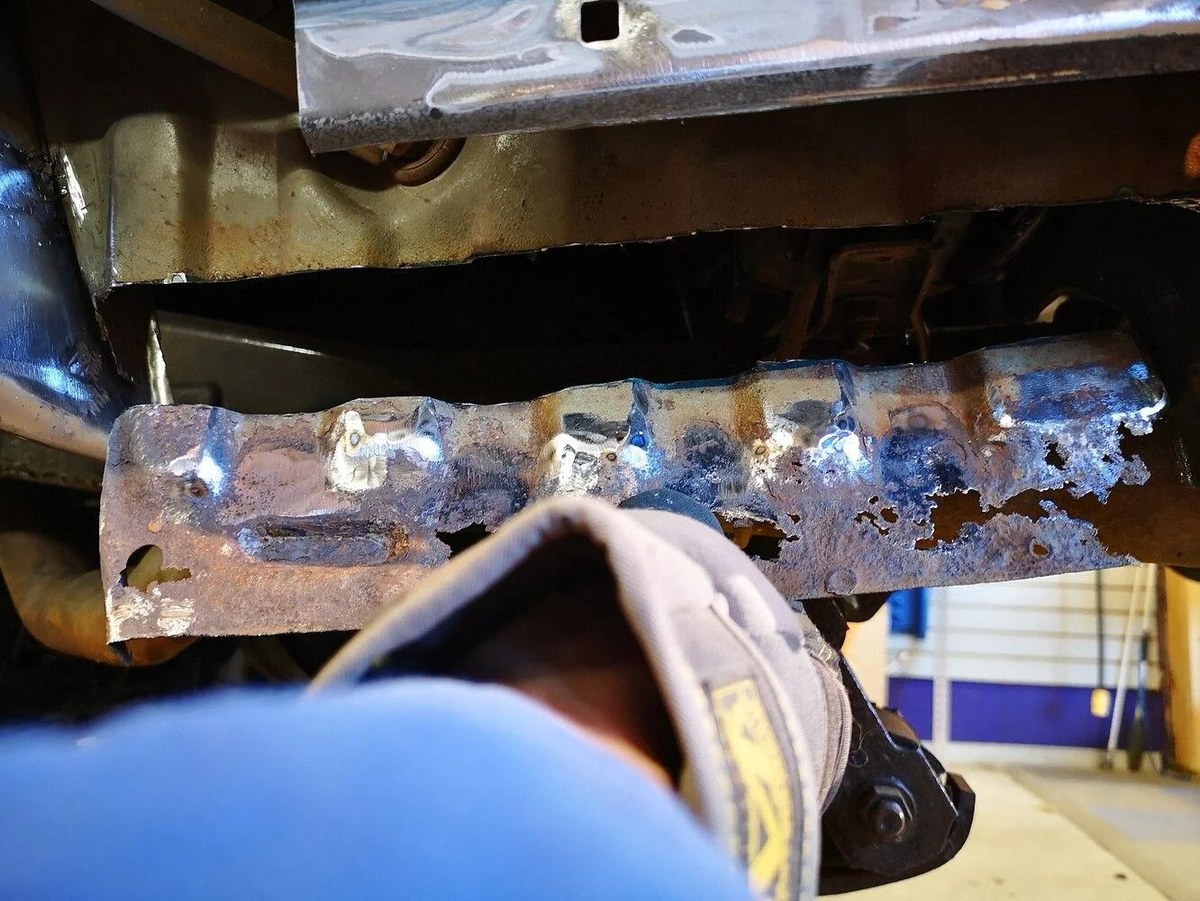

Time for the flap disc, to see where the good stuff began! It seemed the best way forward was one part at time, since the outer structure depending on the inner for its shape. So I began with the lower wheelwell. Cut off the offending (and withered) lower part, and fashioned a replacement. My cheapo brake and some pipe clamped in my vise helped with the shape, although my decision to use 18 gauge to match the truck instead of the more malleable 20 guage was momentarily called into question. LOL. Ultimately I welded in my patch panel and it looked like it was going to be okay.
I didn't attach it to the inner wall just yet, since that was the next thing to be exorcised! Here's the inside wheelwell view after a bit more massaging...
More cleaning up would be necessary, but at least we had some structure back. Next up, it was back to the flapdisc, and unearthing the line of demarcation, so to speak... I felt it was important to be liberal with my cuts, rather than conservative, current political climate be damned, so there'd be no risk of the tin-worm creeping back in. I might've gone a little lower, but it hardly mattered, since a vertical piece is a vertical piece?

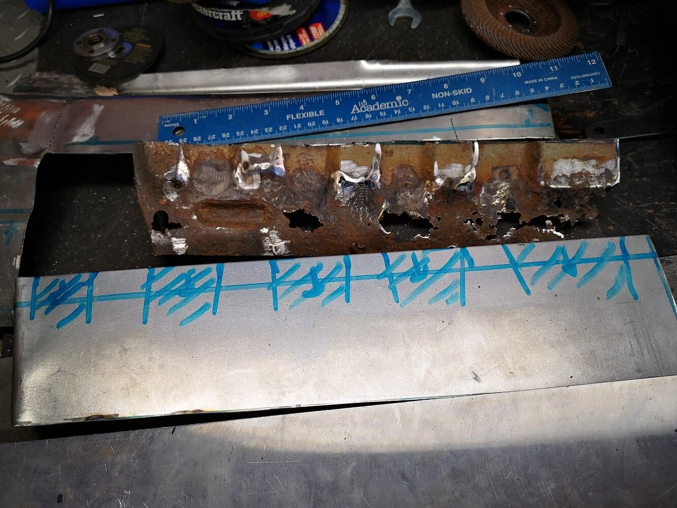

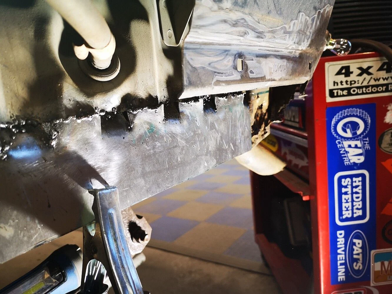

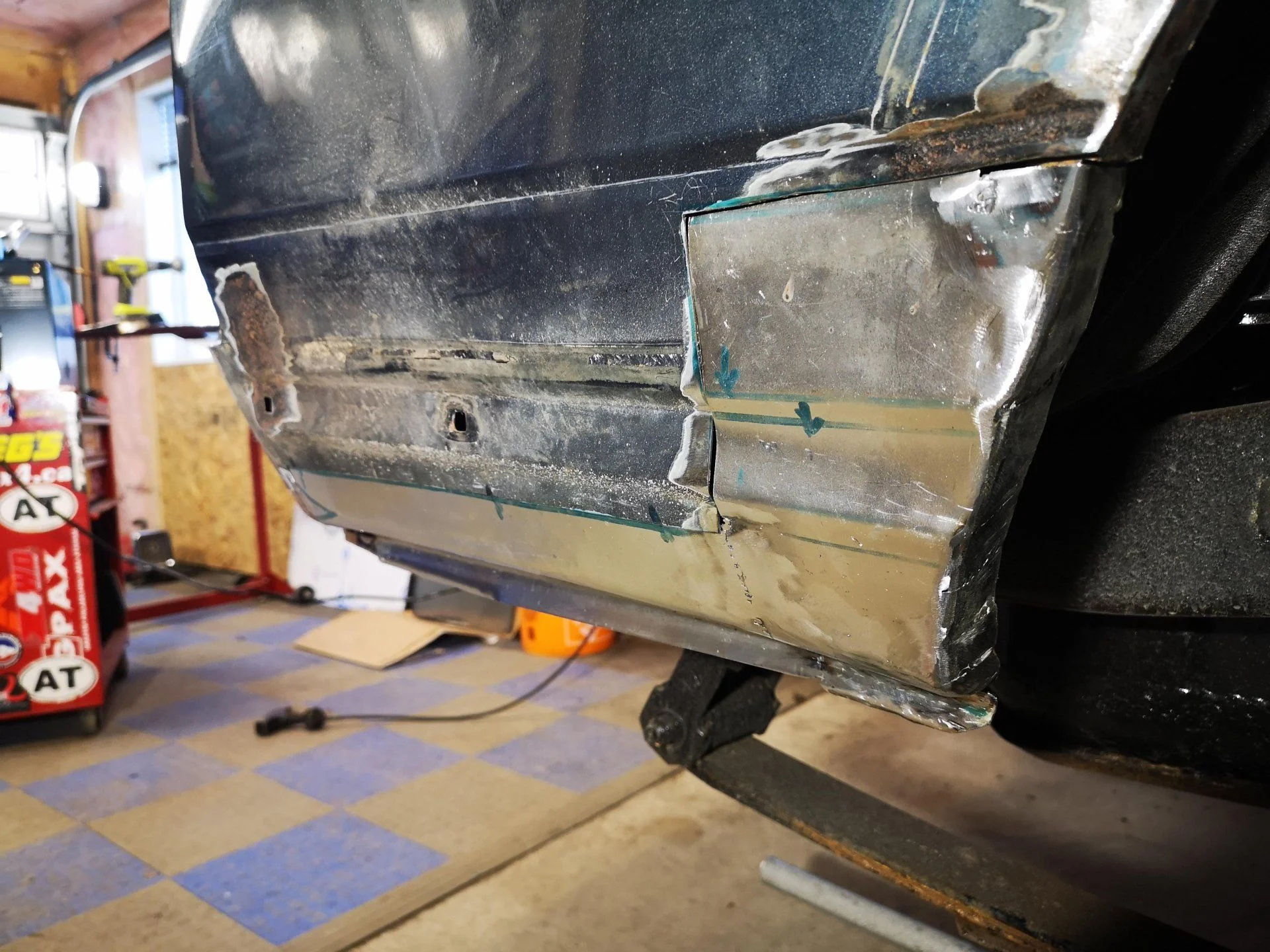

Fabbing this panel was a challenge because of the currugated structure, so I started with some doodling to try to fashion some matching tabs.
Here's my embarrassing first run at tacking it together with flux core (you are so right Mr Westmoreland! I need gas!)
I went back after this pic and did some cleaning up, and it looked passable, if not purty...

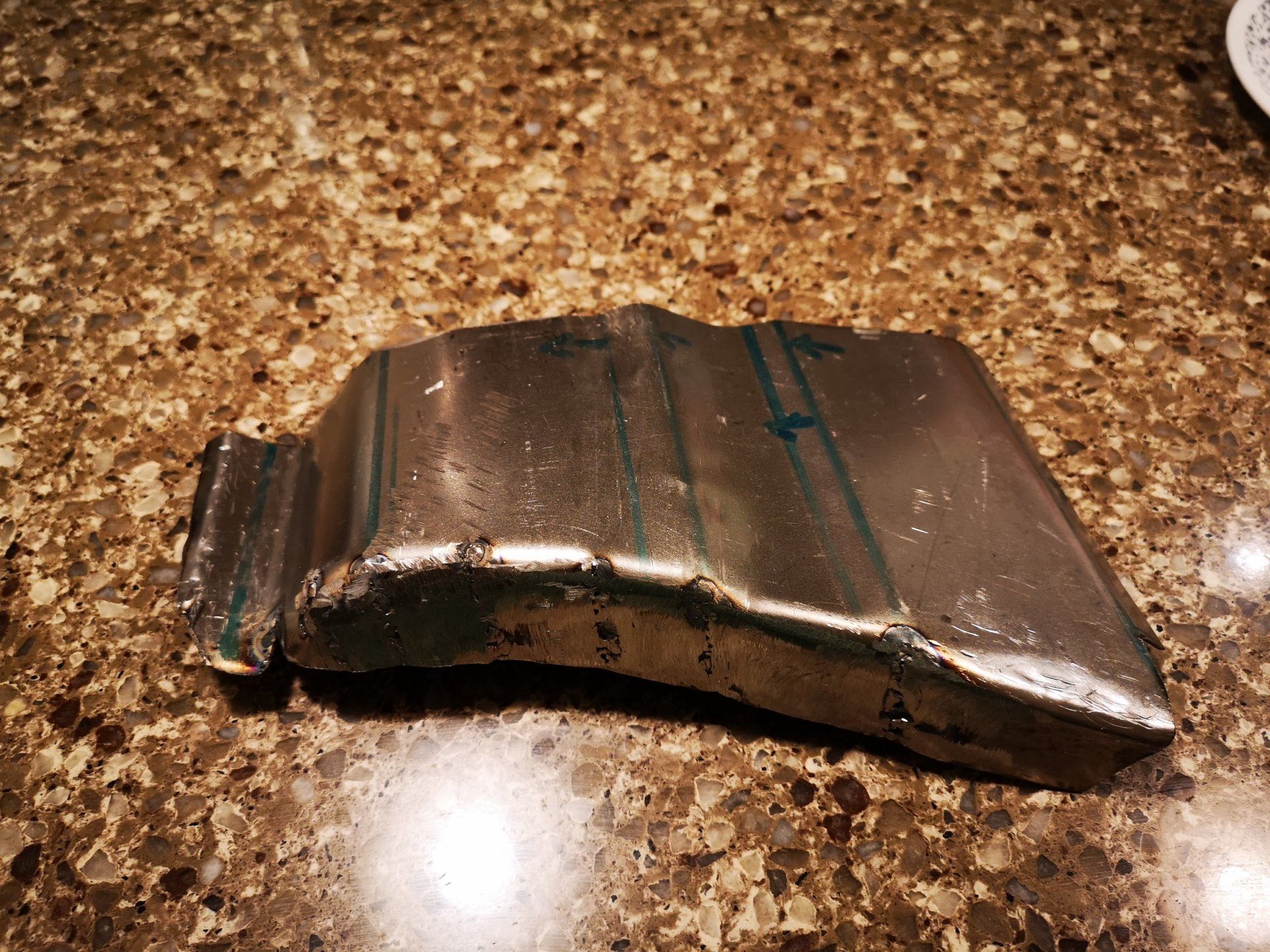

It was time to start fabbing a replacement. Or at least, I thought it was. Turns out I'd spend about 3 weeks off and on trying to fab something that would look right in this space. Those of you with experience in this area can probably see above that I clearly need to cut more out, but at the time (this was mid-January past at this point) I was trying to save the corner that wrapped under the tail light...
Here was attempt number one, partway through...
And here's attempt number two, a week later, mocked in place. (Yes, I know, still crap.)

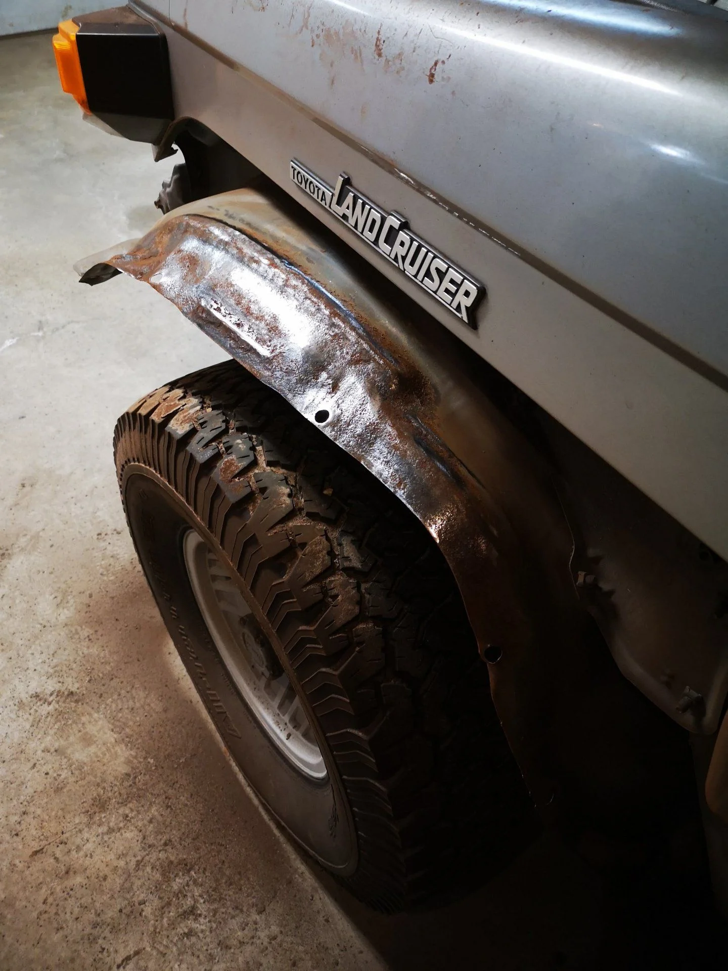

At least I was learning as I went? I needed a break from the rear quarters, so I went back to the front.
