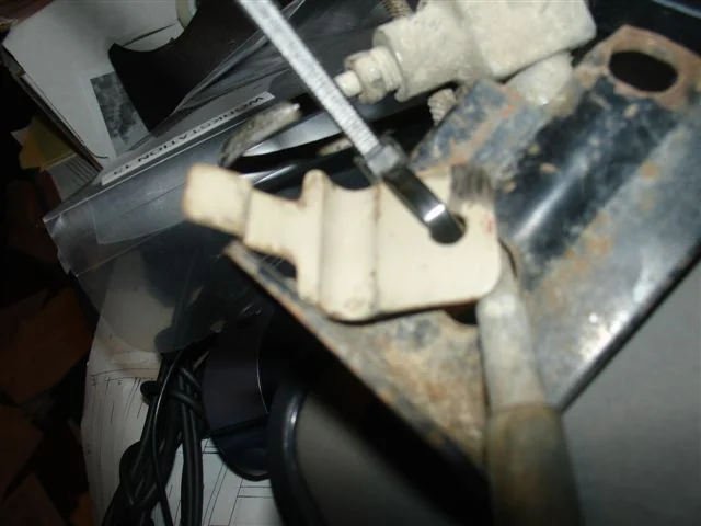

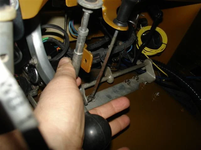

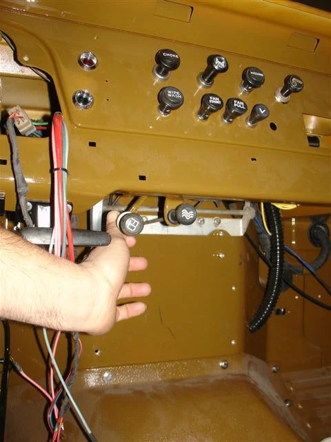

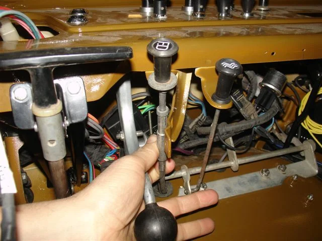

So, here are the pictures of where we are looking for the vaccuum cable attachment thingy.....
Hopefully the pictures explain it. This is below the actual "dash" -- so just inches below the actual dash.
To the right of the parking brake and the high-low lever. just to the left of the fresh air vent.
The locking part (piece I am missing, on post 432 you can see it) just sandwitches the cable into place.

Unfortunately I see that being an impossible task to complete. I therefore suggest you finish up what you can, call the project unfinished, and deliver said vehicle to me. I am more than happy to make sure that the angst you are feeling about the cable goes away.
I hope my '78 turns out 1/2 as nice as yours will.
Thanks for stepping up to assist me in my troubles.... and thanks for the complement too.
Devil is in the details.
Sorry I didn't have those brackets on mine, so sorry I won't have the piece that you need.
Pam
Thanks for looking Pam! Really appreciate it.
Cheers.

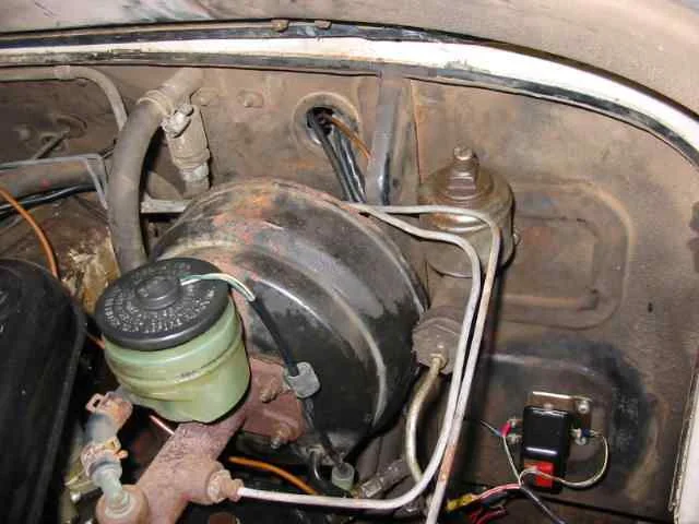

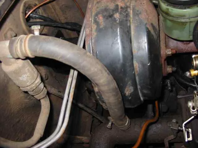

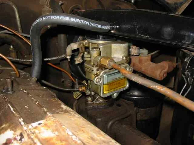

booster adapter question you had
this help visualize what your asking? regarding booster fitting etc?
last one i found to help.
