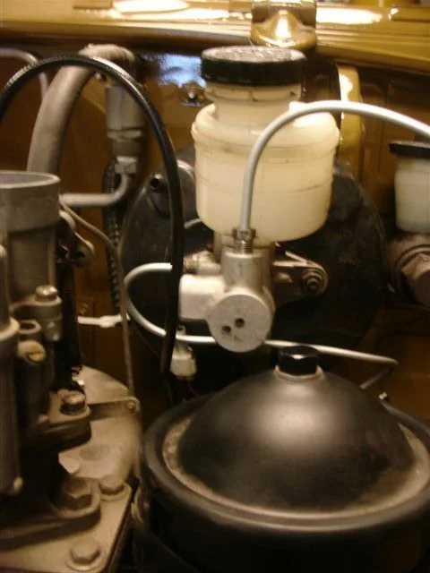

Brake master adapter is made and powdercoated this AM.

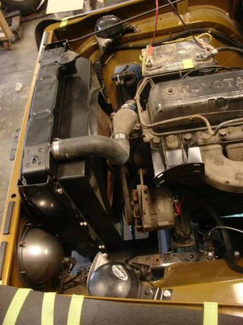

radiator in, need to run heater hose

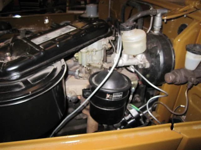

Got her turning over and sputtering, so we have fire. I do not see gas coming up from new pump, so I need to look at that. Do you have to prime the old pumps?

Pour some gas down the carb and see if it'll fire that way. you should be able to see gas in the bowl quickly while cranking. Did you have gas to the pump?
Then can check past the pump to the carb..
What's nice is the HUGE aquarium on the old carbs.. you can easily see the gas in it.
For a quick check to see if your pump is working pull the line loose going from pump to carb and crank the motor. If you make a mess of fuel your pump is working (hold a rag over the end so you don't spray fuel everywhere). Shouldn't need to prime, but you can pour some fuel on the upstream side of the pump if you want to try if you' have nothing at the pump.
If you have fuel coming out of pump, take the line going to carb loose at both ends and shoot some compressed air through the tube to make sure it's clear (don't ask me how I know to try this. If I would have thought of that sooner it would have gotten me running days earlier and saved lots of head scratching).

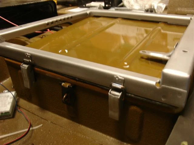

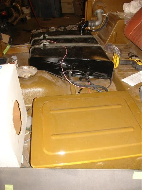

First is the latch to hold the rear seats I made, then the gas cap installed and the radiator

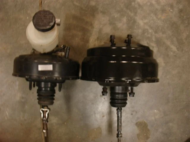

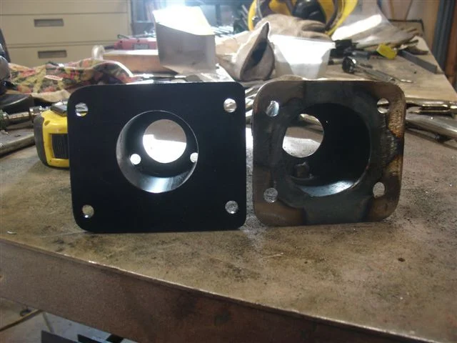

Here is the adapter mark makes for the Fj to convert to using later model power booster.
The larger hole one is the one I had to make to use the GEO master. The OD of the bore area was larger and it could be shorter overall

I spent enough time rebuilding the tank to be comfortable that it is hooked up right. I bent the solid fuel line that goes from the filter all the way back to inside the cab next to the fuel tank, so it is good. I only have about two gallons of fuel in it, but I have not tried to clean out the steel line from the new pump to the carb, so that is on the list tonight.
I do have a boat style fuel tank that I can use if I have issues with fuel coming from the tank. I did use the por 15 tank sealer so, it may have plugged that line up.....

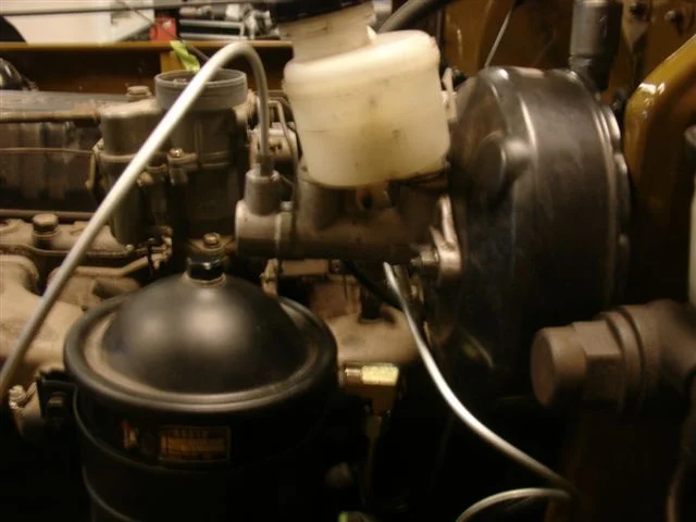

The brakes are all in and bled. HUGE thanks to DMaddox for his assistance and his creation of the Geo Metro conversion. Fits awesome, and made my huge issue go away!!

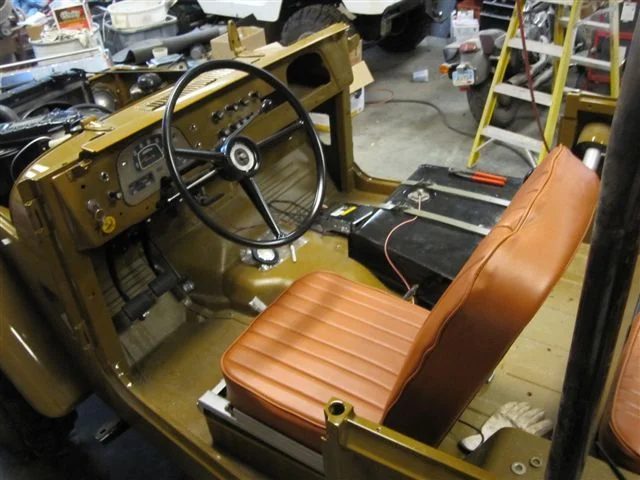

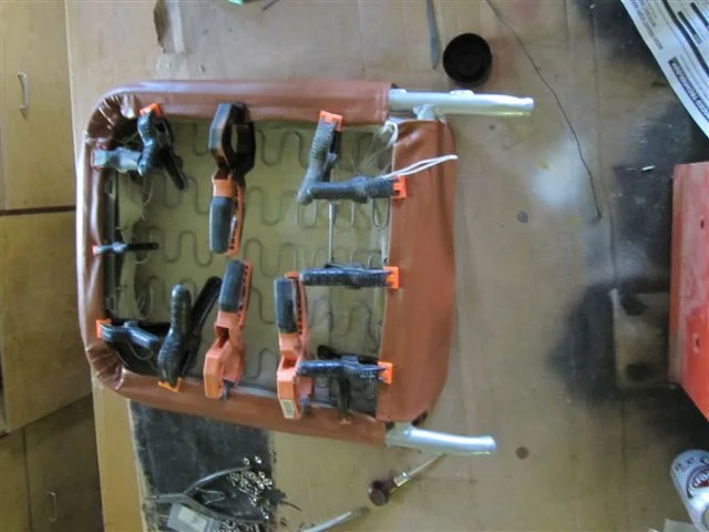

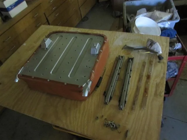

Started working on the seats, and made some progress, and got a lot of countertops cleared off!

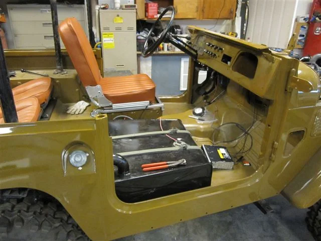

seats in

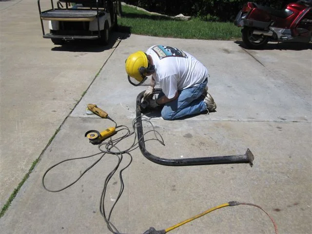

rollbar
Thought that the old muffler pipe additions to the rollbar looked great on the golf cart!
Rob took the muffler part off the original roll bar, now I need to fab up mounts for the seatbelts

With that said, it is back to reality.... I found a leak in the clutch master (some paint got crinkly) so I need to find a rebuild kit or replace the master. The only thing is that I don't know what year this one came out of. Likely the 75' or 74' parts rig, but Toyota shows different rebuild kits for these. If I find a picture, does anyone know how to identify these?

I"ve got a new 76ish clutch master in the garage, requires a different hard line
yours has the weird fittings most of us upgrade out of. Personally i'd look at like rockauto and see if they have 70-75ish clutch master and slave and new flex line and upgrade out of what you have with the weird fittings. if you get those 3 parts you can use an off the shelf hard line and will save you headaches later. problem is more it leaks the more it might damage your paint.

Now, this is not the 68' clutch master, with the wierd fittings, it is one from a 74ish. I either pulled it from my 75, that was made in November 74, or the parts car that I can't recall the year on it. I just can't recall what I pulled it from, but i know that I swapped the slave and the master including lines. It does have a 10mm fitting between the hard line and the flex line. Post 492 has a picture of it.... Post 1 has a picture of the old master.
