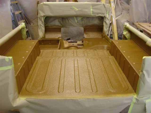

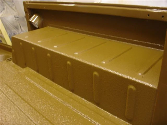

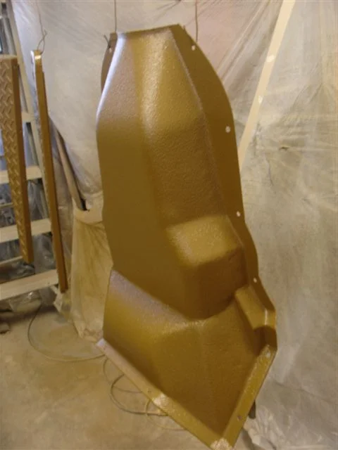

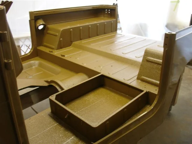

OK, so this am, I sprayed the textured interior.
First off, last time I threw away the texture gun, (schutz) because I was out of laquer (oops) This time, I got even smarter, and it worked great.

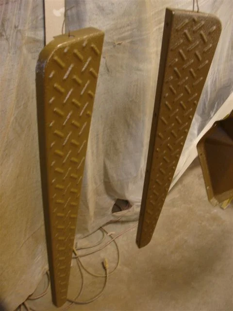

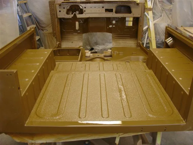

Oh, and advice if you do tinted liner. You barely have enough room in the raptor bottle to put the hardner agent and the color base. I estimated that it would take 2 liters to do one coat (based on other postings), so I got a gallon mixing tub from the paint shop, measured 500 ML of hardner, added 200 ml of color, and then the two bottles of raptor, 750ml each. then I mixed it all up, and put back into the raptor bottle, leaving an inch of room at the top, as there is still some raptor product in the bottle that did not come out. Shaked it again really good, and sprayed it. After one bottle goes out, did the other bottle, then went back, put the remainder from the gallon mixing container, (there was not room for it all during the first pour) and cut the top of one of the other container to get out as much as possible. At $50 a liter (with the color cost) I want to use every drip.
Anyway put all that in and sprayed.

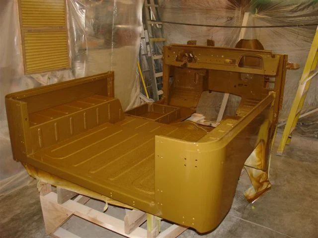

slide that frame under it and go to town. Thats going to be awsome.
Thanks, that is next on the list.
