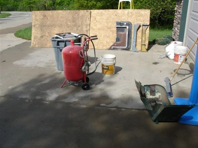

Media blaster for full tub is worth the $ .. Been there done that will never do it again. EVER.. best $450 I've ever spent..
Having a blast
Pics of the frame and other
that is my stunt double blasting, while i have the hazardous job of taking pictures.

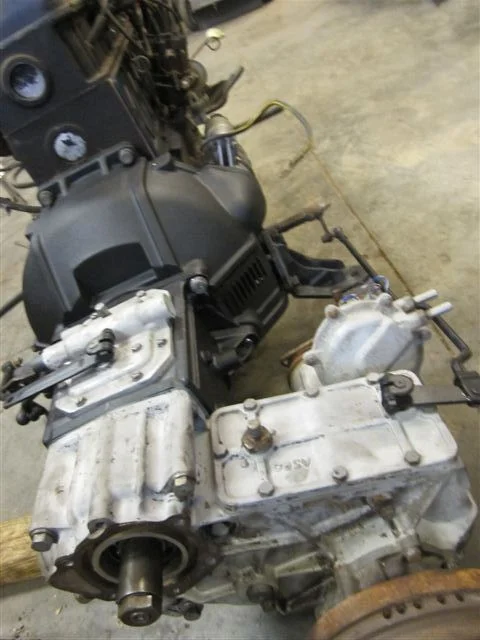

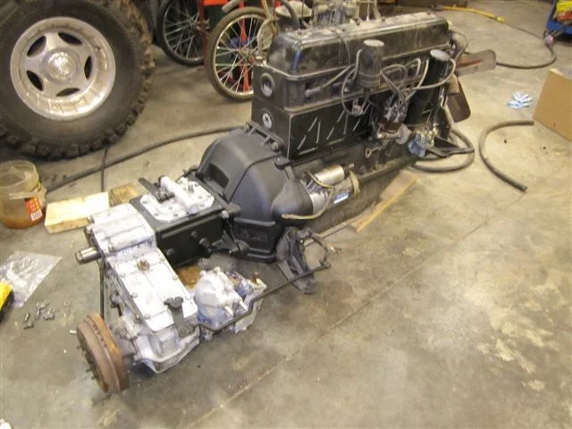

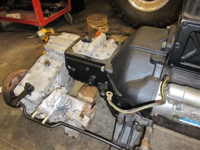

Well, I got the tranny, transfer and all back together. Here are pics of all that jazz.

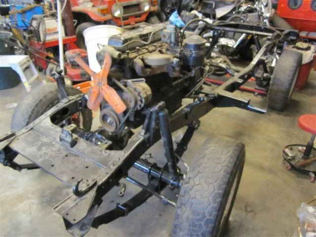

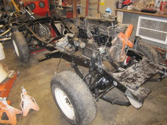

look who came to dinner
My buddy was in town, and showed up bright and early, so he got put to work.
We strapped the engine up and got it in place. Still need to find the rear bolt for the engine mount, and dig out pictures of how the linkages go for the three on the tree, but it is coming together, which is really exciting.

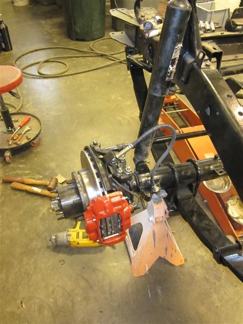

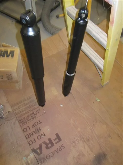

Here is all the brake lines completed and painted the shocks

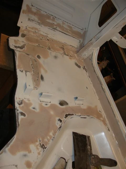

bodywork started

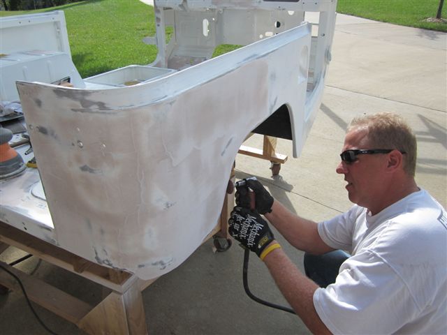

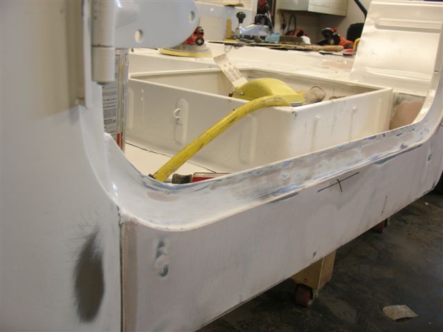

Here are pics of us starting the bodywork. Last week, I finished most of the interior bodywork that was needed, and engine compartment / firewall.
Today we got about 4 hours on the rear quarters and rockers. Good first coat of mud. Not looking for perfect, just looking for respectable.
three on the tree is functional in the 45 in my parents garage should you need a working reference. Congrats on gaining that garage space back! You are rockin and rolling.
What type of filler are you using?
Filler is from MSC. I think it is lightweight 3M Dynatron. I think it was $12.50 a gallon.
I need to find some final finish fine material -- it seemed a little course.

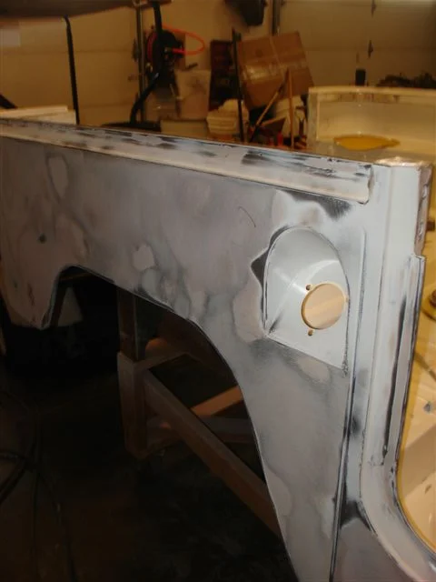

Well, I finally got out to the garage, and made some progress. I am skim coating all panels with mud, even cleaning up the factory weld for welded nuts on the upper edge (basically everywhere that I am not adding the bedliner. Got most of it finished yesterday. Next up blow on some blocking primer.

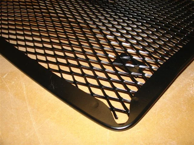

small parts
I also had the sandblaster out last weekend for a neighbor, so I blasted some small parts and painted. I also welded a new end on the gas tank straps that had fallen to the rust lords and painted them up.
