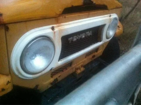

I was wondering this too! My hj47 is easy as it has guides that match up with the adjusting screws on the headlights... Fail proof!
But now I see from this hj45 ute what you guys mean
