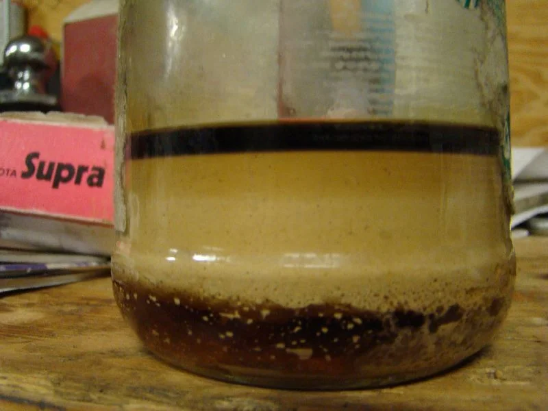

I was getting a sludge mix in my catch can.
attachment.php
It ended up being that my timing was way off and the sludge was the result. After fixing timing, I just got oil like others have and removed the catch can.

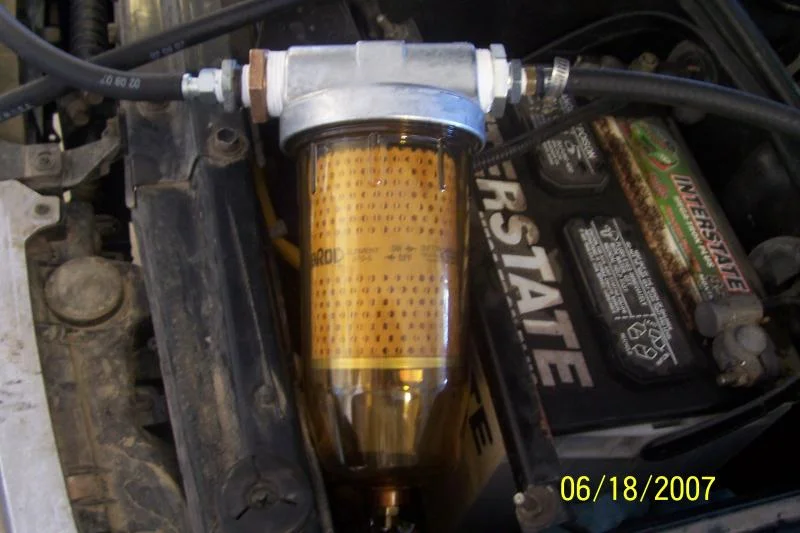

I was using a diesel water separator.
attachment.php
I was getting a sludge mix in my catch can. It ended up being that my timing was way off and the sludge was the result. After fixing timing, I just got oil like others have and removed the catch can.
Timing huh? Interesting. I get that kind of sludge in my JEGS separator but only in the winter. Just curious, how did u fix the timing problem?

Somehow I must (assume) of bumped the timing when I tightened the timing set bolt as it was way out of spec when I check it again. I drove that way for many months and miles with no signs of problems other than excessive oil consumption thus was the reason I put the catch can on to see where the consumption was coming from.
I was getting about a 1/4" of oil in can after 40 miles.
