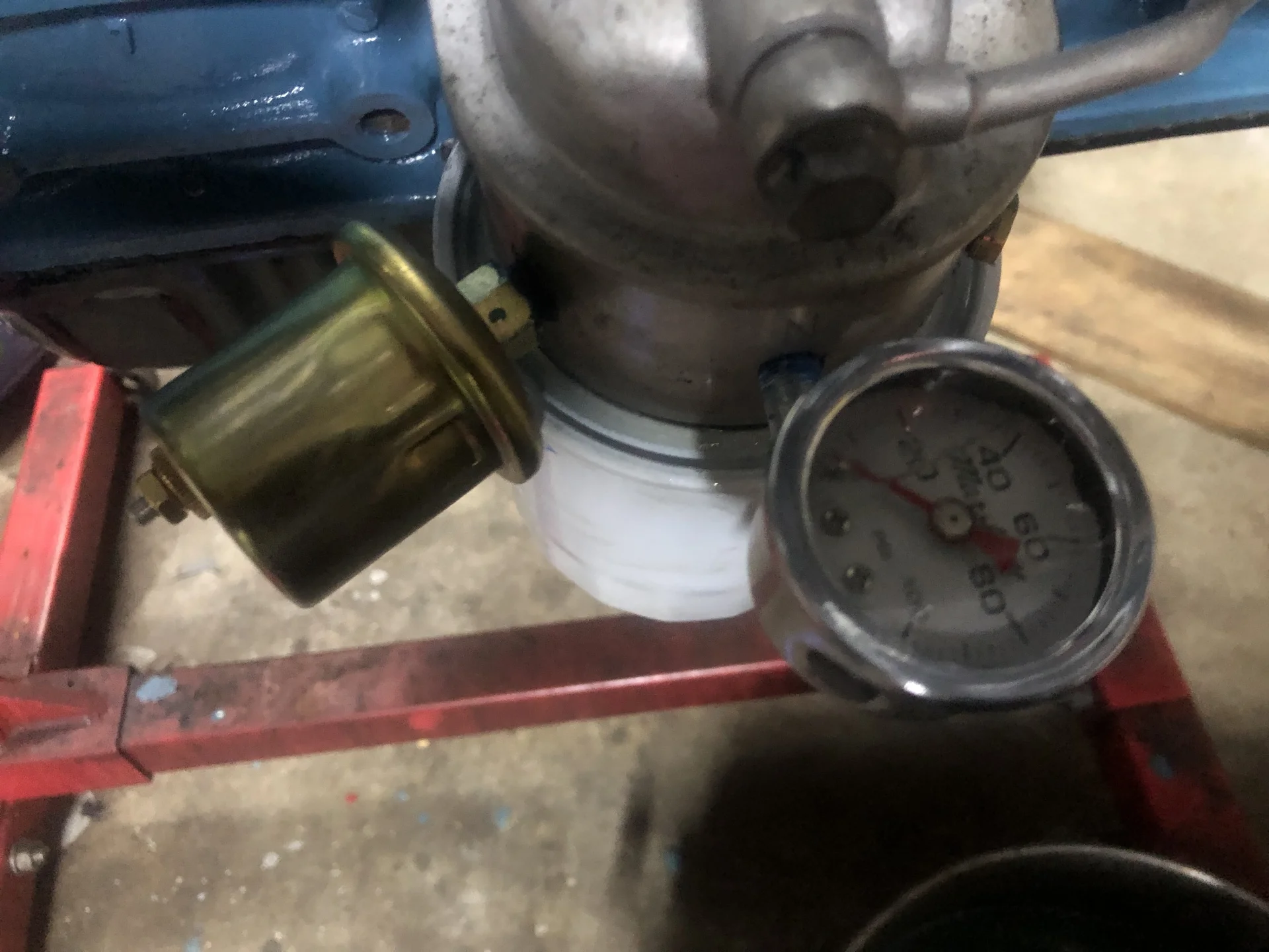

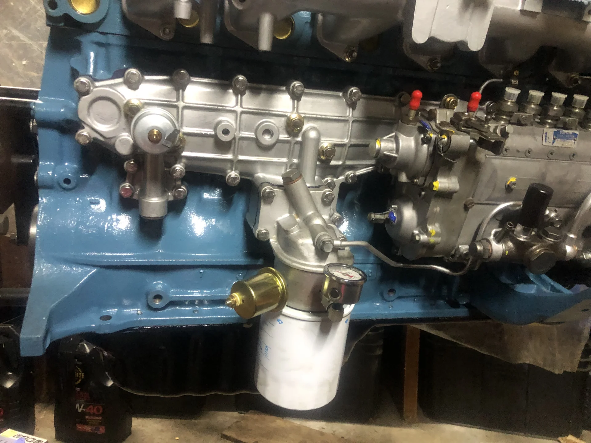

Soooo. what is the best way to set up to have a secondary, proper oil pressure gauge even if it's not a permanent thing fitted in the dash but one that can be connected when required for testing? Is there a need to monitor both oil pressure and temp or can it be presumed that oil temp and coolant temp are basically matched?
search on here, or google, i did it along with a 'bypass oil filter rave'. I feel naked now without my extra oil and temp gauge.

The extra gauges just give you some reassurance.
I have a Watchdog TM2 for coolant temp (sensor mounted to top of motor near radiator hose connection), but need to figure out what do to if I want a permanent oil pressure monitor or not.

I do not know much about the hz but installed two after market oil pressure gauges + sender , one mechanical and one electric on my 2h. Worthwhile in my opinion, on the 2h gauges are not very accurate. The autometer and marshal gauges are much more real time responsive.
