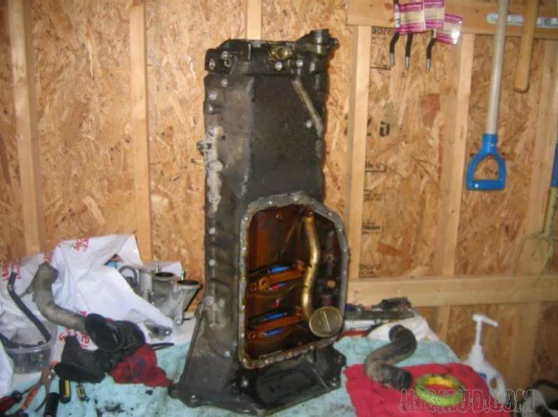

Just went out and pulled the saddle adaptor out of the rear PS corner of the lower pan, it pushed it up about 3+ inches, no way is the pan repairable, bent it in and tore it open like a sardine can. After I pulled the adaptor out I could feel through the hole into the pan and could touch about 1-2 inches of the pick up tube which was oriented in front of the hole, I did feel a small dent, but can't tell if it is totally out of whack. Added this photo of the main pan from another thread, I may have dodged a bullet as most of the impact was on the PS rear, and this photo shows the pick up tube is on the DS rear. On the other hand, the impact was directly in line with the rearmost internal brace of the main pan. Will try to get photos once I get the lower pan off.
(note: this photo is not my pan, just shown for reference)

If you had punctured at the drain plug, I think you did not touch the screen as the screen resides more towards the back end near the tranny. I think 2" not enough to even touch that pickup tube/nozzle IMO because the drain plug is lowest point in that oil pan. I had dented my lower oil pan around the same area; got hung up on a really tall pointy rock and dented but not punctured. I had driven like that for months before I replaced my front oil and arch seals. I did not get a new oil pan, just hammered it flat with a brass bar after I had taken it off. I would suggest to take the lower oil pan off and get a head start while you wait for a new lower pan.
