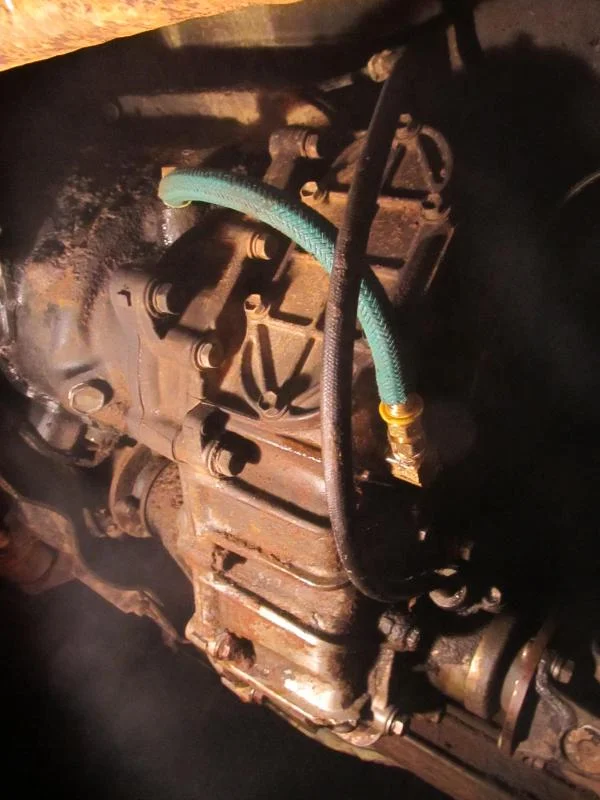

However i think i have made a discovery for the better. I brought home a couple of fittings to look about my homemade transmission to tcase hose bypass. Brought home a 3/8ths npt elbow and 3/8ths barbed plug. It was a little big for the plug but as i looked at it i noticed "man it's awful close" ! Sure enough it threaded right in!! May try it out before we shoot saturday so i can see if it works. This could be a fairly big find seeing as how everyone else who makes them home made taps there plugs!!:clap:

I got my oil pan gasket from cruiser corps for 10 bucks....only took a couple hours to switch out.....take some pics of this hose you're making.

gonna fix front output seal behind front driveshaft next week. Have to get oil pan gasket seal. Already fixed galley plug. Will take pics of hose set up next week also.

attached home made transmission to tcase line today. Gonna see if it leaks tommorow!!
Ok I need better pics than that.....what and where did you get your parts from.....did you have to drill and tap your plugs?
3/8ths npt 90" fitting. 3/8ths barb. Not completely sure what the hose is made from. I got all this stuff from where i work. I did not have to tap anything at all. Why u need one??
