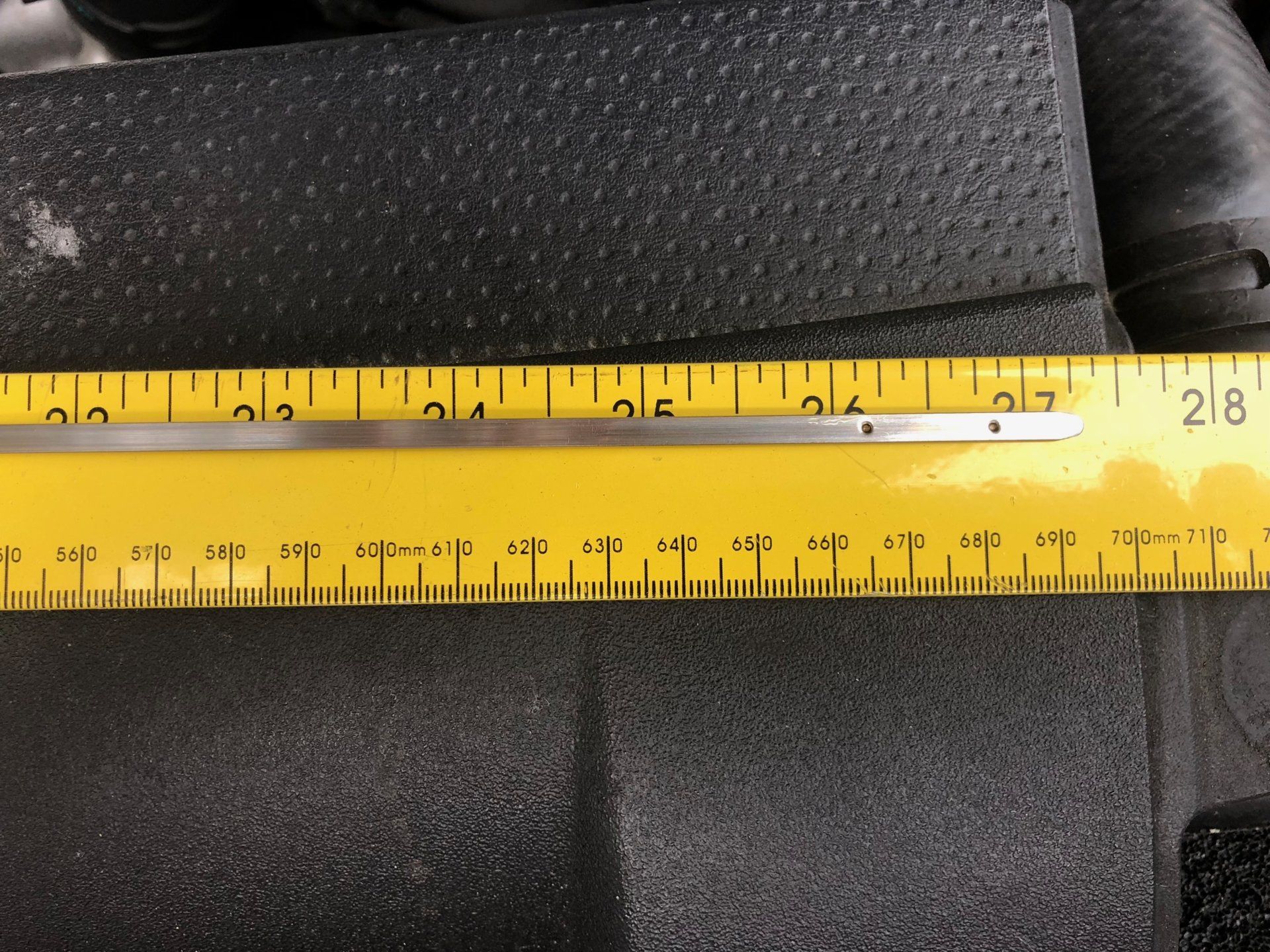

Thanks for the reminder! So mine is as follows:
total length of dipstick metal (27 1/4")
full mark: 26 1/8" from top of stick
low mark: 26 3/4" from top of stick
pictures below, the measurements are correct, pictures were before I adjusted the ruler, off by about 1/16
The two dimples at the bottom of the stick are your measuring points. Top dimple is the full mark. Bottom dimple is quart low.
