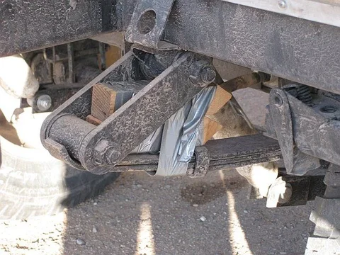

I only ran into two hiccups. The first one was before we hit dirt. With the camper loaded down and the water tank filled, the suspension was going to be bottoming out more than I was comfortable with. So I took swampman's suggestion and made some bumpstops. Will & I drove around Hanksville, UT going through trashpiles and hitting up random people, and came up with some 2by scraps. Add a little duct tape and you've got functioning bumpstops.:hillbilly:
We had to replace them a couple times as they fell out, but we had spares, and these things worked like a charm. Once we got back on Tuesday I ordered some urethane bumpstops to permanently and in a slightly more aesthetically pleasing manner address the bumpstop issue.

The McGyver award clearly goes to Nick, the guy that can dig through some random trashpiles while risking being bitten by some local dogs, get the gas station attendant to lend him a circular saw and then use duct tape to fix a suspension issue.
