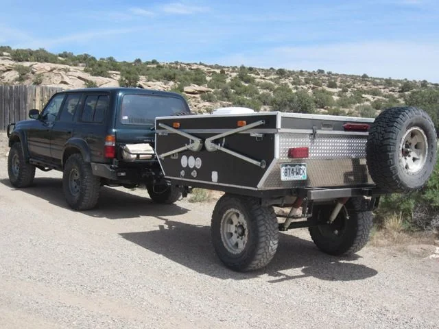

Before I headed out to Moab, I finally got my diamond plate broken and mounted. I also painted the sides and the front and back of the roof to match my Cruiser. It's hard to tell from the pics, but the paint I bought is hte same dark metallic green.
This project required pulling all the hardware off the exterior of the camper both for painting and for mounting the diamond plate.
None of this is really functional except for the diamond plate on the front as the front gets peppered with gravel.
Here are the pics!
:cheers:
This thing gets miles and many nights. This summer saw a bunch of family camping. Just got back a couple weeks ago from taking it on an antelope hunt in Wyoming. There I got to use the rear receiver hitch as I attached a hitch mount cargo tray to help with all of the gear.
