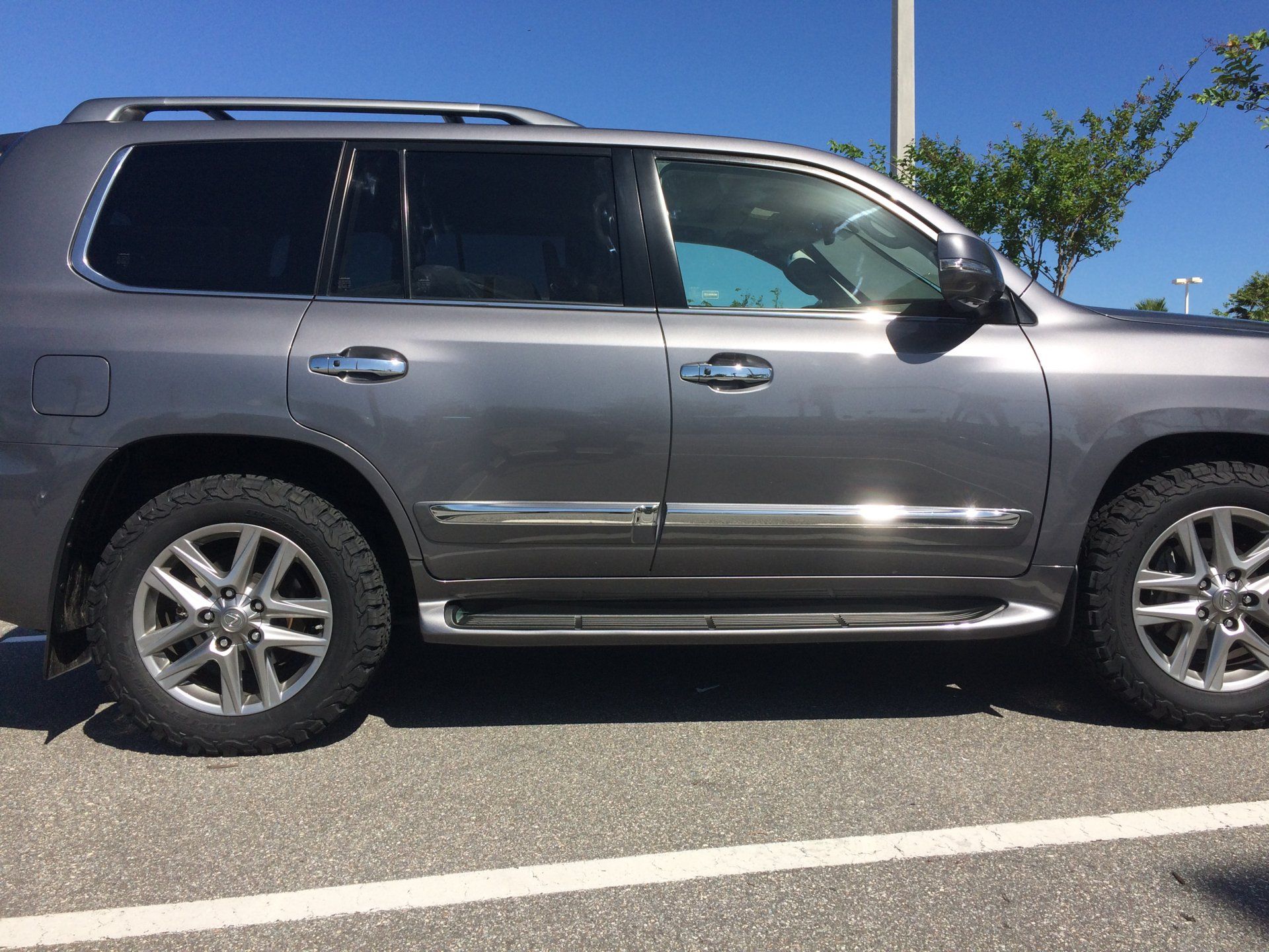

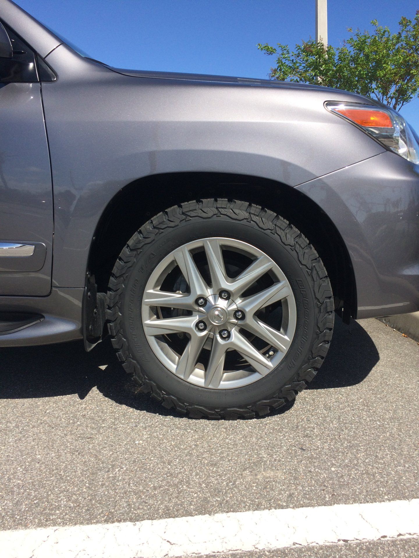

Added 275/65/20 KO2s today. They fit great with only the slightest rubbing on one mud flap in reverse. Paging @gaijin for recommended psi :)
The Recommended Cold Tire Inflation Pressure for the LT275/65R20/E 126/123S BFG All-Terrain T/A KO2 tires on your LX570 is 36psi F/R.

Awesome thanks! The guys at Discount sent me on my way with 52 psi. When I turned on the truck and saw that on the TPMS readout I laughed a little :D

To answer a few questions, here is the LX in low, normal and high settings:

And this is the front of the wheel wheel liner which is the only place I still rub after removing the mud flaps. Keep in mind this is as fully locked as you can turn, and the rubbing is extremely light. I'll still trim/reform the liner to remove the rubbing, but it's livable as it is. I'm quite happy with the way it turned out considering these are pretty close to a true 34" tire. I previously had 285/75/17 Nitto Ridge Grapplers on my fully built 2014 LC, so to fit a tire that's the same size if not a touch larger on a completely stock LX is pretty cool.

I'm surprised you're not rubbing on the UCA there Matt, because mine with the same tires (size/model) definitely did. I just needed to offset with a small spacer.

It looks like on close inspection there is a tiny rub mark on the UCA probably from cranking the wheel at full lock to test clearance. I doubt it will be an issue, but out of curiosity which spacers did you use? I generally dislike adding spacers, but if it was very mild I'd think about it. My wife said the truck looks even better now with these tires on the OEM wheels, so for better or for worse the wheels are here to stay :D
