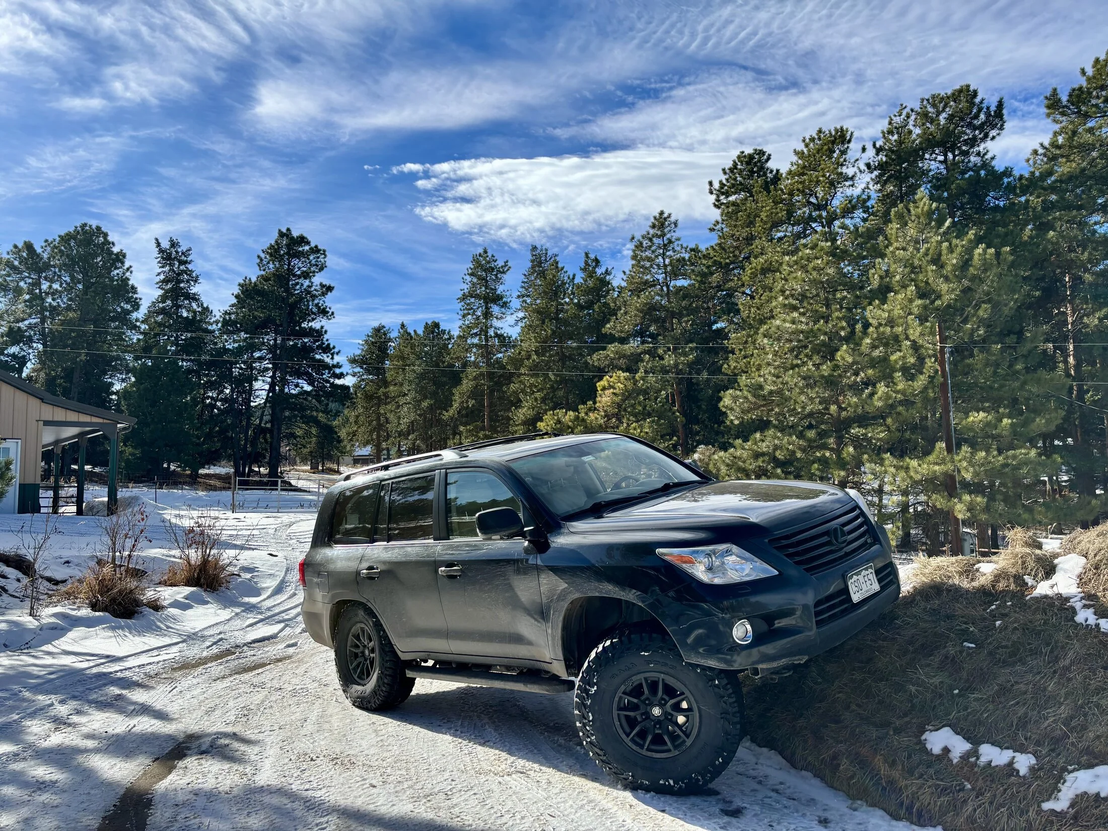

Still some cutting and shaping to do, but it’s drivable and I think I may be able to get away with not cutting the fenders. I rolled them out and with my Timbren Bumps and the body lift with a 25+ wheel it was really easy to fit. My body mount was already cut as aggressive as possible.
Granted I have a bit more up travel and droop than stock front and rear. With that said I did a lot to make the old 35s work and not lose up travel. The body lift was a big help with these.
Drives like an absolute dream, way way better than my yoko Es. I wanted a softer tire for deep snow and so far it seems to be a great winter set.
I’ll be taking all the recover points off and shaving all the low hanging stuff off the rear bumper.

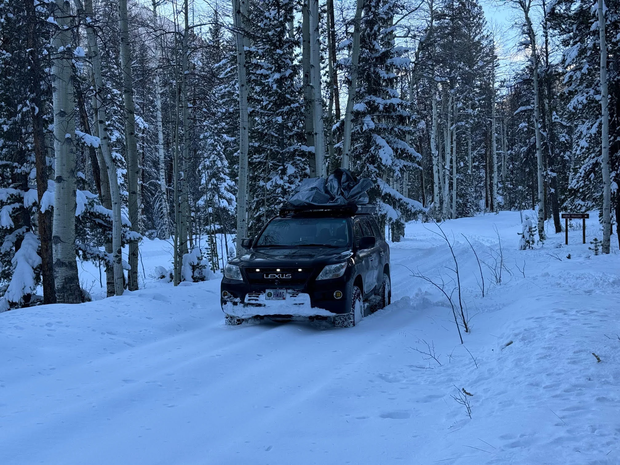

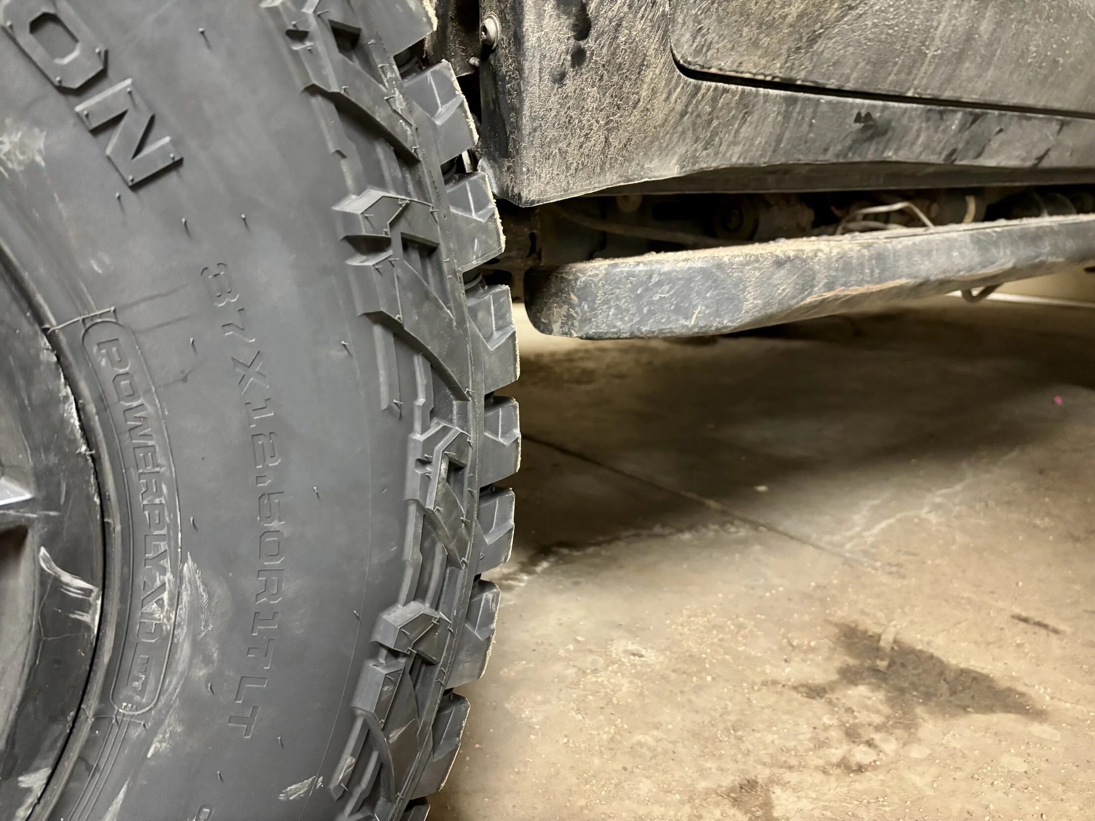

I did a good amount of cutting but still need to do the most aggressive body mount chop. I easily clear the fenders but rub on the body mount at full lock and stuff and sometimes the frame it seems when I cut full lock in certain situations. First image is the front wheel and it barely kissed the body mount. BMC isn’t a big issue but I have room to chop still so might as well. It’s mainly the frame. I have room with the fender too.
Rear stuff in the second and looks like I have room there to move the wheel out a bit too so not too concerned about that either. Don’t want to push it and go too low of an offset though.
I have 37x12.5 on 17s too but with a 35 offset. So the 25 and you’re clearing the frame and all fine?
