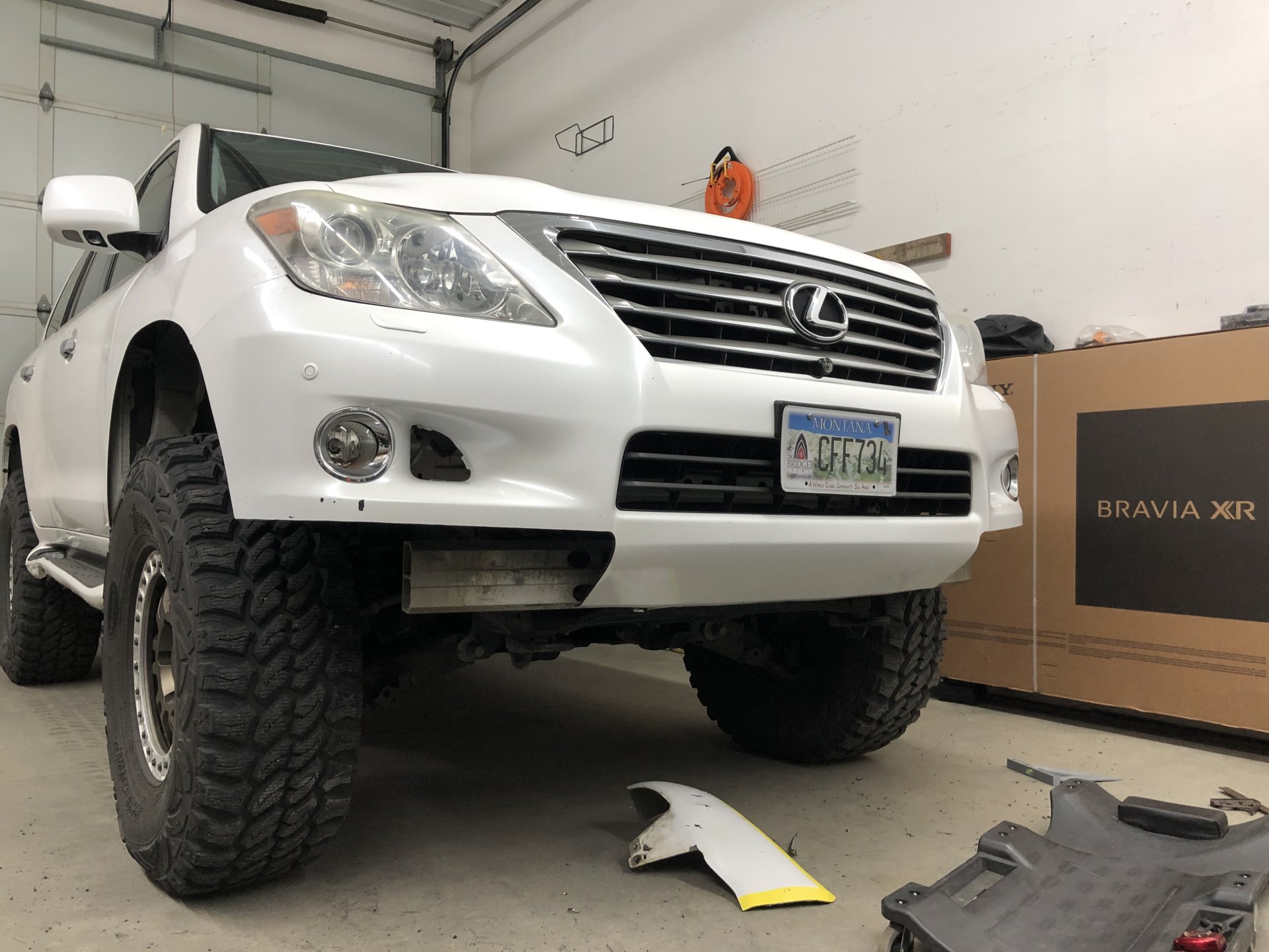

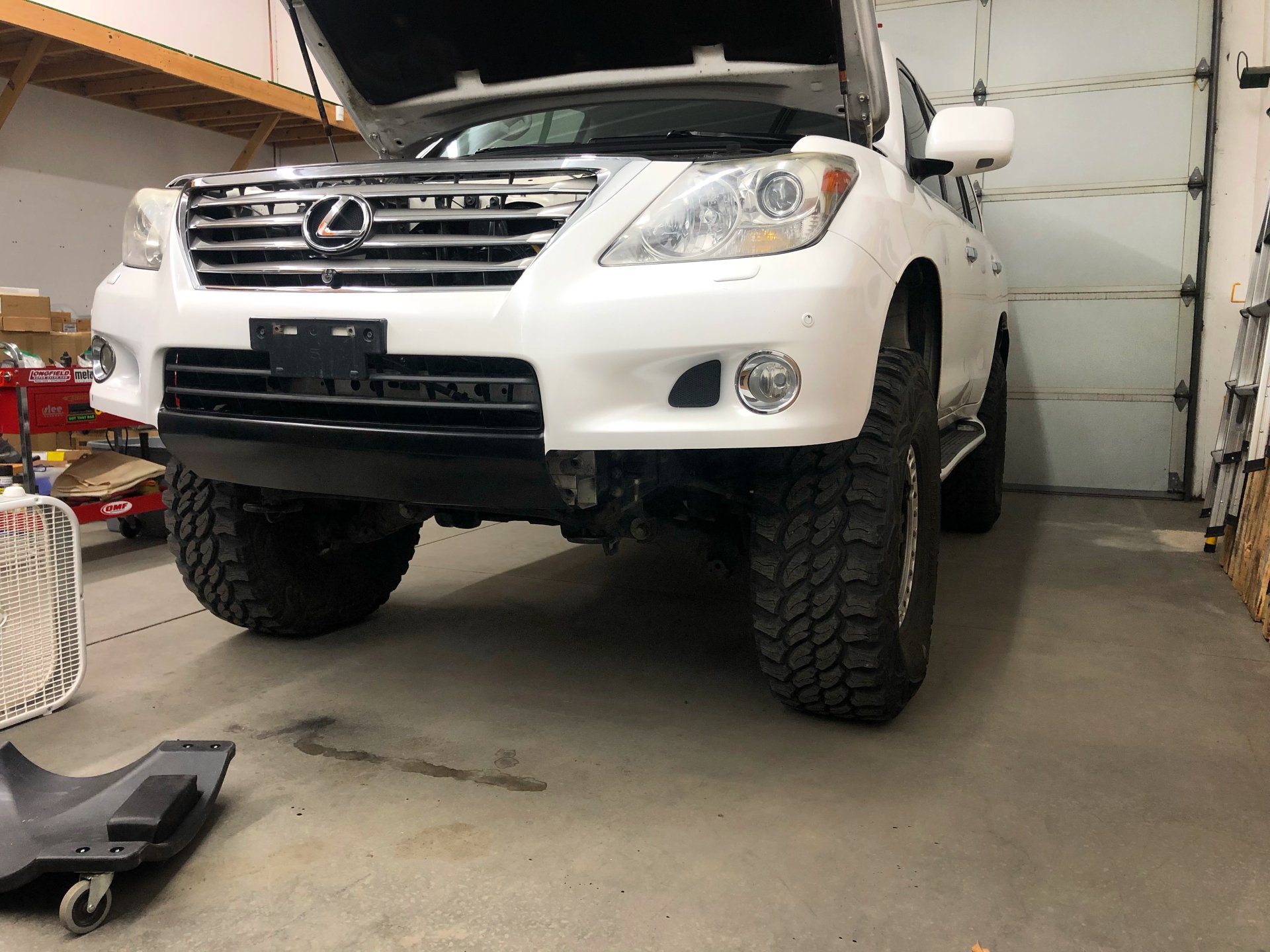

Just cut the corners and blacked out the lower middle. Nothing fancy, just a little better approach angle directly in front of the tires and a rattle can paint job that looks ok from 10’ away 😬 Hopefully just a temporary solution until I have a bumper fabricated.

She's beastly as ever. I've always wondered in my mind what cutting the bumper along those lines would look like. Like the popular viper cut on the T4Rs. Wonder no more.
Peeling back the curtains, can really visualize what's behind that area, and the crash bar comes to mind. I've thought to maybe angle the cut upwards a tad so not strictly following that line. And maybe a tube bumper under that edge? Funny as I chucked the crash bar center keeping sides and adding winch, and you have the opposite. I think this also tells me that if I wanted to cut the corners up, that really a tube or aftermarket steel bumper would be needed to keep some small offset crash protection/performance.

Its a great cut line @MTKID only thing i would take in is a bit more rounding angle into the wheel arch.
Its interesting considering the crash bar. Im not at all informed on this but i assume that the load bearing crumpling is centered on the frame apex up front. @TeCKis300 what does this mean to you? On one hand, you lose the corner on the other you compromise the structural apex of the front “arch”. Perhaps there is a better mounting location for a corner deflector bar somewhere around that wheel well maybe closer to suspension mounts?

I saw that you recognized the overlap protection when you were building your winch mount 👌🏼. I understand what I’m removing, and am ok with it, although anyone else should understand what the consequences are of doing this. I feel like most steel and aluminum bumpers put their corner protection up quite high and eliminate these corner overlap protection beams. I will likely do the same when I do a bumper too. Therefore, if a normal height car was to overlap the front of my LX in a crash, even a large metal bumper won’t catch them. Not ideal, but I understand the pros and cons for better approach angle.

Yes, I’m going to try to match a radius on each side where it transitions to the wheel arch 🤓 Neither side were matched previously, and I didn’t like the “viper” cut I had on the driver’s side, so I didn’t cut the passenger side the same. But I can do a little better at that spot 😉

👍, will greatly reduce a fracture pressure point too. You sir also need to just black out that grill while youre messing around.
