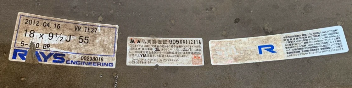

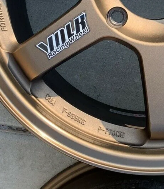

I zoomed in on a picture from eBay and it has this rating: VIA T-965KG (maybe 955KG) and P-770KG. From a quick googling, it seems like the ratings depend on type of vehicle the wheel is fitted to (possibly 2 wheel per axle or 4 wheel per axle?). It is also rated with the JWL-T which means it met some light truck standard. In rays ads they also suggest that they test beyond the JWL standards.
On the other hand, I'm pretty sure Rays is considered pretty cutting edge for wheel manufacturers and this wheel was made specifically for the LC/LX, so I can't imagine it not being fit for the job. Possibly you could argue that it wasn't built to go off road I suppose.
Good find. I ran into this issue when I was originally shopping for wheels. It seems the JWL and VIA have standard "general use" load limits defined based only on lug and hub measurements but they don't define the safe carrying capacity of a specific wheel. More importantly, it seems like they leave safe max load designations up to the manufacturers. In so many cases, the manufacturers do not provide that.
Obviously having the JWL-T and VIA stamps are great, but if you take it at face value, 955KG is still way too low for a LC/LX, especially mine ;)
No chance I would do my normal wheeling at > 8000lbs on 18 lb wheels with a 2100 lb rating on each corner.

I wasnt about to go there but exactly.
If i were @stupid, i would be calling someone up and verifying. If not for anything but peace of mind at least.
Just chiming in to say that as mentioned earlier, they are stamped 770 kg. JWL standards are always getting updated which was probably why these OG TEs were discontinued (also the reason why production of the popular TE37Xs were stopped with the new TE37XTs taking its place).

Yeah, I know these are popular with racing/performance folk in Japan, and there may be LC/LX folks in Japan and the middle east running these with no problem. I am definitely not trying to influence anyone's buying decisions. They are high-quality, great looking wheels, and under 20 lbs.
Still, based on available data, these are (I think) ~400 lbs less per corner than OEM. For my particular use, I am probably not wanting to mod anything downward, so to speak.
Hopefully the 770 KG is VIA P and somewhere on yours there is also VIA T-955KG.
I’ll have to take another look…

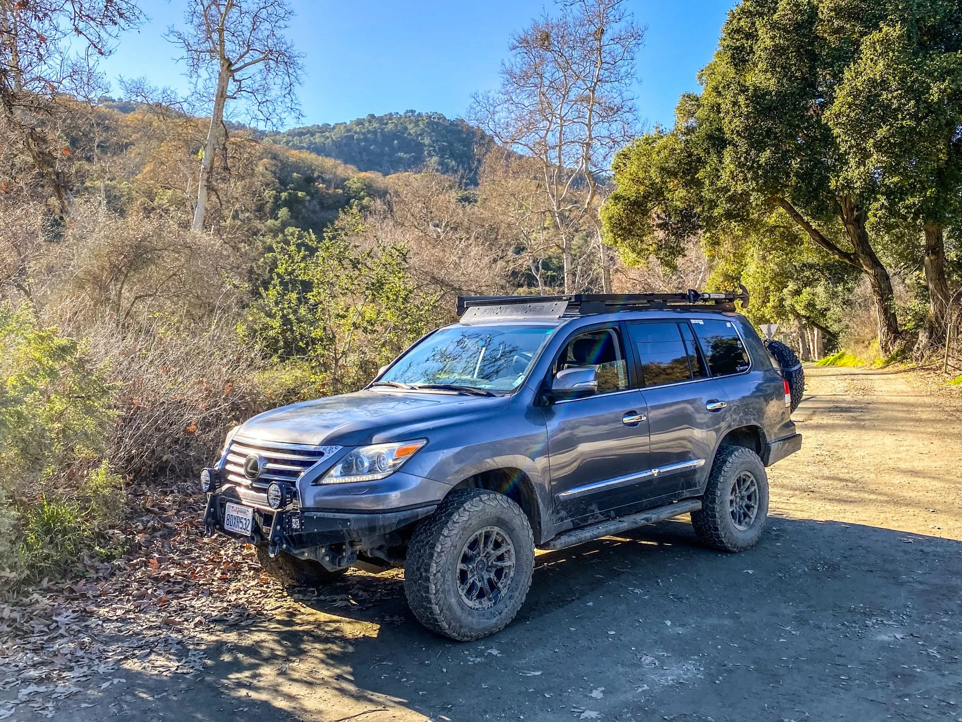

Taken with the long exposure setting on my iPhone 11 Pro. 🙂
For posterity's sake, here's the one from eBay. There was a build date sticker from 2012 as well. There are some more "ratings" on the right sticker. None of this matters to me of course, as there is zero chance I'm about to go spend $4k on wheels. Is it possible Japan/Rays generally only "certifies" them up to the GVWR when they are fairly specifically made for only one vehicle? I downloaded an annual catalog and the only vehicles with the 5x150 patterns were the 100/200/70 series.
I don't want to belabor this discussion because this is probably not the best thread for it, but I think that the JWL and VIA ratings are solely based on the lug and hub configuration, and not to a specific application. So technically it may be specific to the LC, but not because they are designed for the LC GAWR (not GVWR), but because it is specific to the 5/150 pattern with a 110 hub. Any wheel made with 5/150/110 would have the same exact VIA rating.
At least that is how it was explained to me.
I’d still like to hear more. Anywhere else more appropriate to have this fleshed out? Kind of important to know.
