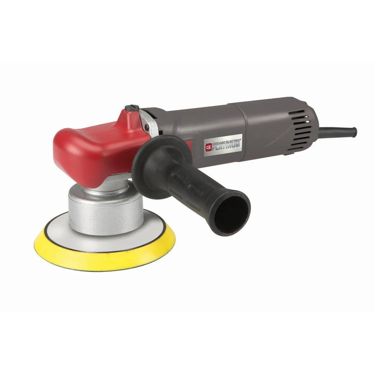

Their 6" dual action polisher was recommended to me by a professional detailer as a Porter Cable alternative. It has been awesome. Much higher quality than what I'm used to getting from HF historically.

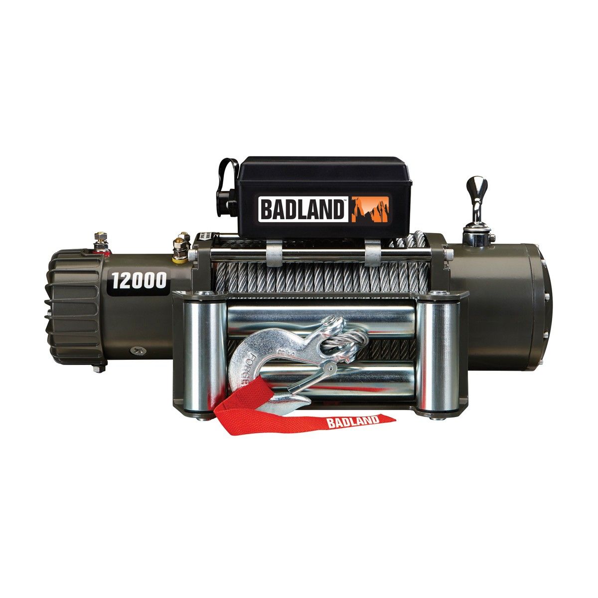

12k winch. Top rated, and if I recall on Woody's rig. never let anyone in our club down, (waterproofing is recommended) $330 delivered to my house.

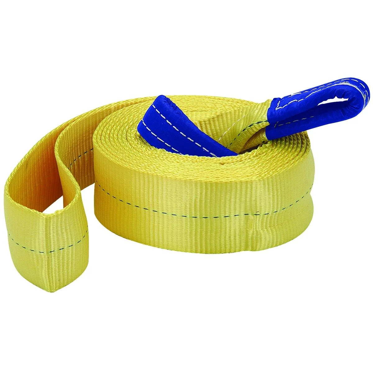

Tree strap.. works great. pulled my 80 (and several others) up a muddy trail in Texas in the middle of the night. $12. DONE

this is a great review, been eyeing these lately and wondering if they are a waste of time or not. Great to know they are working well for you and the rest of your club!
