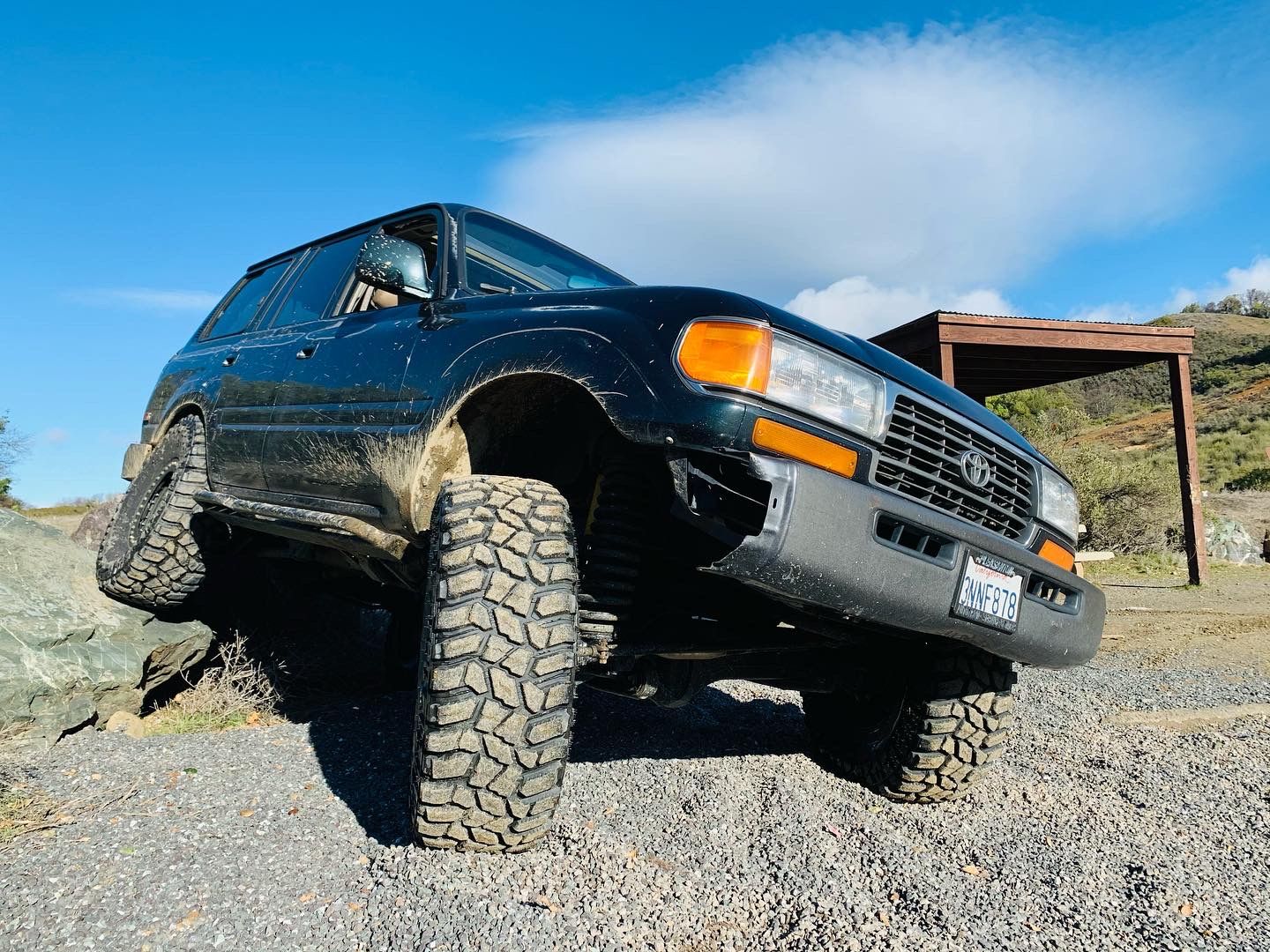

So I won a set of 5 BFGOODRICH tires at Panamint Valley Days 2020 raffle up to 37s, being that I already have 38s I asked if I could upgrade to 39s. They approved my request minus the 5th tire. New tires showed up yesterday so I had to make room in the garage until these 38s wear down.😁
@mazder those 33s o_O look to have a much skinnier tread width than the 38s. They might fit better.

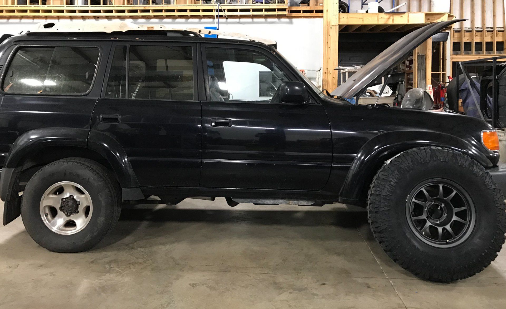

Those look like stock steelies with DIY locks on there... are they 8" wide now?
I didn’t measure them but something like that. They seem to be working out so far without spacers.

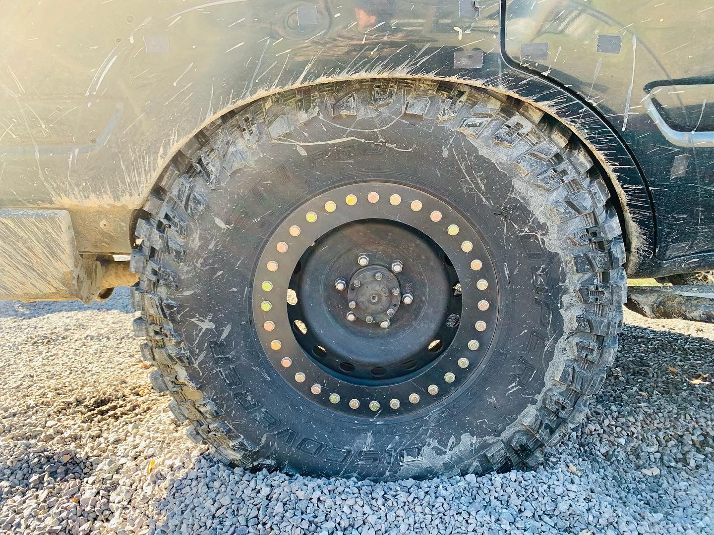

Hose look pretty cool and are definitely different. What is the width and back spacing of the wheels?
I didn't measure them but the internet says they're 7.5" wide (stock) with 4.5" backspace before welding on the TMI Beadlocks.
