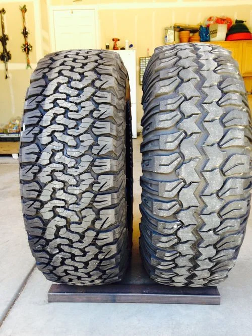

Lil' bit smaller 37's these days. Although the stated revolutions per mile are virtually identical so figure that one out.
